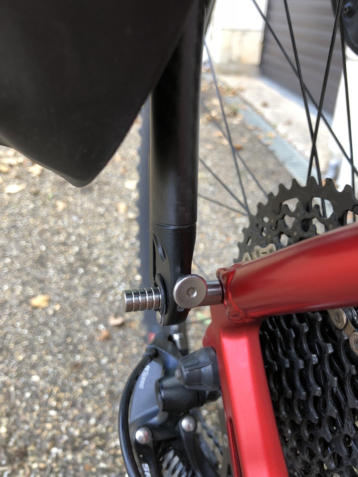

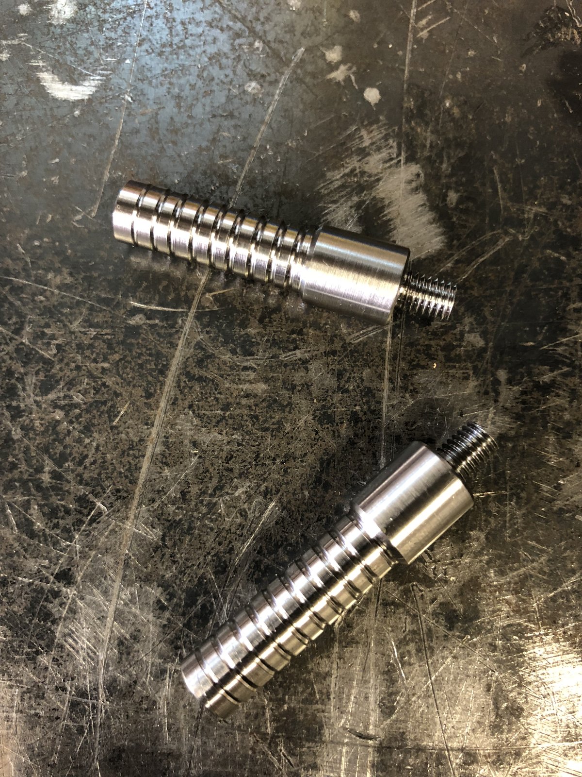

You will be pleased to know that I have survived...... Made the parts on my Myford using
Carbide tipped tools, the same ones I cut aluminium with and my usual little spray bottle of coolant. Nothing caught fire and the finish is superb. Surprisingly easy to work actually.
