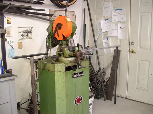

chopsaw-fast and accurate and easy transported
