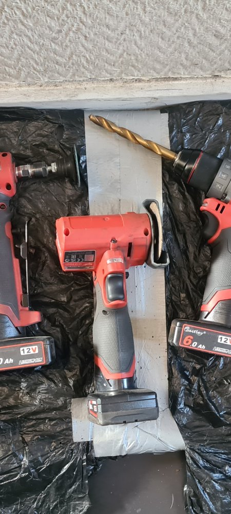

Took wise I'll have a good think as I'm probably in the market for just the Angle Grinder and Power file at the moment. I keep seeing Die Grinders too but can't find a good video on them? would this be more useful than a decent angle grinder regarding Car body work?

For auto body repairs most of the corded tools you may acquire are not going to be amp sucking beasts.

Die Grinder or Grinder?---both, consider a 3 inch grinder.
