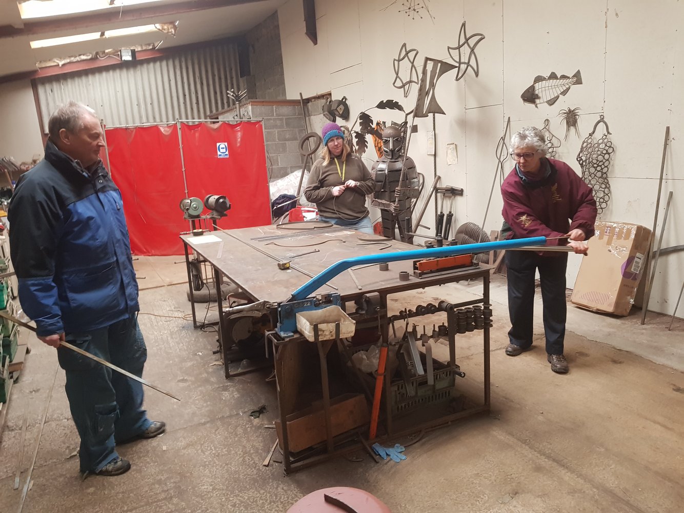

mount one handle in the vice and extend the movable one to give more leverage make a stop gauge so you dont have to keep measuring every cut just push the material up to it and chop . easier still get the missus to feed the metal while you cut![]()
I have the same one, badged as Vevor, I've not had it long but impressed up to now, 3mm steel sheet is easy, I have made some improvements though. First I couldn't get my weight over it to start the cut, so I notched a vee out of the handle and welded it back together, so instead of pointing backwards away from you when staring the cut, it points forwards towards you. It's now much easier to start the cut and finishes the cut about waist height.Got one of these in the end. With 20% saving code on Ebay and £25 'winnings' from Paypal it worked out a good price I thought.

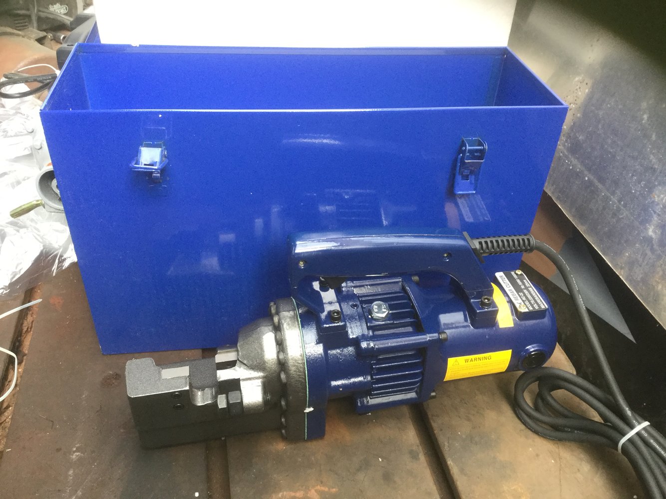

This is the one https://www.sealey.co.uk/product/5637173338/metal-cutting-shears-6mm-capacity-o12mm-roundDo you have a link to it? Might get one.

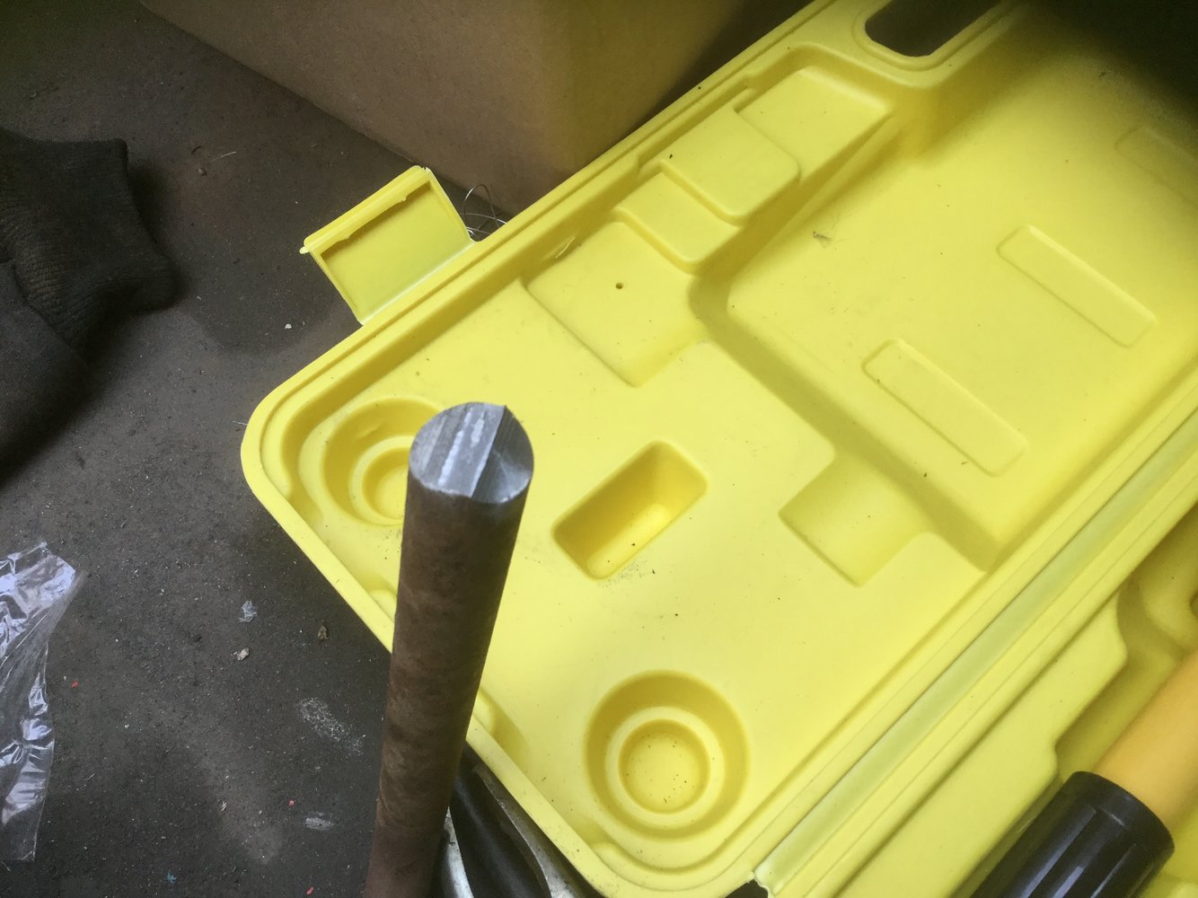

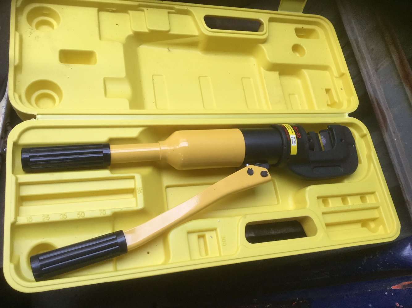

Interestingly that's exactly the same tool as my hydraulic crimps. Even has the holes in the case for the dies!I have a hydraulic hand set and an electric one , they will both crop up to 32mm . Not expensive either.
Bob
View attachment 320757View attachment 320758
mine also, well all you need to do is make a set of dies to cut bar!Interestingly that's exactly the same tool as my hydraulic crimps. Even has the holes in the case for the dies!
