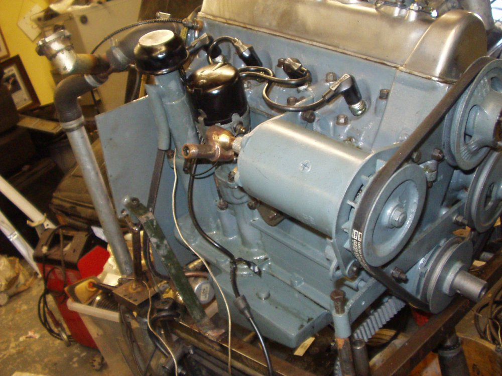

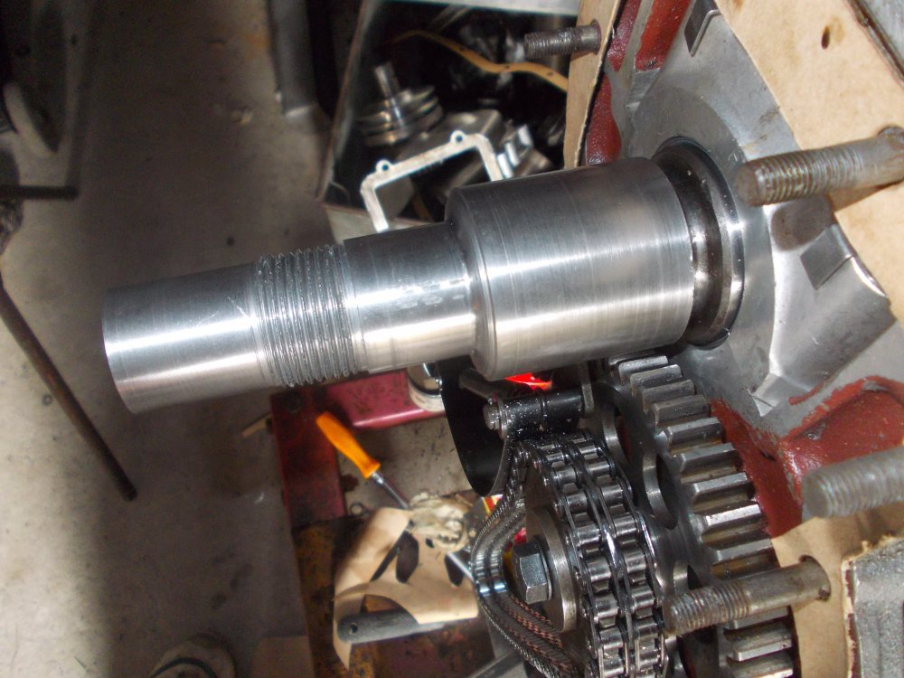

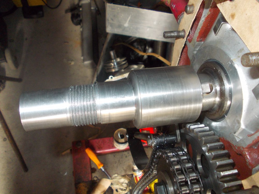

Thanks pete the crank end is 50mm hole and key way. The front drive for the prop is 19mm so correct me if i am wrong but the broach will not pass all the way through so i asume you would push the broach until it bottoms out and re shim until it has cut to the desired depth.Broaching in a lathe isn't that slow a process. If you take off just a couple of thou each pass that's only 63 passes to cut 1/8"
ive done a couple with a chissel and verry accurate. no good if your in a hurry but good engineering practice the old wayyou can cut a keyway with a chisel, I don't recommend you do though if you can get it on a machine
That will save a load of time i can see me making a couple of these as the engines were pinched out of boats and used in sports cars and the maranising parts were scrapped.Ive done a couple on the lathe in the past but both times, i spun up a top hat plug, and pre drilled the route of the keyway, so the broaching on the lathe only really squared off a half round groove.

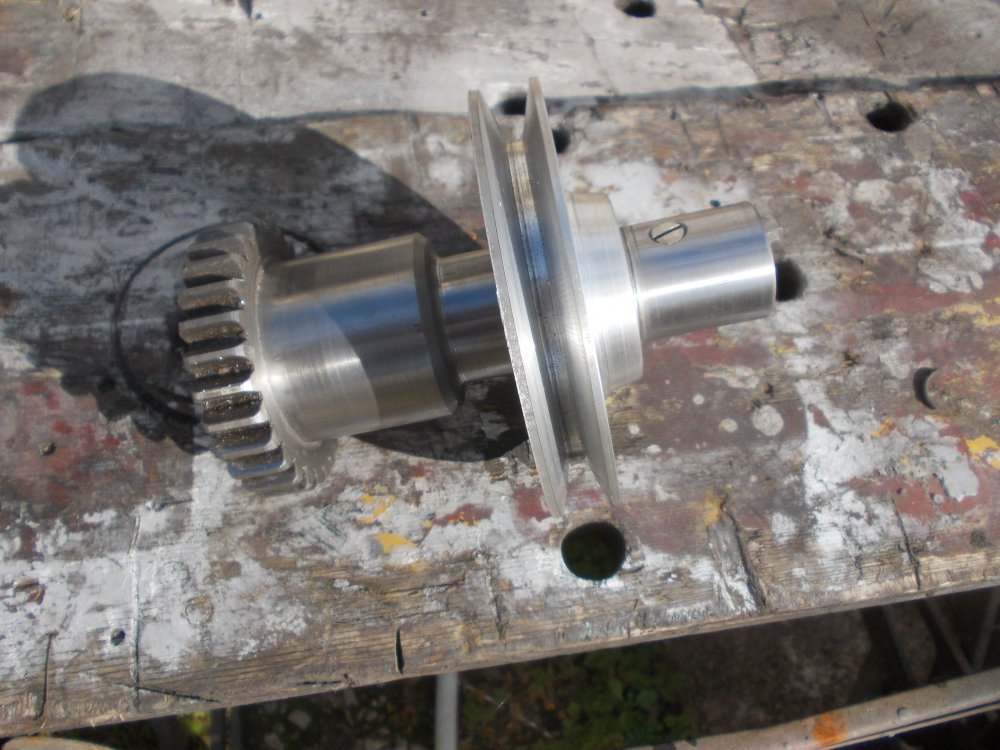

thanks for the tipOne can often be better off with drilling and reaming for a hardened tapered pin
Consider this if you are short of the correct gear for keyways
The reamer and pin come as a kit
