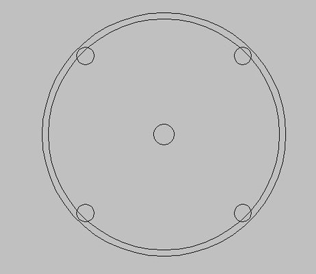

Accuracy is not important to be honest its going to be covered with a welded piece of pipe anyway.i have a hardened and tempered silver steel pilot i made in one of mine and just drill `with an ordinary hss drill
.1st if i have a few to doits more accurate and no run off . it saves using expensive pilots for drilling as well
makers mention of drilling a few holes on the kerf line to clear the swarf,
for better swarf clearance on the cutting edge of the teethIf I knew what that meant it might be useful. lol Whats a kerf line.
Suggestions for decent cutting compound or oil??I cut 22 x 73mm holes in 5mm mild steel plate using a Starett hole saw when building my boiler heat exchanger, like Brightspark said use a cutting compound and take it slow.
But it's good practice for when accuracy is importantAccuracy is not important to be honest its going to be covered with a welded piece of pipe anyway.
A Kerf is the thickness of a saw cut.If I knew what that meant it might be useful. lol Whats a kerf line.

Ah right so the swarf drops out through the hole i drill...i see..But it's good practice for when accuracy is important.

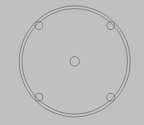

Ah I would have straddled the cut lineLike this
That would leave small semicircles on the finished holeAh I would have straddled the cut lineThanks for the pic.
.Yeah but I am welding pipeover the hole and i have a decent margin for errorThat would leave small semicircles on the finished hole.
