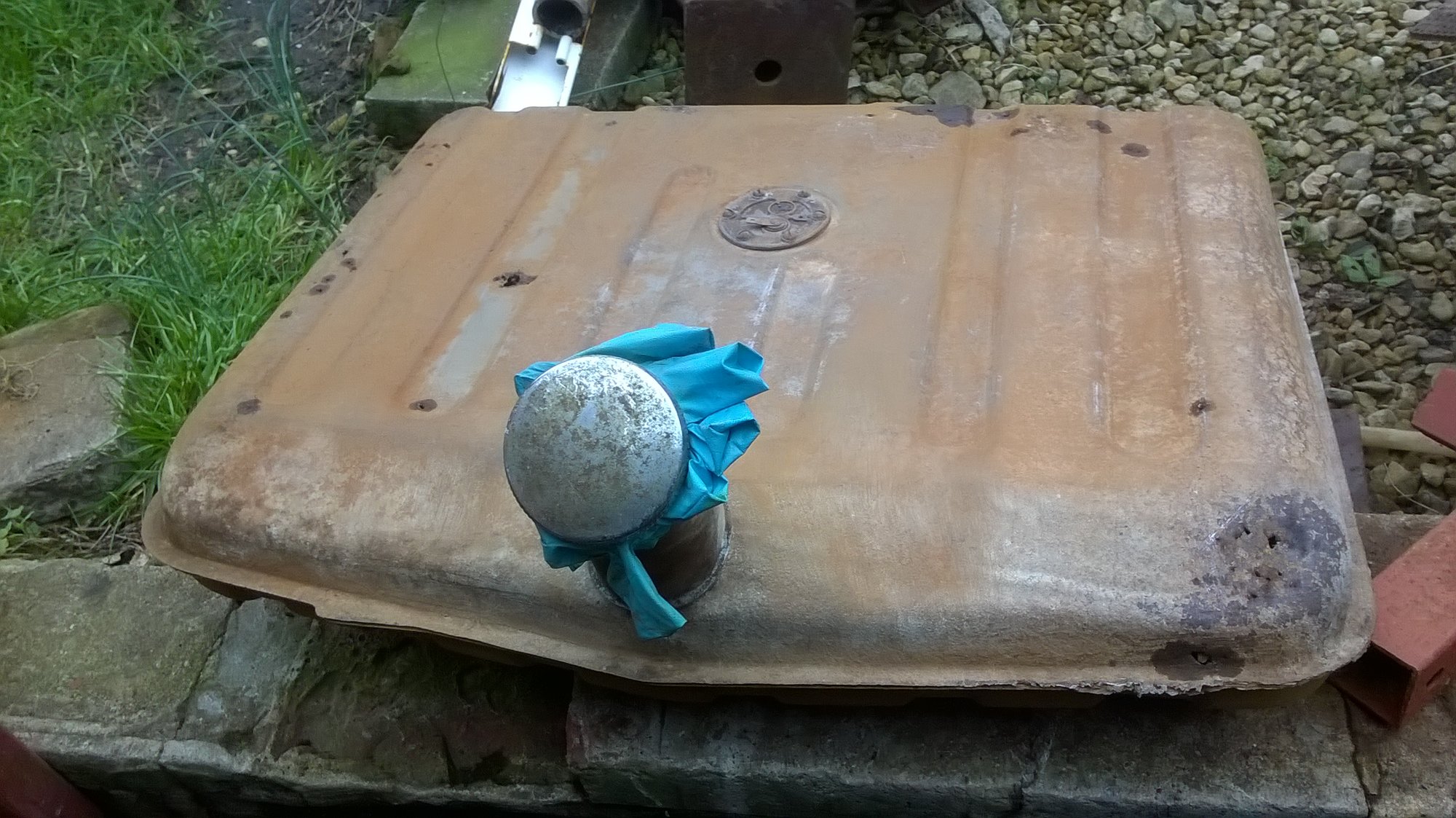

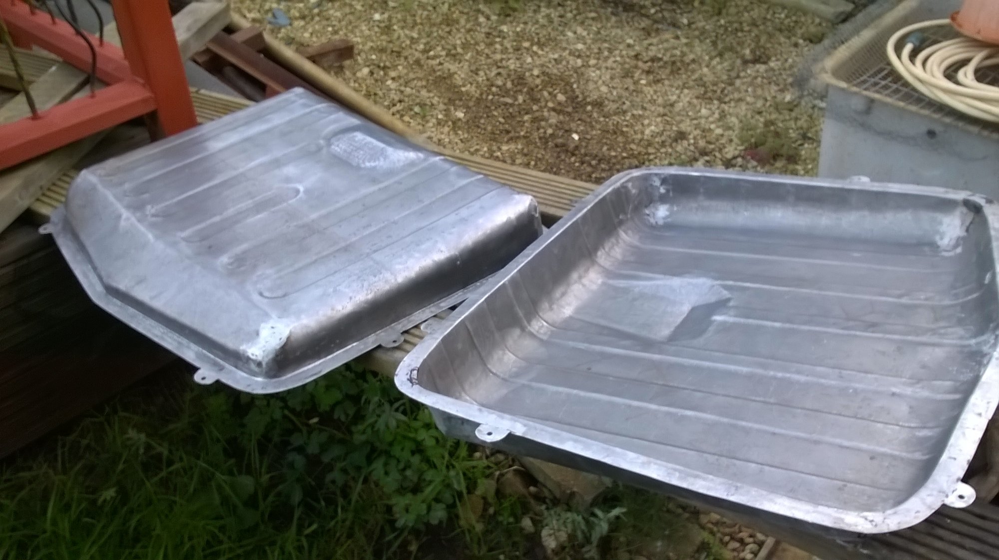

    Think you will find that steel fuel tanks use to be made of Terne steel. This was a lead coated steel and the lead would protect the steel from the rusting. BUT this steel is no longer available :(. I read up on this as the fuel tank for my Capri is like a cullender and having got about 90% into making a new one (see pics) from mild steel I realized it would rust unless coated :doh:. Not sure if HOT zinc dipping might distort it (and would make it difficult to finish weld) so have put that version on a back burner :o well to one side any way :whistle: and now looking to make up in ally. :(

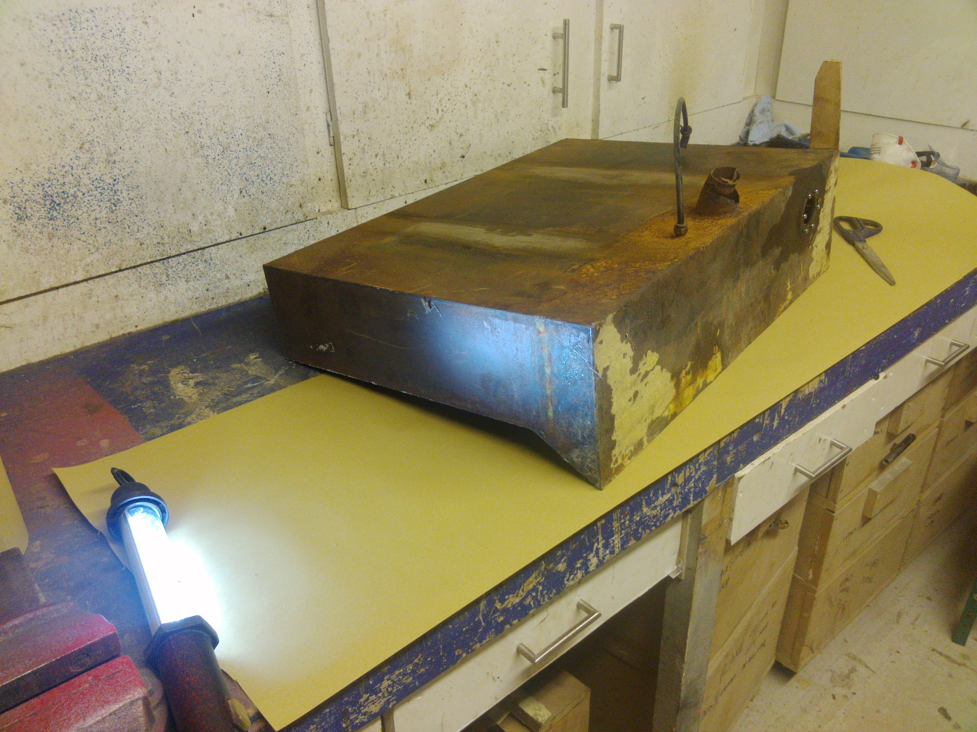

    The tank is unique to the Marcos,
    the different steel may have more to do with the rust than laying up the car over winter then !
    Thinking about it many classic cars are laid up over winter, do they suffer the same ? IMG_20171122_101658.jpg
    The bit sticking up on the corner is not part of the tank
    The triangular bit at the bottom of the tank is where most of the rust is, have thought about using vinegar, just pour some in and leave it for a while, also seen you tube video where hydrochloric acid is used, very impressed.
    Still need to weld a new filler pipe on so cleaning is still on the cards
    Or £525 for alloy one !
    Whatever happens I won't be taking any risks :thumbup:

    With a basic shape like that I would look to making your own up in ally

    I might end up having one made out of either alloy or even stainless, my only experience of welding alloy was at night school 30 years ago, never done stainless, there is a fabrication place quite close to where I live so might give them a call, I'm thinking of the easiest way
    I'll still be going ahead with the cleaning and fixing the one I've got though, if it doesn't work out then I'll consider the options, nothing to lose eh ?
