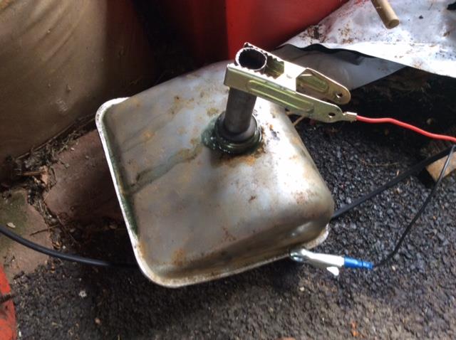

. I read up on this as the fuel tank for my Capri is like a cullender and having got about 90% into making a new one (see pics) from mild steel I realized it would rust unless coated
. Not sure if HOT zinc dipping might distort it (and would make it difficult to finish weld) so have put that version on a back burner
well to one side any way
and now looking to make up in ally.

The triangular bit at the bottom of the tank is where most of the rust is, have thought about using vinegar, just pour some in and leave it for a while, also seen you tube video where hydrochloric acid is used, very impressed.
Still need to weld a new filler pipe on so cleaning is still on the cards

I did think about that once but the tank still needs some welding doing, the tubular filling pipe has rusted and needs replacing.
I got the price wrong for a new tank they're actually £525 !
Apparently the reason why they rust is because lead free fuel doesn't ' coat ' the inside of the tank which allows rust to form, this is because the cars aren't used enough and are sometimes laid up over winter, or so I hear.
I think I'll go the way of washing it out, good rinsing, fill with water and then cut with air powered tools.
