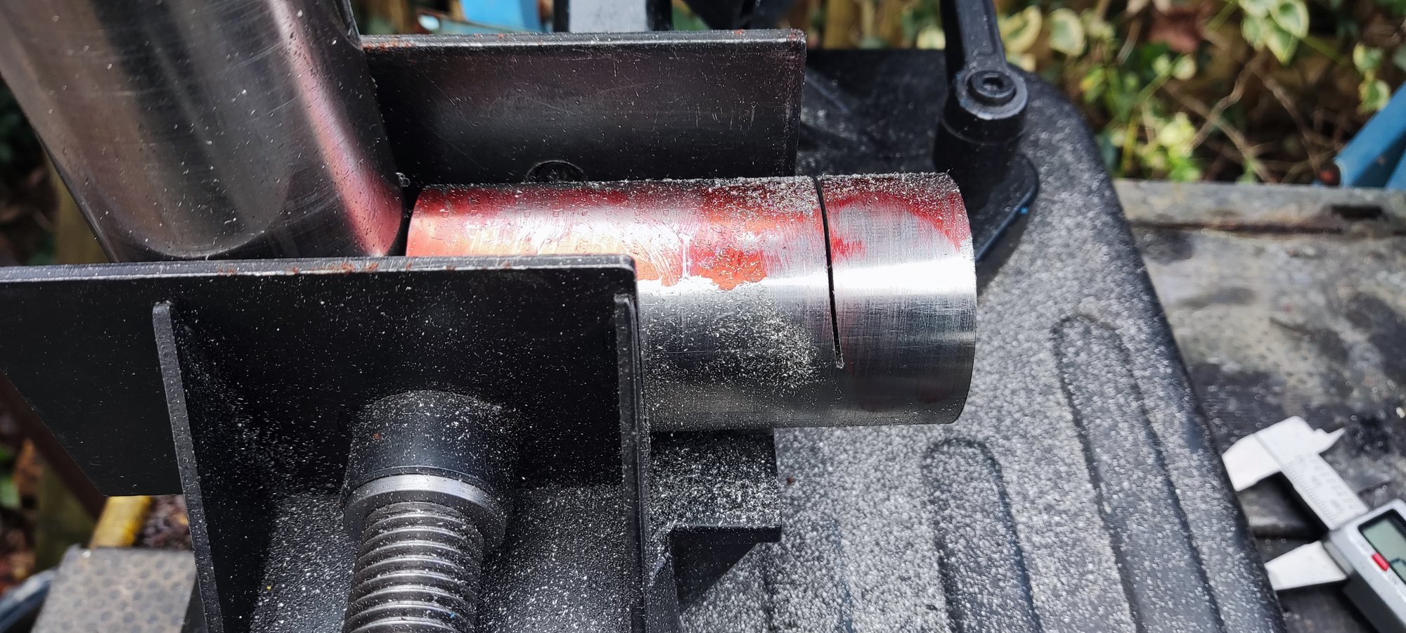

A mix of things, I dont do much sheet and where possible I now prefer the mini 3" 12v grinder anyway. So for me, the 4.5" grinder comes out for chopping 30-70mm round bar. The recent lumps were 50mm stainless when the bandsaw went off..You don't say what you intend cutting but if it is thin guage you need to secure it well as if it vibrates while cutting it will turn discs to dust in no time.
) and had 2 shatter. reminded me of clarke 3mm cutting discs from years back before 1mm were availableLooks like the stainless has over heated your blade.A mix of things, I dont do much sheet and where possible I now prefer the mini 3" 12v grinder anyway. So for me, the 4.5" grinder comes out for chopping 30-70mm round bar. The recent lumps were 50mm stainless when the bandsaw went off..
I have some 2.5" chromed hydraulic bar, I want to chop a lump off next week. I would bore it out first but its far too long to go in the lathe.
