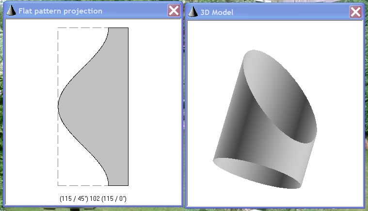

Its really not that difficult to manually draw the development of a 45deg cut on pipe, I'm sure I've covered it before, however you can use a program called cone to draw a pipe wrap just enter the Dia 1 and dia 2 into the boxes as shown and set angle 1 at 45deg and it will draw it for you. you can then directly print it out or import it into a cad program,
