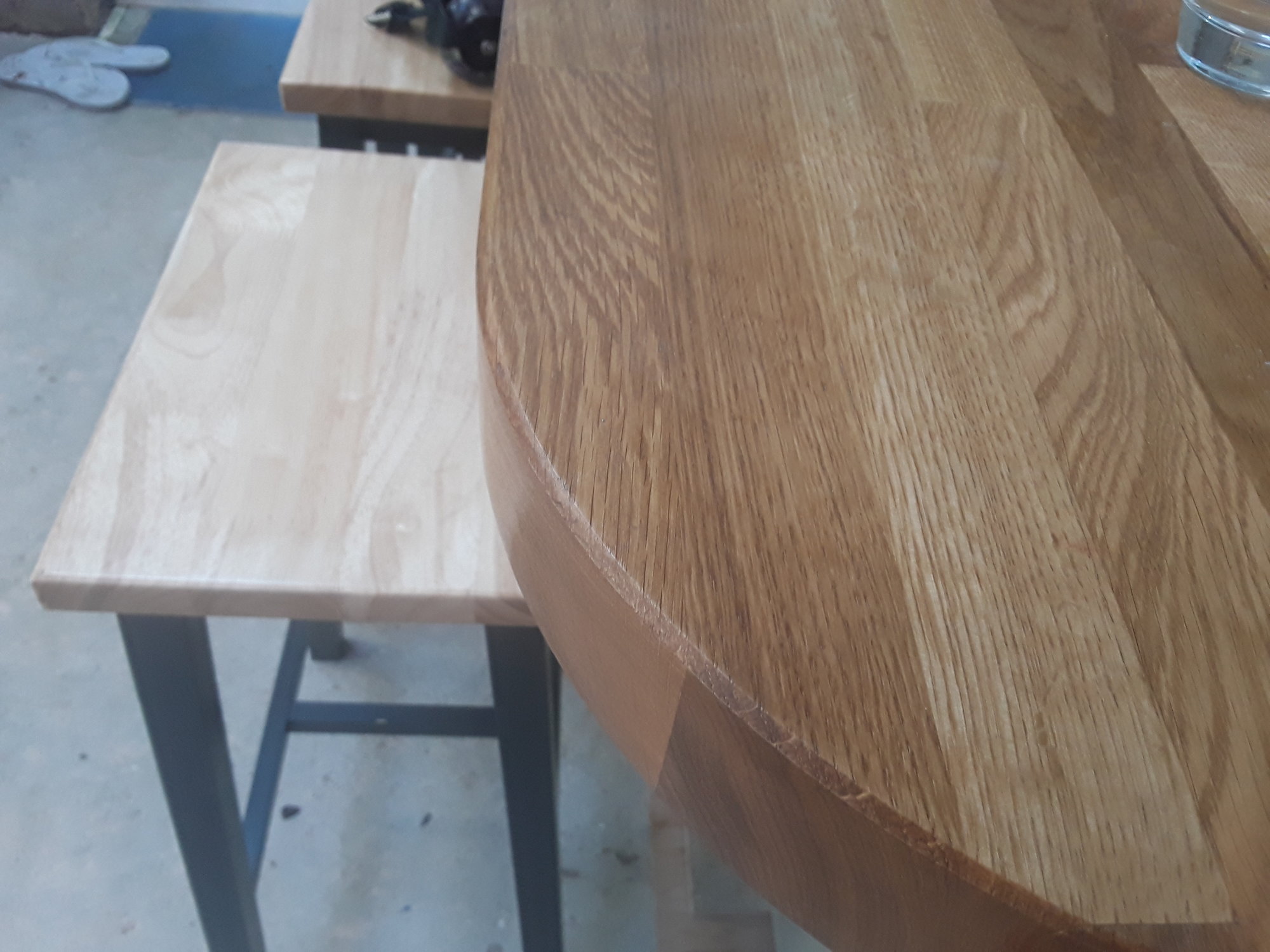

18mm straight fluteOne for the routerists!

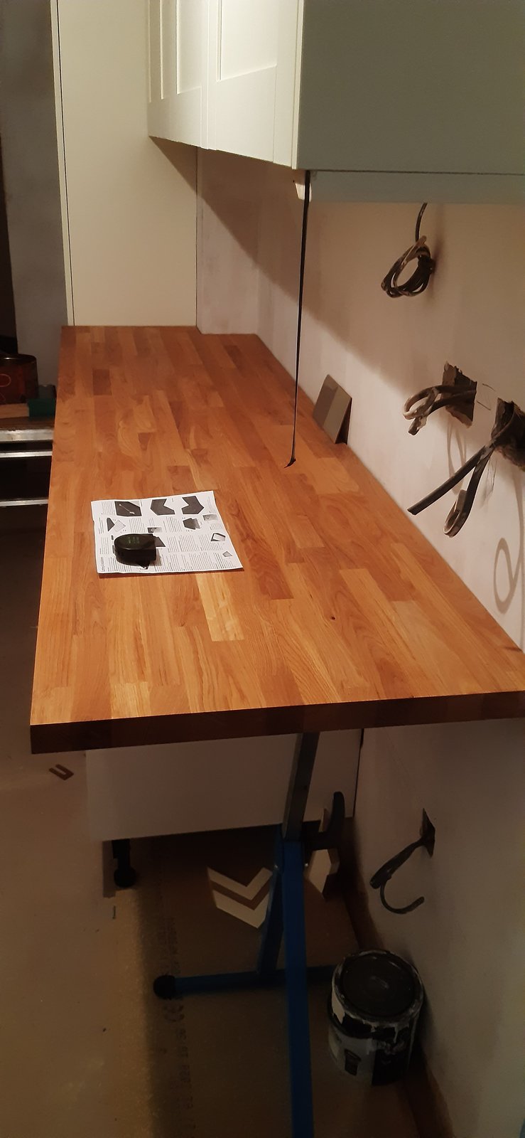

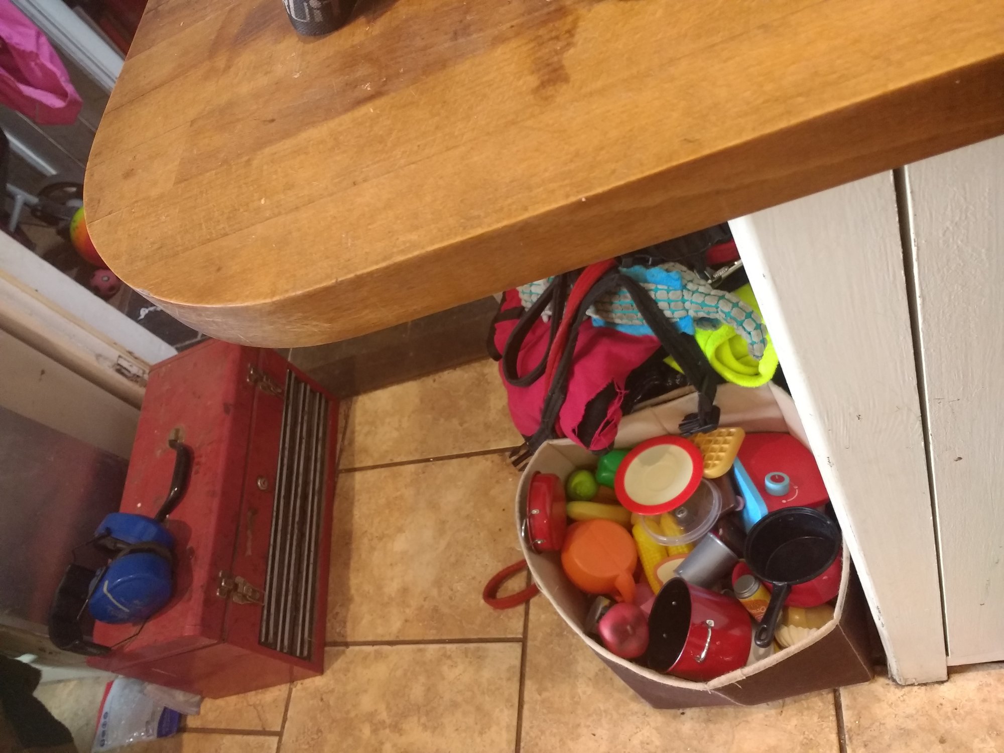

How can I replicate this edge?

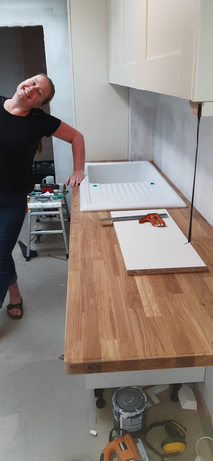

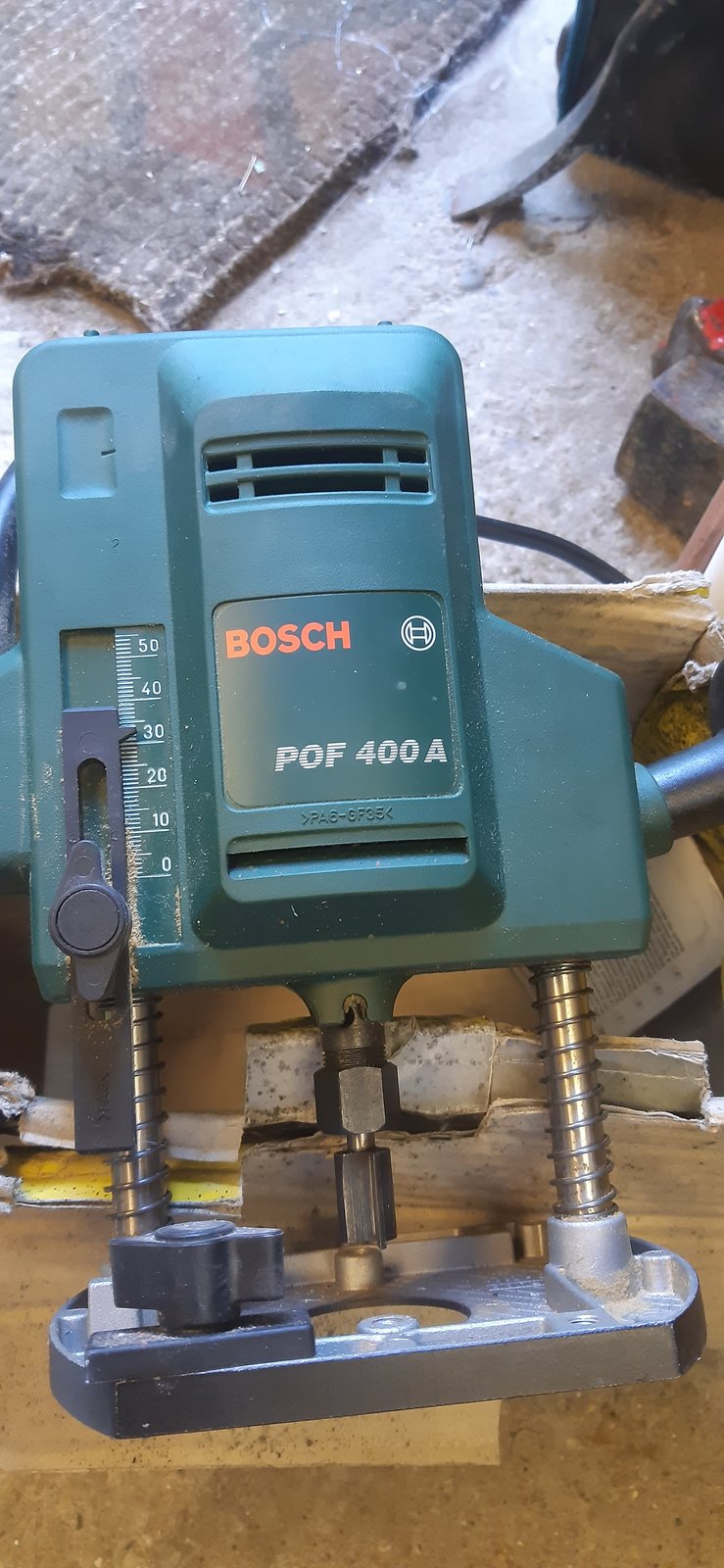

This is the kitchen worktop and I'd like to have the same on the utility one but although I have a router I cant even remember when I last used it!

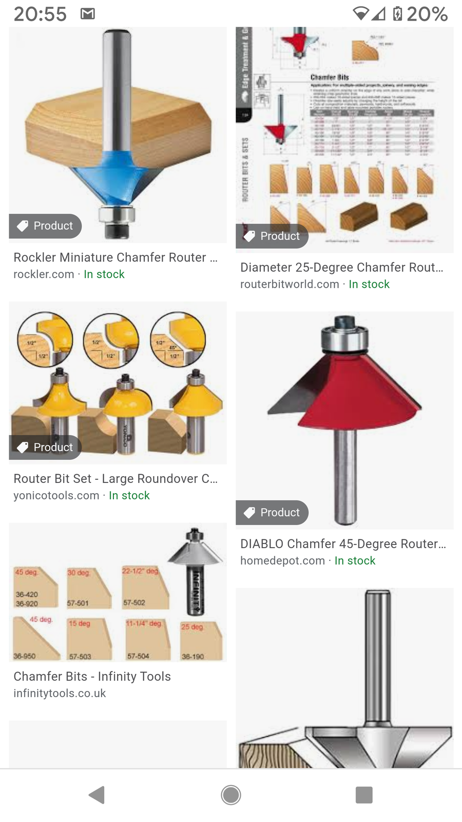

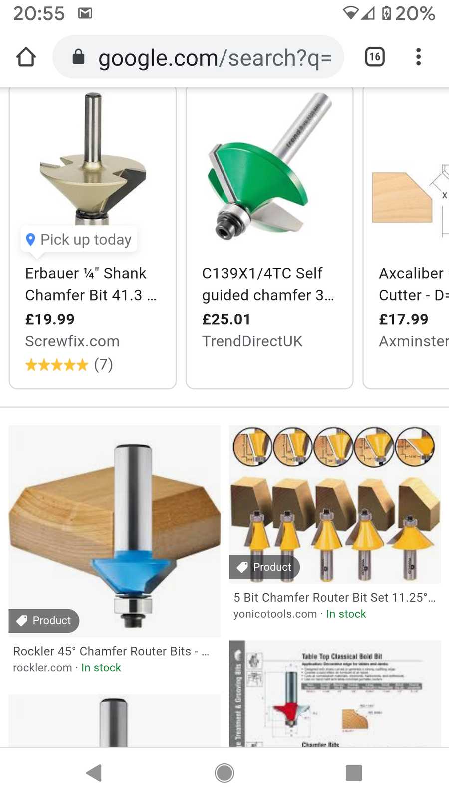

Is there a certain type of router bit I can use?
Find a bearing cutter with the right profile.Ah I meant the chamfer on the edge not the rounded corner. That's me not explaining it properly!
That's the breakfast bar in the picture but the other one im working on is just a normal worktop .
And always test it's setup on a scrapFind a bearing cutter with the right profile.
