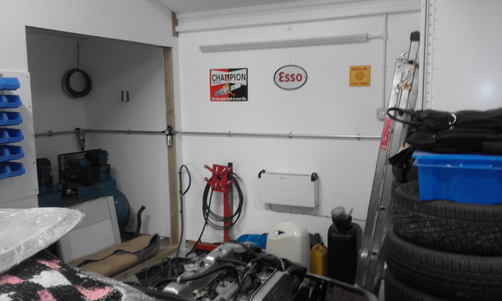

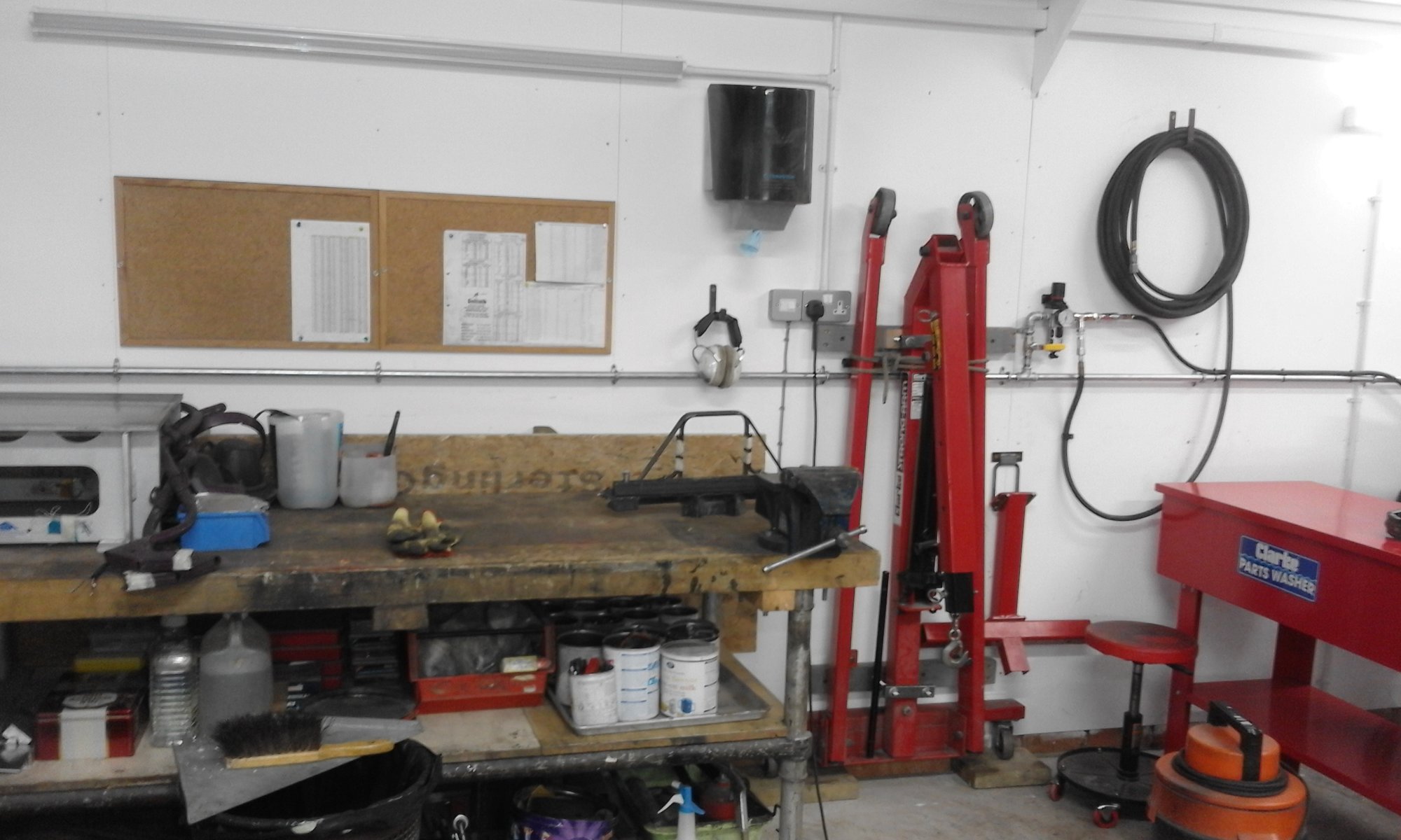

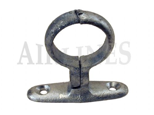

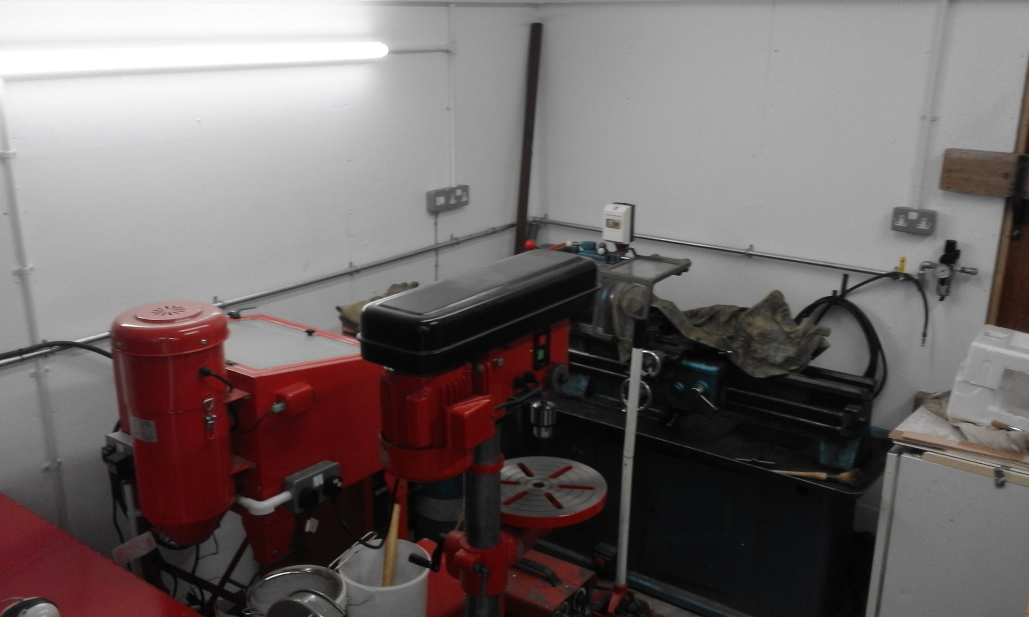

Over-bracketing will not hurt, just potentially cost you money. 1200 spacing is probably OK but if it turns out not to be, how much will the postage be for additional brackets? Anywhere you will be pulling on it (outlets), an additional bracket will not go amiss.
The brackets set the stand off from the wall so when going between two fixed walls, you bracket dummy pieces of pipe with elbows on the two return elevations and then measure your actual between face length. What I am saying, I guess, is not to work solely off drawing dimensions but measure the last piece before you cut it. It is better to cut it longer as you can trim 5mm off with a grinder and then re-engage the dies on the thread and lengthen the thread than it is to be short as then you have to throw the piece away or use it elsewhere.
You might know this one way or the other, but I think you need a flexible connection between compressor and line so vibration is not transferred and there is no stress leading to pipe failure.
You can check the length of the pipe when it comes (I think it is 3.6m) so you could slightly revise your dimensions on the long wall to suit full lengths as that saves on threading.
The pipe lengths are 3.25m unfortunately so I know I have a couple of straight couplings to include.
I already have the brackets I ordered plenty JIC! Likewise with elbows and tees, as you say for a couple of quid...
I know I need a flexi, not sure yet exactly how I'll execute that but will ensure I have one.
Fully understand what you are saying regarding returns
Thanks!
