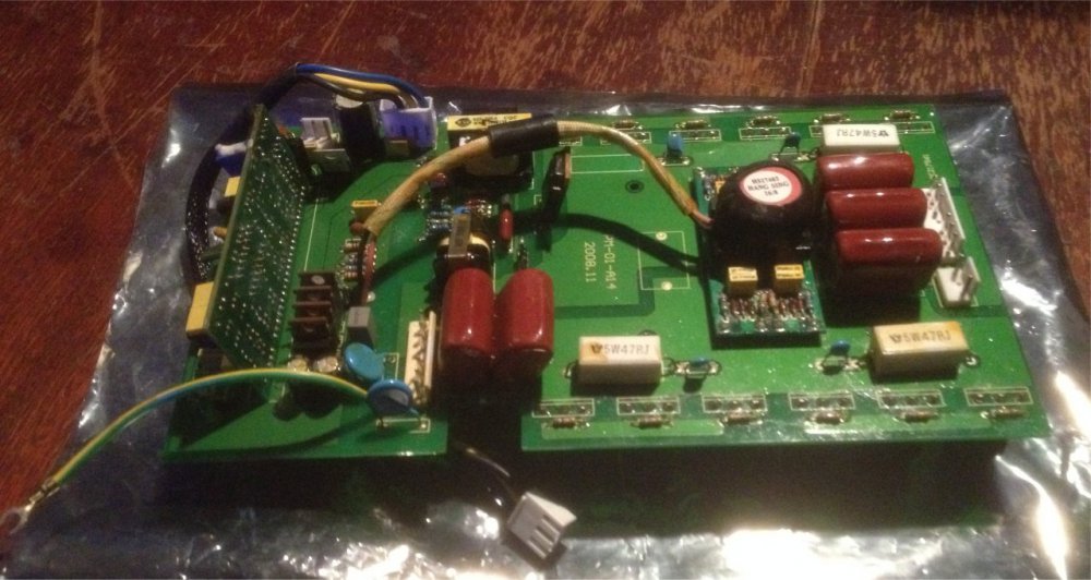

Thanks Gaz, It's a different board mine has the numbers HB213457 and SW603635 , Thanks for that link though made good reading. ch ch cheeeeersi dont know if this will come in handy but there is a cut 40 pdf circuit diagram might help with some info
http://www.mig-welding.co.uk/forum/threads/cut-40-repair-info.56439/page-3

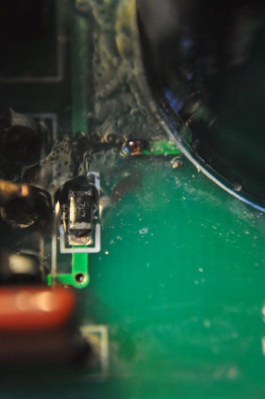

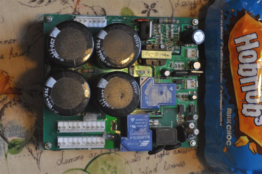

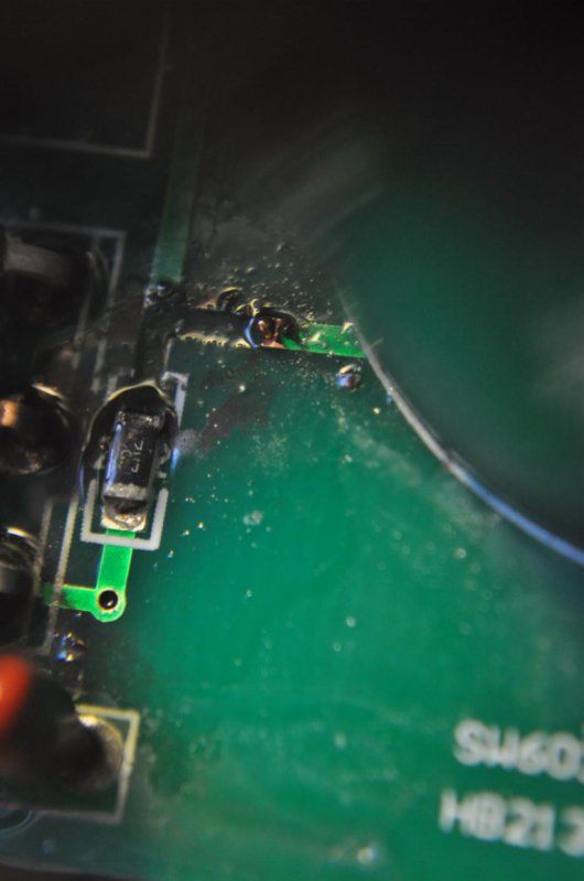

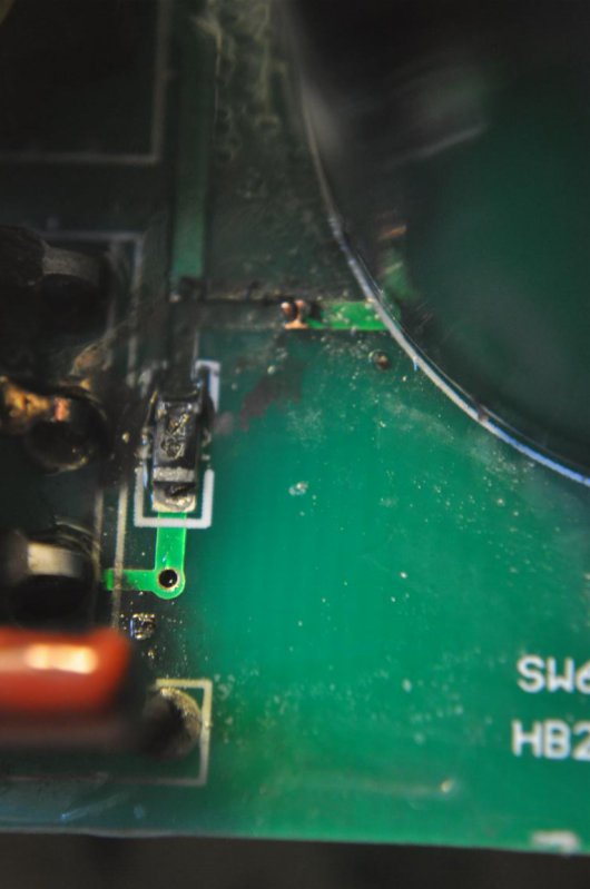

did you work out what component it was that fried in pic 3 and 4

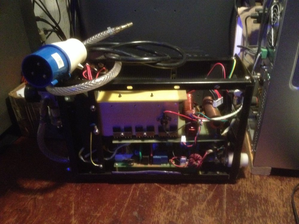

i have a cut50 here with cover off.
top board is out due to cement resistors.
what board is your pictures of.
as Michael Barrymore would say.......... top,middle or bottom
top board
F a n t a s t i c o!!!! Brill, yeeeeee haaaaaaaa. Thanks Gaz. Ill get one on order. yipppeeeeeeeeeeeeeeeeeeeeeeeeeeeeeeeeeeeeeeeeeeeeeeeeeee.its a 2.2 ohm resister
2R2, 2.2Ω
Hmmmm... where is that on the board - I can't identify what's to the left of it but, if it's a cap, it looks like it's burst.Hi Stuart,
It's the bottom board. I have cleaned it up today with some 50 year old malt as mentioned earlier (smiley face) I don't know what the component is yet I can see 2R2 printed on the component and there is something written underneath, ill se solder it tonight and see what it says. Here is a pic of the board and the component component. Thanks very much for the help. View attachment 75698 View attachment 75699 View attachment 75700 View attachment 75701
