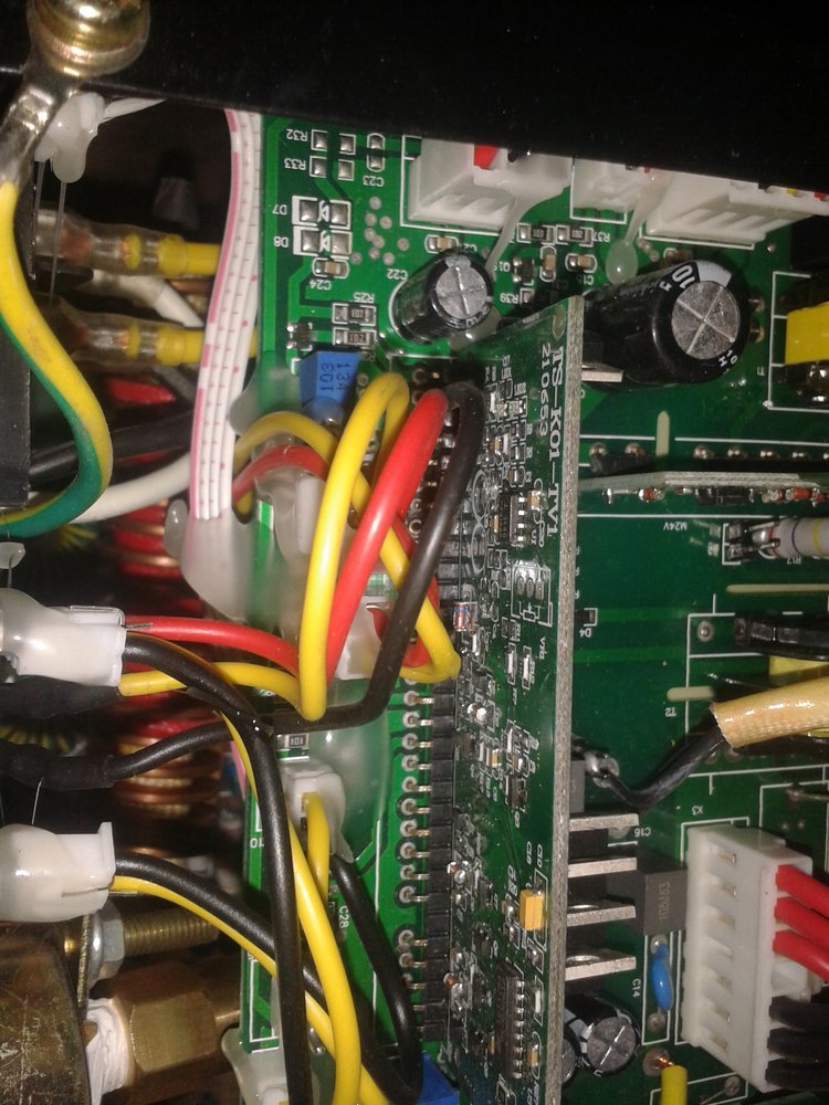

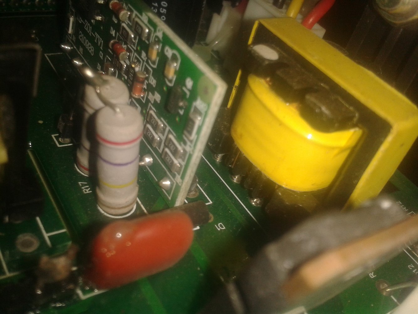

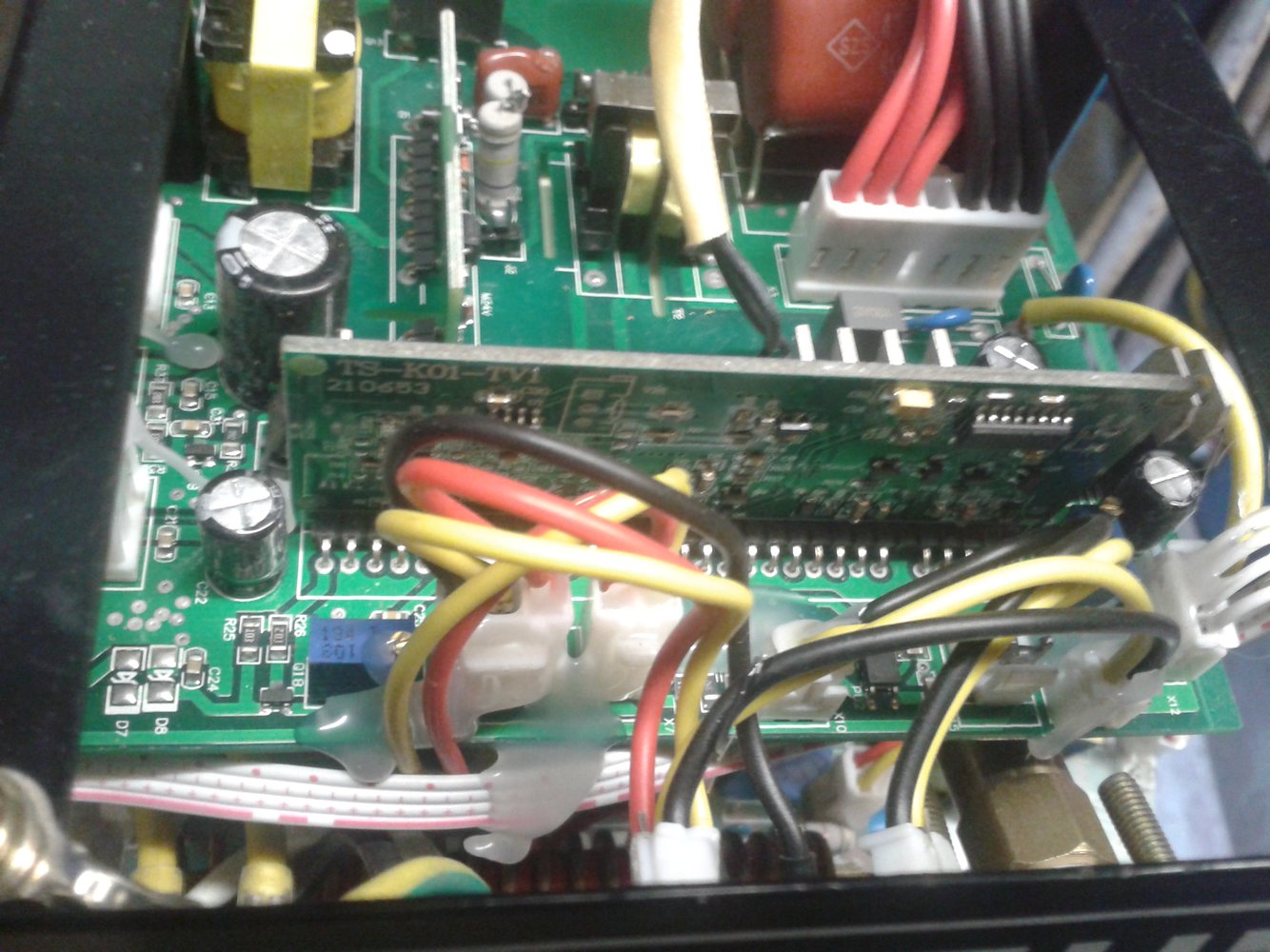

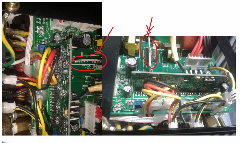

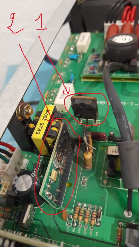

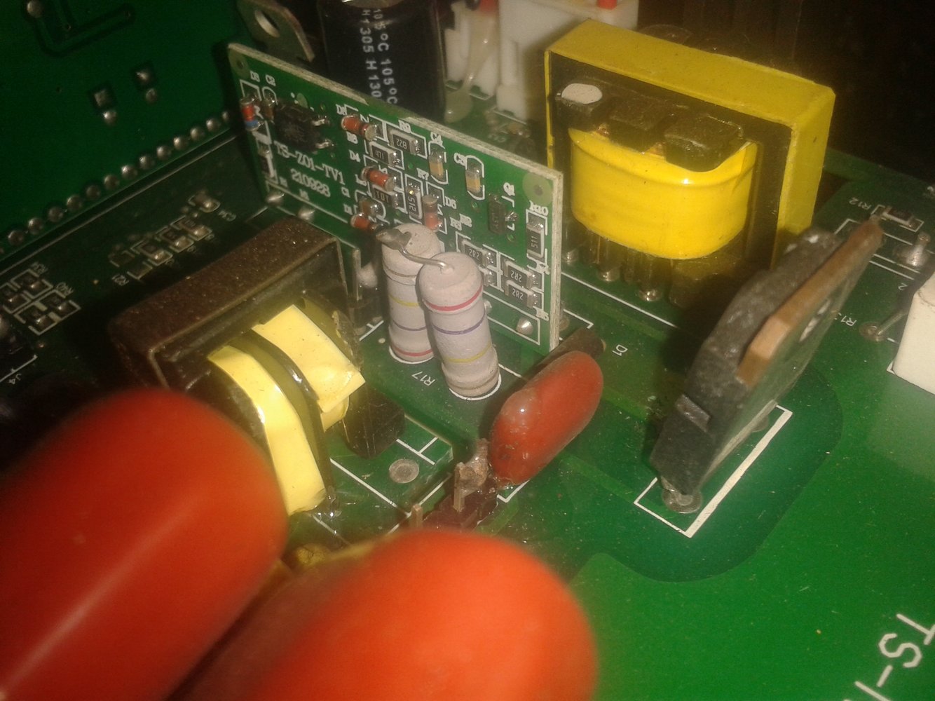

I've made a board aping the CUT40 relay operation switch, so now the relay clicks in after startup and the machine runs without the thermistor switching off. However, I have no cutting power.
The spark gap sparks as long as the torch button is pressed, and air comes out at the recommended pressure as the valve solenoid actuates. There is an arc from the torch to the workpiece but no great flames, and no cutting, just some slight pitting of the material. I have a selection of new consumables and it doesn't work with any combination of them.
I've never used a plasma cutter before, so I'm not sure what I should be expecting. I wonder if there is an insufficient DC potential to create the plasma, but I have 50V between the torch and clamp. The videos certainly suggest an easy cutting action but I'm not sure what to try next.
It's very obvious when it's working so there's clearly something still off. Are you able to tell what impact, if any, turning the amps knob up makes? Perhaps the logic around that area is faulty.
