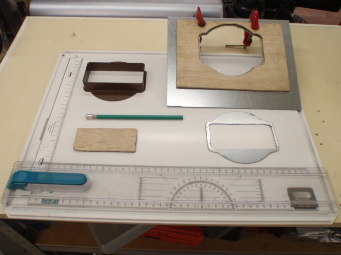

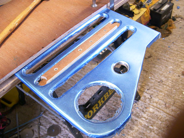

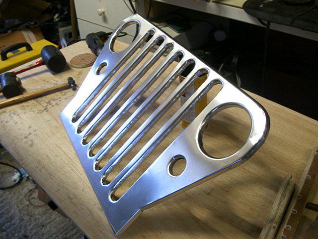

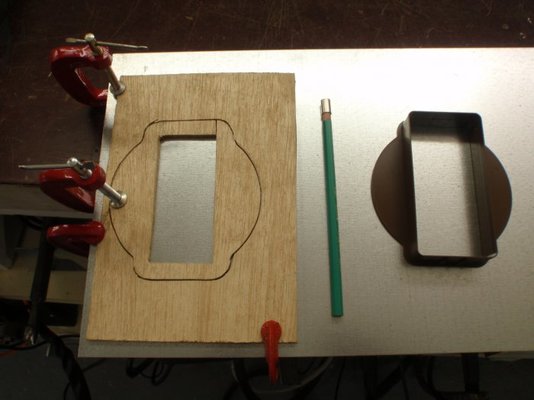

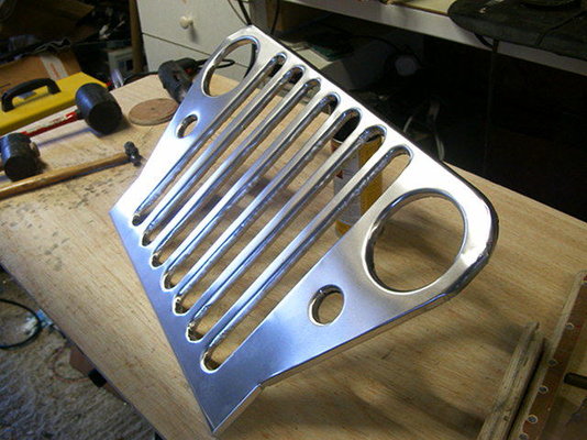

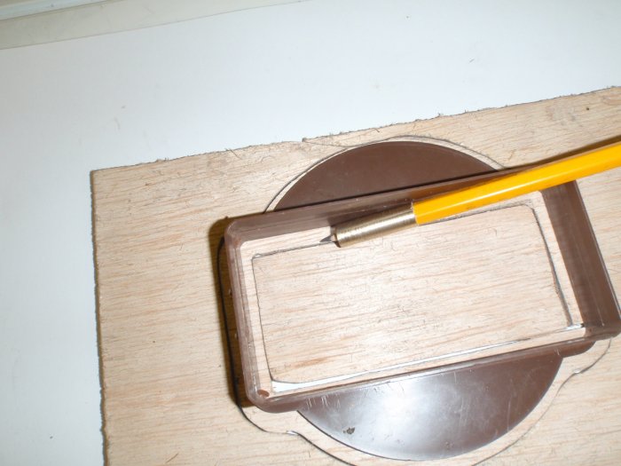

The aluminium will be swaged around a former that is 12mm thick plywood, I had thought that I could use the ply as a template on top of the aluminium.... I discovered that the template does something to the airflow of the gun and disrupts the plasma, causing lots of spluttering and gaps in the cut.
The laminate is about 6mm thick, I think the problem with using the thick template for me was that the long slots are very narrow and my guess is that the shield/cooling air gets turned back into the gun and affects the plasma.Are you saying that the laminate causes less problems? How thick is it?

All the areas on the wooden former where I wanted radii were routed to shape.How did you shape the edges of the holes?
