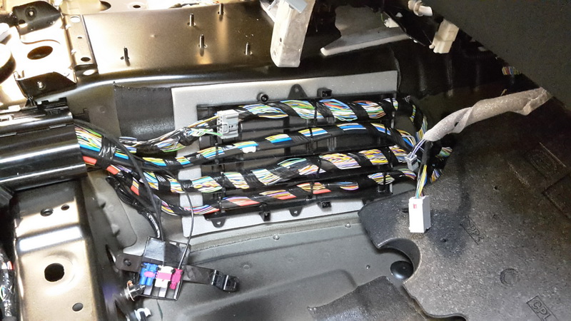

Ah, so about the same volume as a classic Rangey which had 5 Lucas wires
And that's why bus based systems like Canbus were introduced ! There comes a point where using a bus is simpler than traditional wiring.
I would imagine it has canbus as well on a 5 year old car?And that's why bus based systems like Canbus were introduced ! There comes a point where using a bus is simpler than traditional wiring.
Yeeees... and then they come up with the sort of silliness where the central locking modules have to be 'coded' to the body control module - and still needs 5 wires between the two (Landrover, I'm pointing at you).And that's why bus based systems like Canbus were introduced ! There comes a point where using a bus is simpler than traditional wiring.
I see. Maybe if the bus system was more standardised then it would be easier to deal with.Yeeees... and then they come up with the sort of silliness where the central locking modules have to be 'coded' to the body control module - and still needs 5 wires between the two (Landrover, I'm pointing at you).

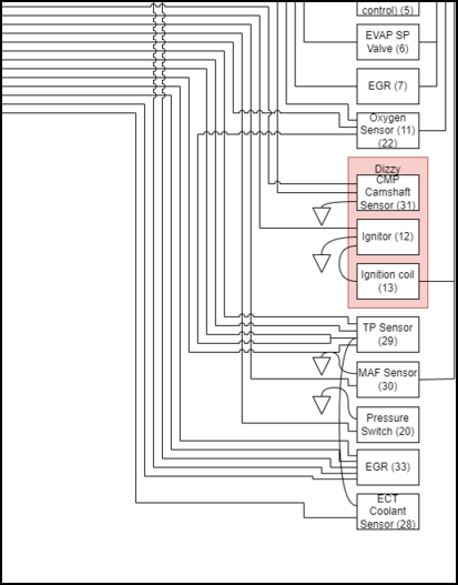

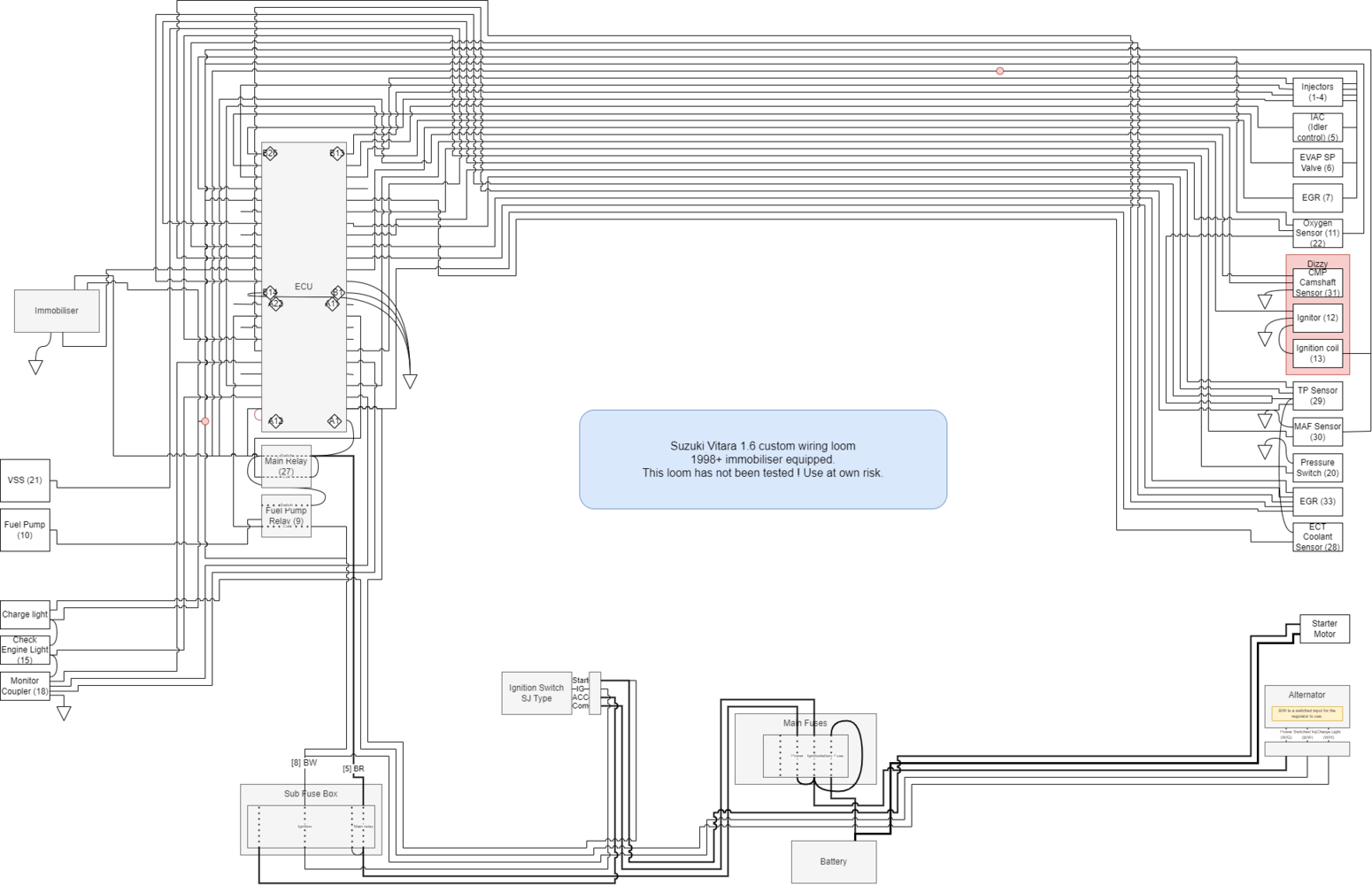

I've drawn up the wiring diagram for the custom loom, it's a serious amount of wiring for a 90's engine with 12 sensors/controllers.

I'd presume earths?
I was thinking that some of them might need to be screened cable as well.If they are then it's highly advisable that each sensor has it's own signal ground back to the ECU if it has the pins to accomodate it (which it should), to avoid the ground offset problems that can come with shared returns.
Certainly signal grounds are typically direct from the ECU, and changing that could lead to problems.If they are then it's highly advisable that each sensor has it's own signal ground back to the ECU if it has the pins to accomodate it (which it should), to avoid the ground offset problems that can come with shared returns.
They might be.I was thinking that some of them might need to be screened cable as well.
Yep the triangles are earths. Diagram was drawn using genetic software so there aren't proper symbols available. Not sure what the best software is for wiring diagrams? I resorted to draw.io (now diagrams.net).

Ah, is that why the ECU has multiple grounds? I was meaning to ask about that. Thanks.If they are then it's highly advisable that each sensor has it's own signal ground back to the ECU if it has the pins to accomodate it (which it should), to avoid the ground offset problems that can come with shared returns.
Yes the Oxygen sensor is screened on the original loom. I'll add that to the diagram.I was thinking that some of them might need to be screened cable as well.
