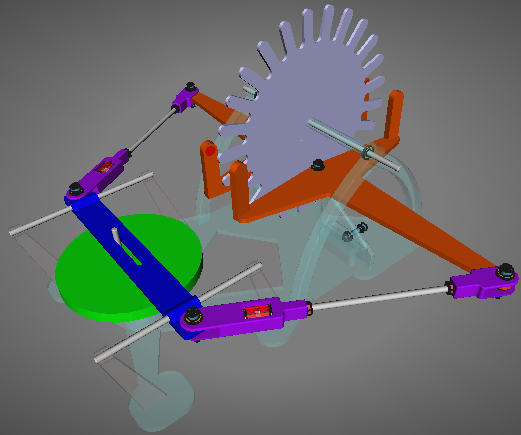

Yeah it looks great. Seriously, that's an attractive looking model.
Still won't work of course.
And the below in bold means ?
"The Scotch yoke is not used in most internal combustion engines because of the rapid wear of the slot in the yoke caused by sliding friction and high contact pressures["
Thanks for the pointer. In this application I think it is actually a reasonable solution; everything is light weight, probably (relatively) slow movement and there are not the high contact pressures you're likely to find in an ICE. They were commonly used in steam engines.And the below in bold means ?

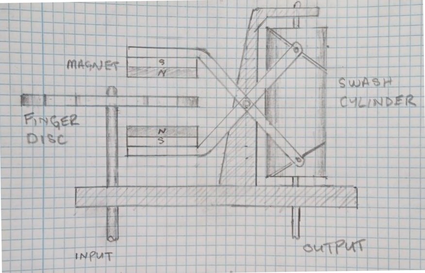

It is a noun measuring the potential capacity of a system to do work. "Work" is the amount of energy expended as an object is moved with an external force. The other half of the pun is since "work" can also refer to a successful outcome (or not as in your case).Well Screwy, old boy, it's not half as frustrating as trying to extract simple answers to simple questions from pedantic physicists. The only 'work' I'm doing is to rotate the rotor so that the magnets switch from attraction to repulsion and vice versa, which they will do depending on whether there is a metal finger between them or not. If you can calculate the work required to do that then such comments would be helpful. The rest of your comments are worthless.I am using "work" in the strict sense where energy is expended when an object is moved over a distance by an external force. I made a pun earlier when I said: "it will energy but it will not work". Energy is not a verb.It is a noun measuring the potential capacity of a system to do work. "Work" is the amount of energy expended as an object is moved with an external force. The other half of the pun is since "work" can also refer to a successful outcome (or not as in your case).
The thrust of the pun being the magnetic force you experience does not do work. The "magical force" you think you can use as free energy is actually just a function of the external force you are applying yourself when you attempt to push opposing fields together or pull attracting fields apart. Exactly the same force you feel when pushing and pulling on a solid stick. Internally, the stick is also held together and resists compression with electrostatic force at the subatomic level.
Another example, a very similar force you can feel, is gravity. Why can't I just use a dirty great big mass to extract free energy? After all, the force you feel on Earth is actually an acceleration. When you hold an object up against the force of gravity, it appears to exert a constant force. Feels a lot like magnetic attraction doesn't it? Well if you want that mass to do work, by definition it has to move.
When it moves, energy is expended. Once that energy has been expended/dissipated - the magnets collide, the apple hits the dirt - no further work can be done with it until energy is put back into the system by pulling the magnets apart or sticking the apple back up the tree. That requires an external force to be applied in both cases. Just like your toy magnet thing.
That one simple concept, the difference between force and work appears to be the thing you are unable to grasp.
I can only imagine how frustrating it must be for any serious science based forum to have to deal with crackpot theories.
If you disconnect the output levers from the magnet arms of your MK1, can the magnet arms oscillate in the manner you require when you turn the wheel?Well Screwy, old boy, it's not half as frustrating as trying to extract simple answers to simple questions from pedantic physicists. The only 'work' I'm doing is to rotate the rotor so that the magnets switch from attraction to repulsion and vice versa, which they will do depending on whether there is a metal finger between them or not. If you can calculate the work required to do that then such comments would be helpful. The rest of your comments are worthless.
I've not made any fingers/tabs to test with. It's all a bit fiddly at that size and, having fixed both the Rockers and rotor to the same structure, there is little adjustment for lining things up, so I haven't tried attaching the magnets and doing tests.If you disconnect the output levers from the magnet arms of your MK1, can the magnet arms oscillate in the manner you require when you turn the wheel?

I feel sure I have seen something vaguely similar in a science article...but I can see more cons than pros....the opposing magnets are relying on the shielding effect of the disc and the amount of travel is also indeterminate. There needs also to be a starter to get momentum also. How do you envisage the forces produced by the opposing magnets? If it could be trimmed to work I feel effiencies in the 'swash-plate' cylinder would be abysmal?Not entirely sure I should post this here because it is sure to kick off a vigorous discussion but I have been contemplating a device that transmits power and may amplify the power during transmission. Yes, I understand your reaction but consider this:
We all know that when you bring two like magnetic poles together they repel. If, while they are repelling, we insert a magnetically permeable sheet between them they are attracted to the sheet. No arguments so far, I'm sure.
Please look at the following (very rough) sketch and then I'll explain it:
Ok, on the left is a metal rotor that has slots cut in it so that it resembles a disc with metal fingers around the periphery. When rotated the fingers pass between two opposing magnets that are fixed to levers. This will cause the levers to reciprocate as the fingers pass in and out of the space between the magnets. The other end of the levers have pins that run in grooves cut around a cylinder - you might consider it as a kind of double swash plate - causing the cylinder to rotate.
Now, I haven't built it yet, so I've done no testing but my feeling is that even accounting for drag on the finger disc from the magnetic field, it is the magnets that are powering the device and the finger disc is merely causing a form of flux switching.
What say you amazing engineers and brilliant bodger's?
