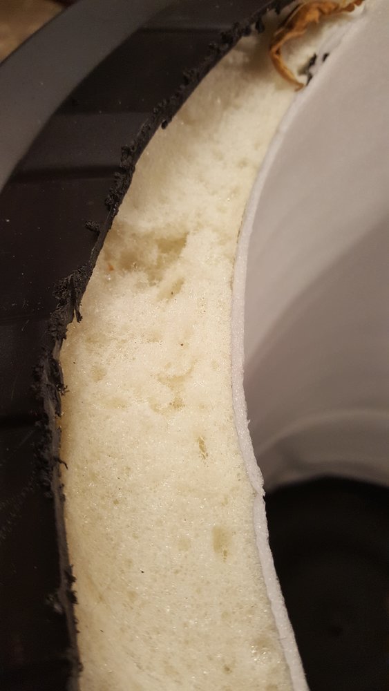

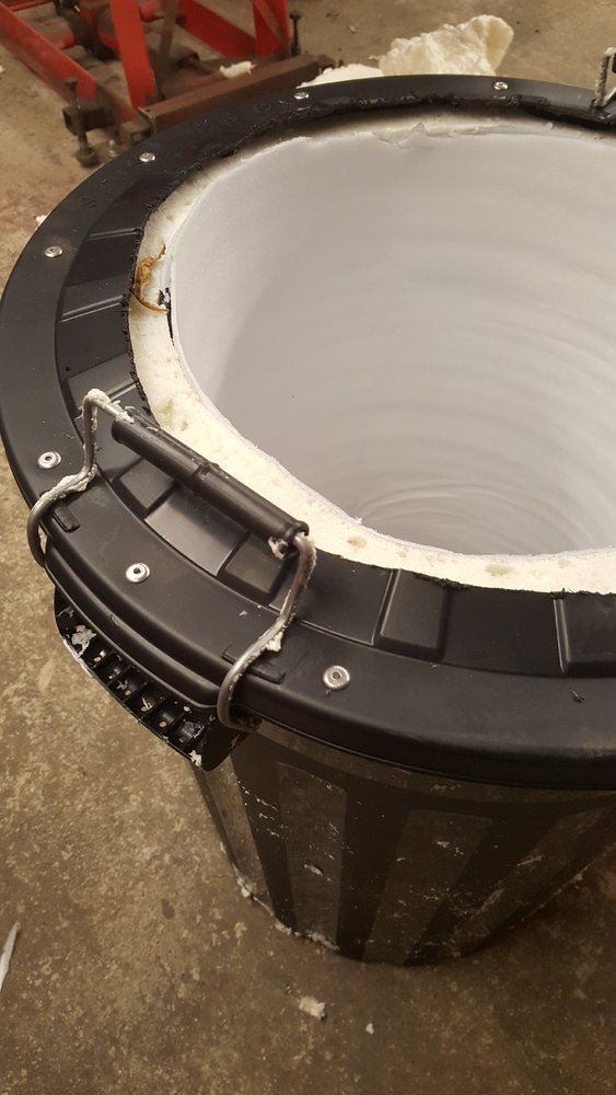

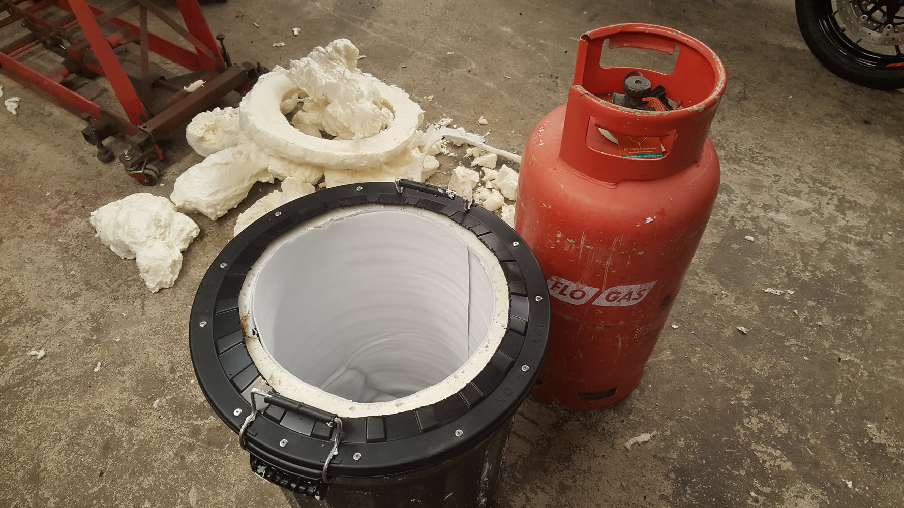

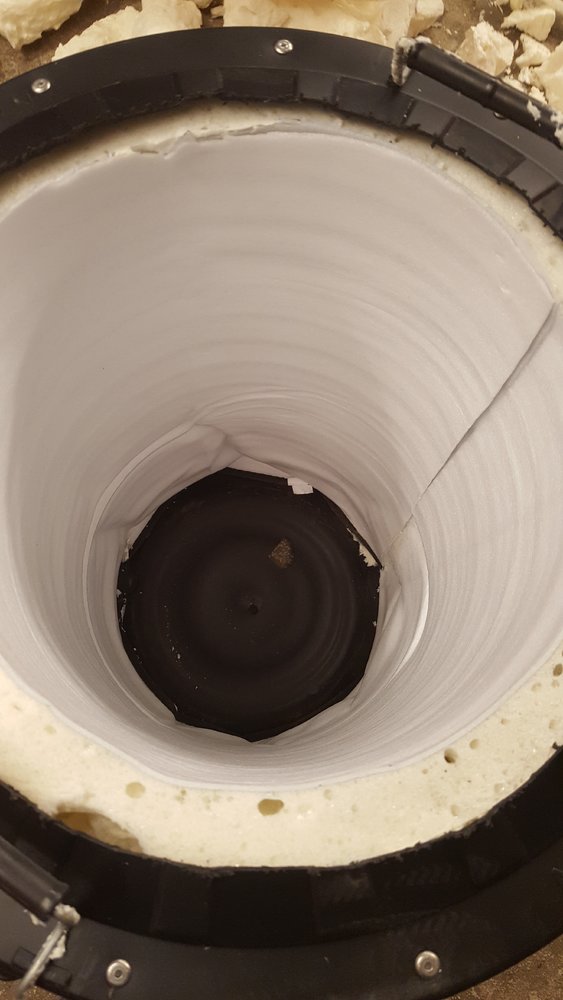

We use a load of Propane each week through our job and every winter we suffer the same problem of the bottles freezing and reduced pressure as a consequence, this is no good when laying the torch-on felts. This year i have a plan and have made a "Thermabin"
plastic bin lined with a foil frost protector for car windshields and then filled with expanding foam around a bottle...foam goes hard and bottle slides out.
as on warm days they don't get lined with moisture and freeze, plus when in the past we have wrapped them with storage tank blankets they do fine
