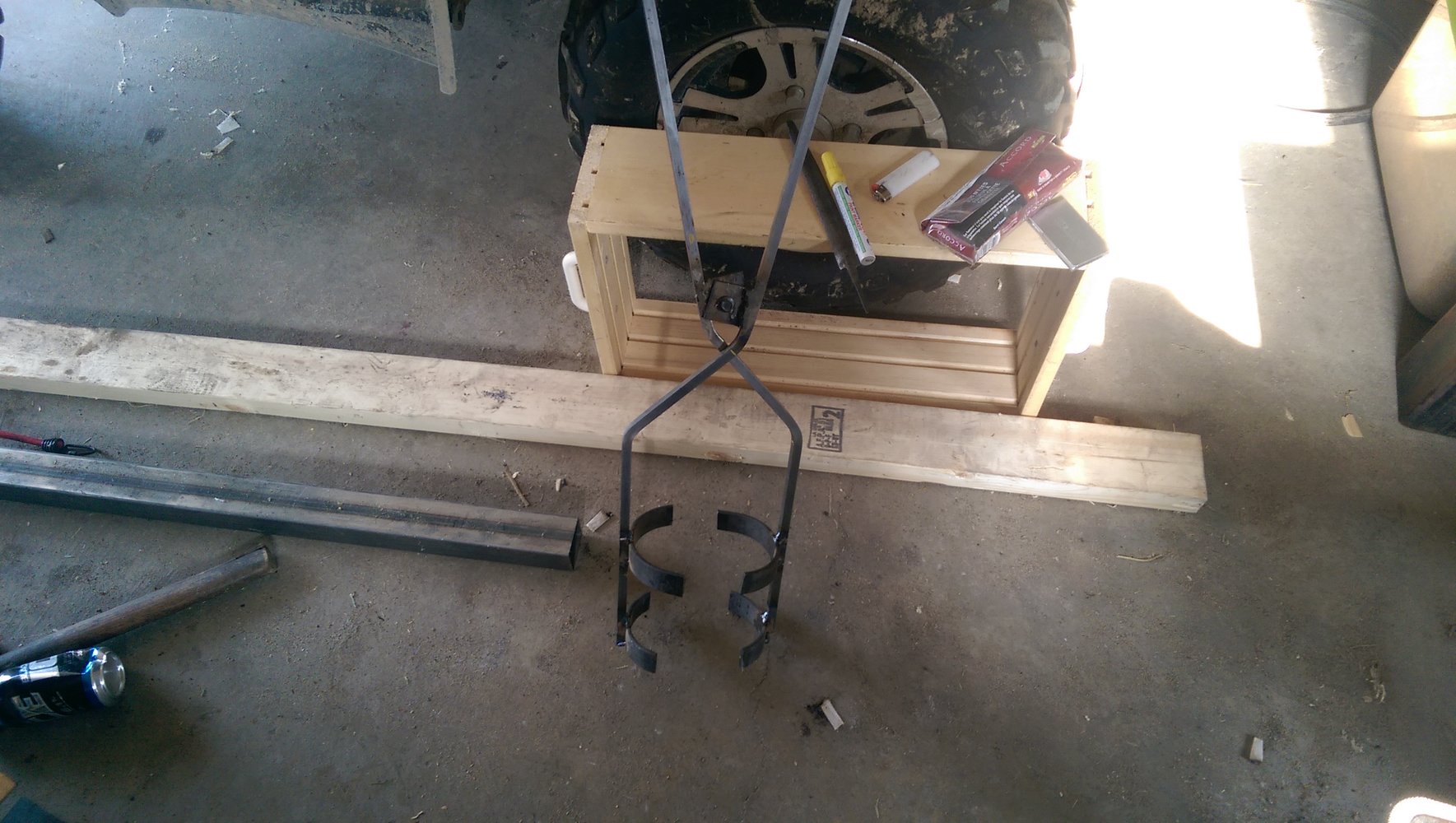

The plan is to weld some arms onto a cheap pair of pliers for the hinge.
Is mild steel sheet adequate? Everything will be hot, I do not want it to sag and drop out.

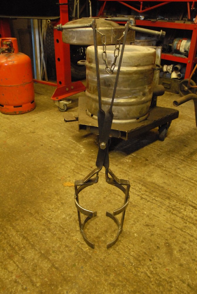

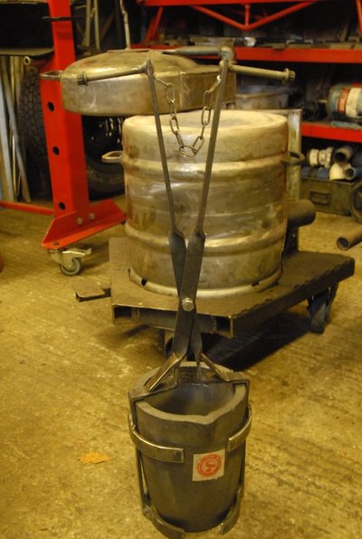

NoooThose both look good. Do you use the same for pouring?
Mine will weigh 2.5kg full of ali.
