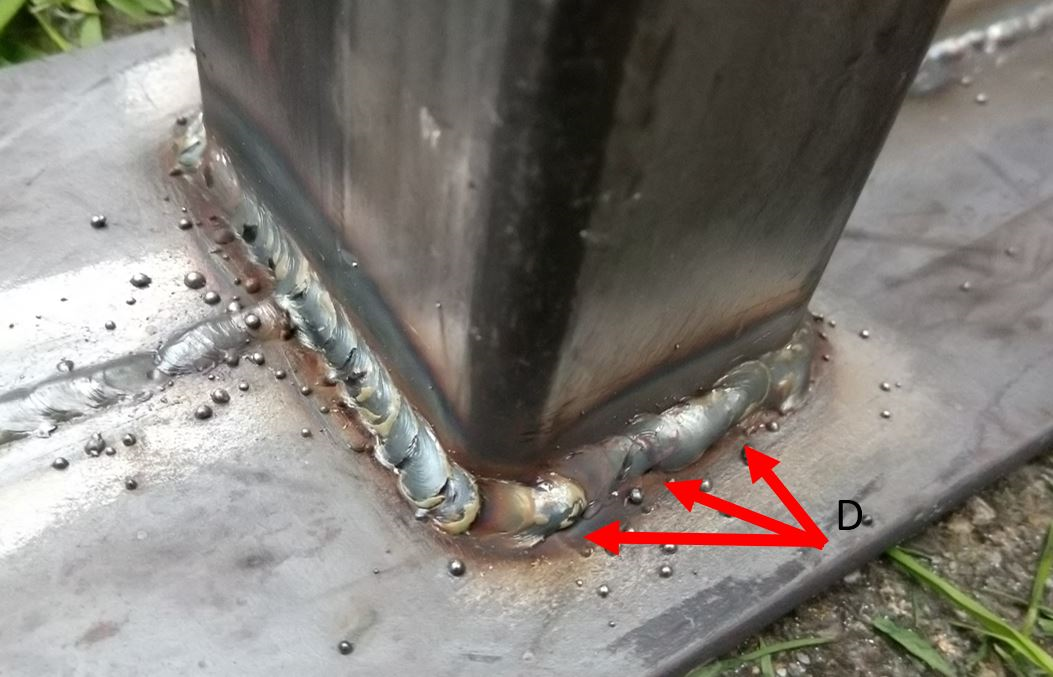

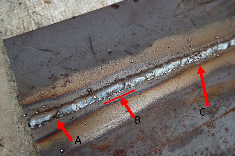

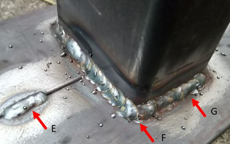

    Ey up, I joined roughly forever ago, then never actually got around to welding my car up. Life got in the way. I have however decided to weld up a skate rail as a bit of faff to do over the weekend - cheap thicker material is probably somewhat more forgiving anyway. Probably the first serious welds I've done in 'ever'. There's a bunch I'm not totally happy with though, can I have some criticism please?!
    Machine is a Clarke Pro 90 (not the EN one), set to max and wire on '7', whatever that means in volts and mm/min. 0.6mm wire. CO2 gas, at about max on the tiny disposable gas bottle regulator.
    Plate is about 6mm I think. Straight butt welded, no prep - partial penetration, I welded both sides.
    The RHS is 3mm, ~1mm land, 45° bevel (eyeballed with an angle grinder).
    I've tagged the more obvious defects, things I don't like.
    A - I finished here and went back a bit with the bead, I presume this is just cold lap caused by doing that, and doing it too fast.
    B - funny stringy bits at the toe, no idea why.
    C - Porosity but I'm not sure why. I was welding outdoors but there was no wind at all. A bit of dirt on the steel that I missed?
    D - Loads more cold lap. I was weaving a bit on the fillet, dwelling on the top toe, is this caused by not dwelling enough on the bottom toe?
    E - More cold lap. Travelling too fast? I notice it's necked here a bit.
    F - Welding around a corner. Should I have been starting on the corner, welding the length of one side and finishing on the next corner so all of my welds were straight without manipulating the torch too much?
    G - More cold lap again, see D.
    Any other advice?

    You're doing well with that welder!
    It's too small for what you're doing though, so cold lap is no surprise. You need a bigger welder...
    And get a pub gas co2 bottle as well, better still argon/co2 mix.

    No prep!
    Go on give it a fiddle with an angle grinder.
    Failing that, not too bad frankly.

    Doing well enough. Your faults are mostly related to the physical limitations of your machine.
    You need more amps (wirespeed) BUT that machine simply isn't capable of supplying enough current or voltage. Especially on those box section fillets. You should have at least 140 amps for those joins.
    Technically you're not supposed to stop on a corner - you're supposed to go around it like you have done, and the stop/start join on a straight. Most people just stop-start at the corners though, unless its something critical.

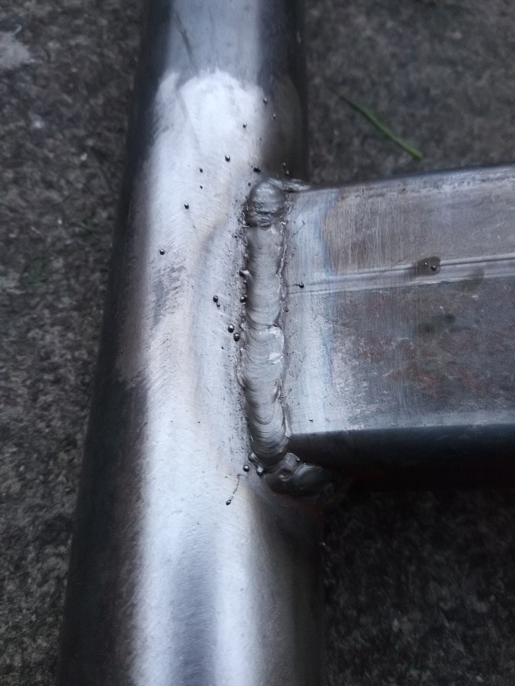

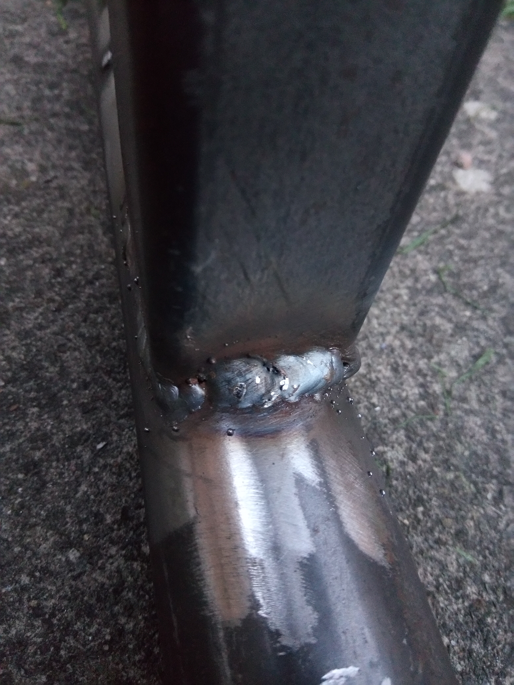

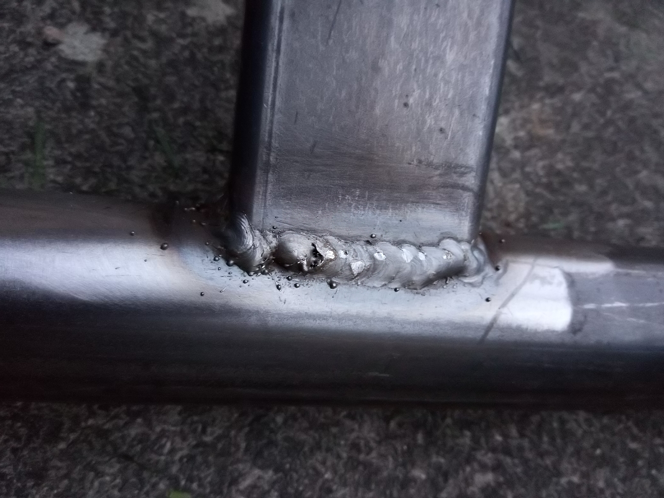

    Here's a couple more with 14% CO2 mix instead of 100% CO2 (disposable again, I've only got three welds to do then it probably won't come out again until next year).
    I did all of these in some convoluted position on the floor, rather than at a bench - that was a new experience.
    First - Cold lap again, can I solve this by dwelling at the toe a bit longer or is it just a case of there being no way I'm welding 3mm thick section with a 90amp welder without getting cold lap? Huge blob at the end because I couldn't get myself into a position to go around the corner.
    Second - There was some wind today, I think this regulator is at its limit. I'll probably repair this bit because it offends me. The restart was poorly placed as well.
    Third - Looks such a mess because the fit up was garbage, I didn't actually notice until I got around the corner. I used a lower voltage setting to build up a bead on the tube to close the gap, then ground it back so it didn't protrude much, then went over it. The tie in with the previous bead was poor again, this welding around a corner lark is harder than I expected, even after doing some dry runs to test the range of motion.

    In terms of the machine ya have dude ya didn't do bad as at all. Ya cleaned the material and did alright in regards to the gas too much is as bad as too little but it's probably a bit of dirt that got in the way. You would need a welder capable of about 150 amps to give th t thickness of material a good go but as said ya did well with what you had. Chamfering the ends off the 2 pieces of material your welding togehter would help a bit in regards to penetration and building up the size of the weld but still a better machine is the way to go.....Xmas is a coming
