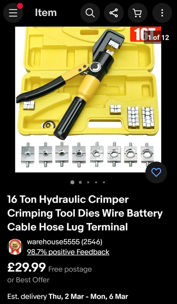

Yes, I have seen those but never had one to try. Aside from being sized in square mm (not diameter), I think they would have the same problem as I have been having. There is nowhere for the excess metal to go except between the halves - it might work, if the die size were close enough to the required size.Did you check fleabay?
There are various crimpers on there not sure how good they are though.

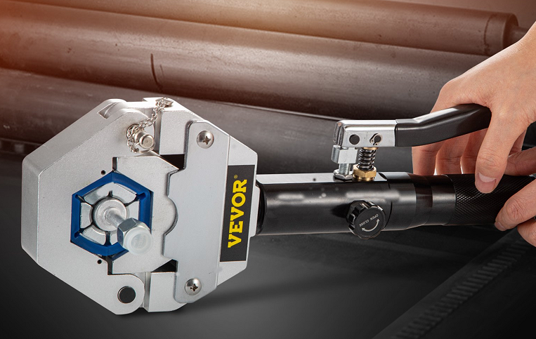

I posted a picture of this earlier but I didn't know how well it would work.Aliexpress/Vevor AC hose crimper will do these, and airline ferrules.
But it won't do hydraulic hoses.
It'll do low pressure hydraulic hose ends (for automotive AC applications) but I wouldn't trust it for proper hydraulic work.I posted a picture of this earlier but I didn't know how well it would work.
I guess it does, thanks. Odd that it doesn't do hydraulic hoses though as it's called "VEVOR 71500 Hydraulic Hose Crimper Tool Kit". A different model perhaps.
