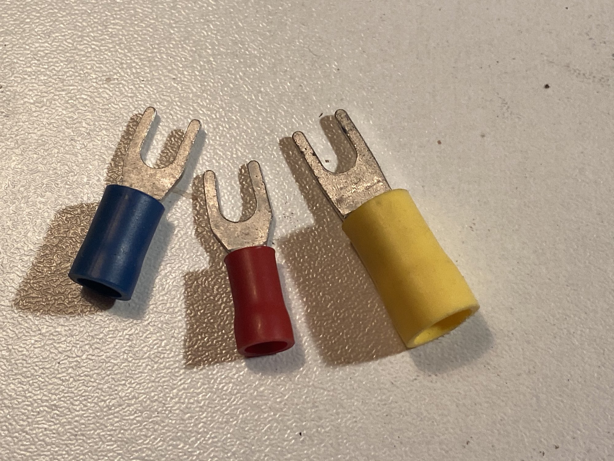

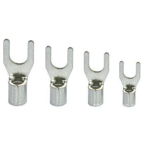

You sorted @Parm ?
M8 is yellow, off the top of my head.
I don't have forks, but I've rings, doubt I've 24...
What thickness wires?

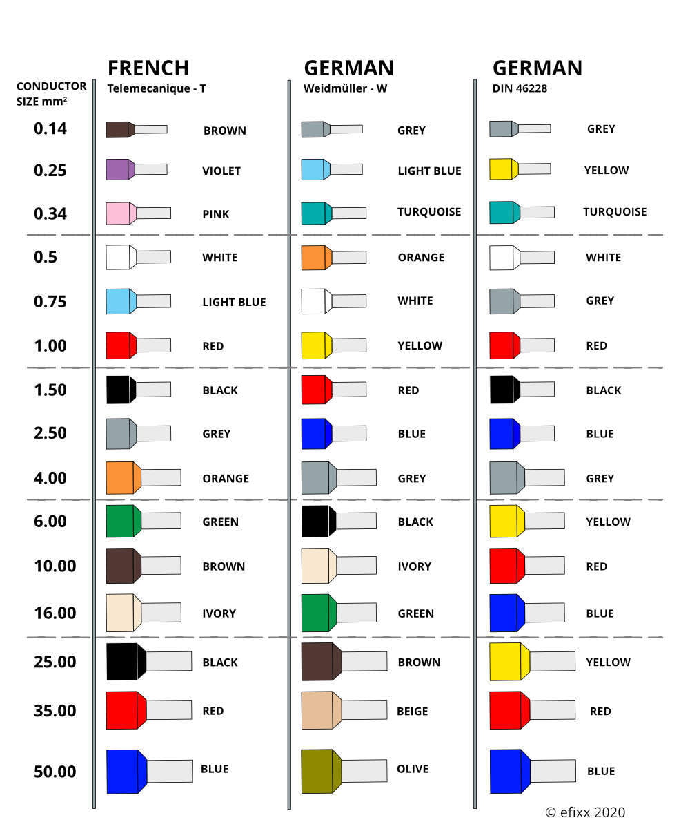

You can get m8 in various colours, it’s not related the the crimp colour (which is to do with the wire size you can fit in)
