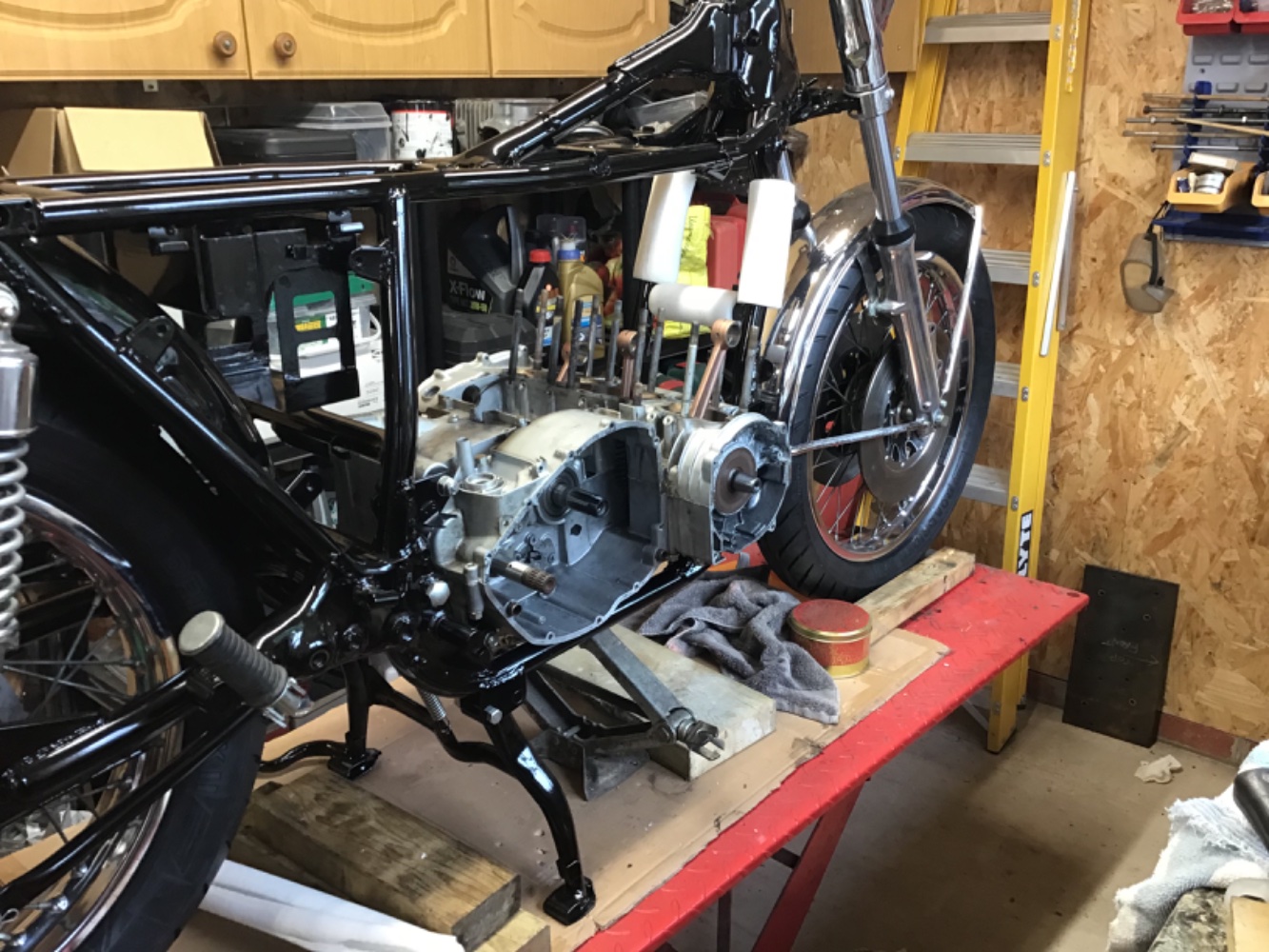

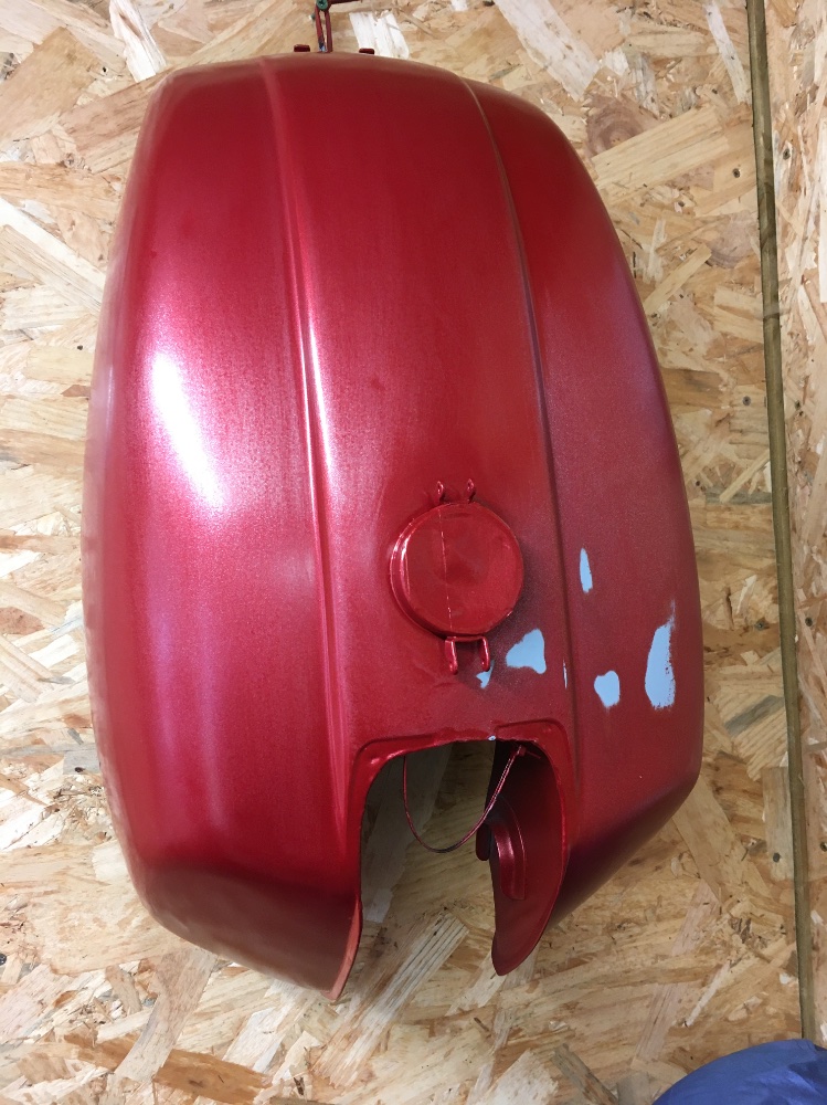

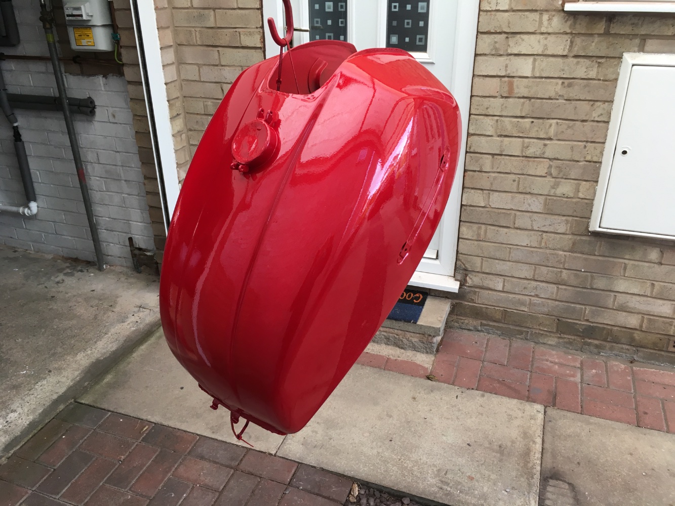

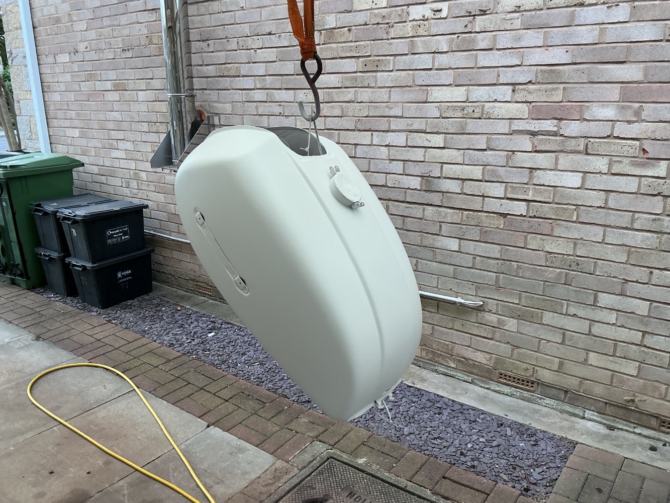

Tank and side panels given a couple of coats of epoxy primer. I had some leftover aerosol white paint. I used this on the side panels to give the colour base-coat an easier time.
A bit more flatting off needed on the tank as the primer went on a bit orange peely.
If it’s warm enough tomorrow ( I paint outside under my carport ) I’ll do the basecoat and lacquer. I’ve chosen Ferrari red pearl metalic.

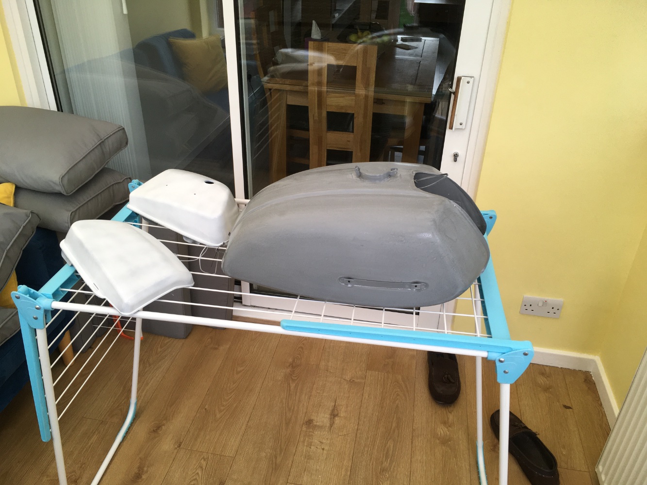

Here they are in my drying oven (conservatory)
