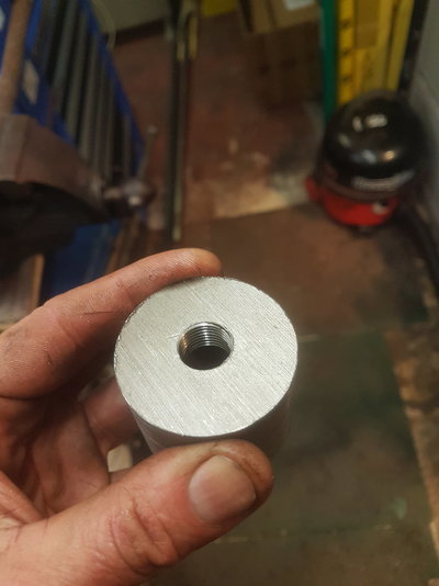

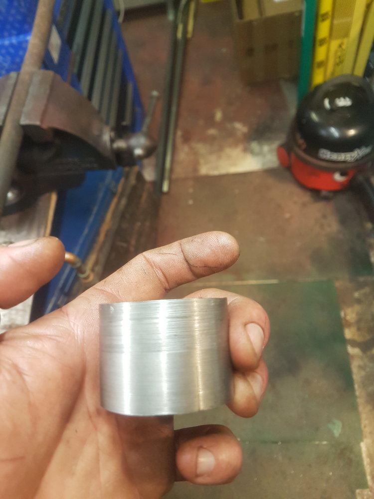

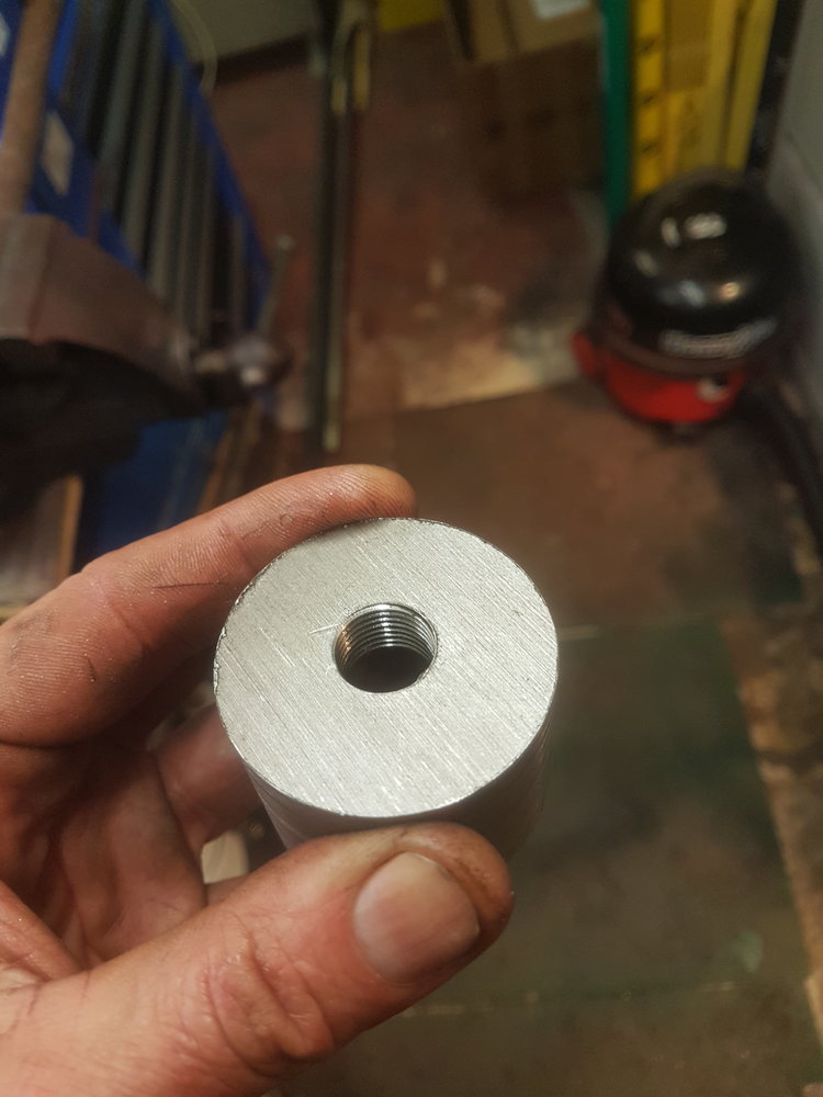

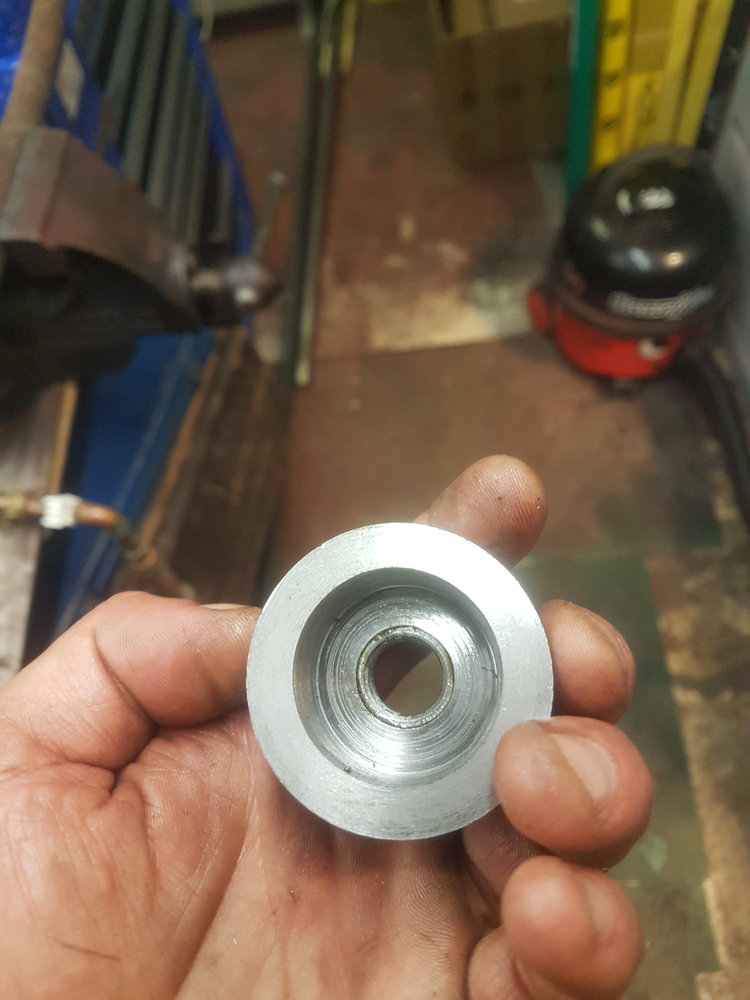

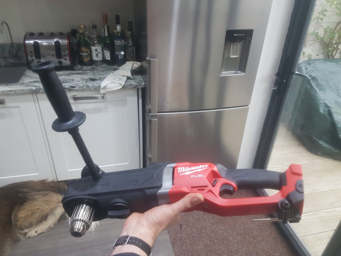

I do think my.best chance of getting it centered is to cut the front slam pannel out and hit it square on.
What I’d be doing too.I do think my.best chance of getting it centered is to cut the front slam pannel out and hit it square on.
What is it

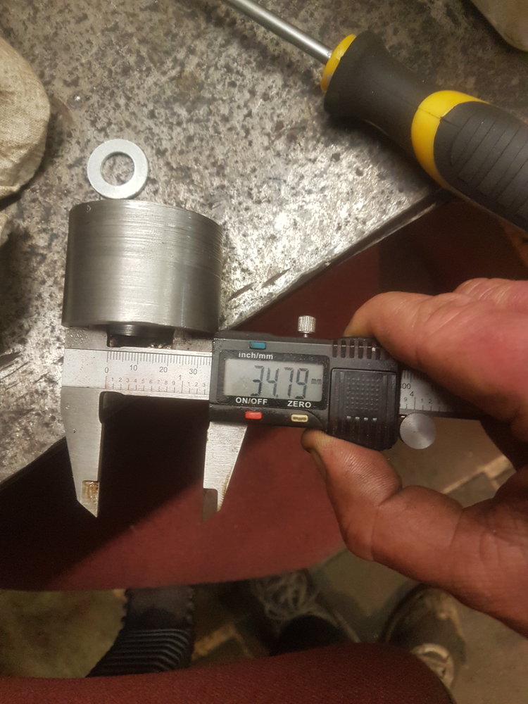

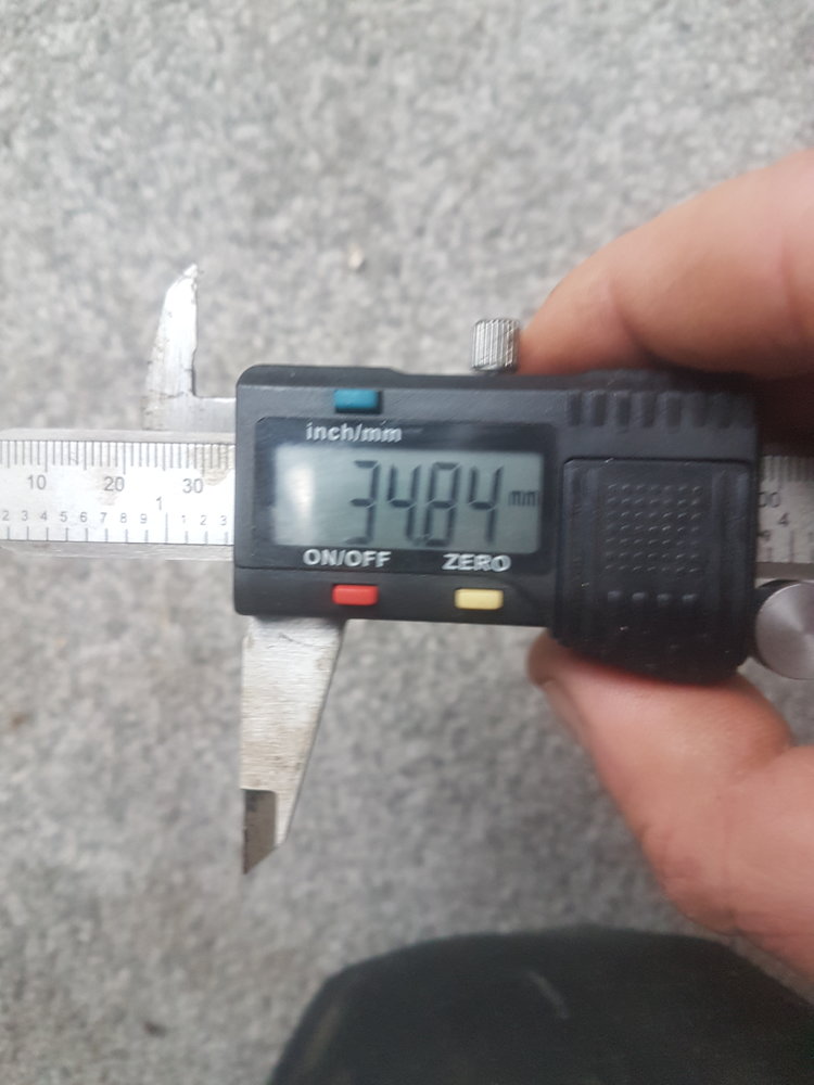

If thats all that needs to come off dont use a standard 2 flute drill as it wont be very accurate, the least worn flute would probably cut the whole amount throwing off centre, that is a job for a reamer, £££.Cant think why not. Especially as you’re only taking .25mm off.
That is a good idea I could use the pulley itself with a washer in the center to center the drill or reamerIf thats all that needs to come off dont use a standard 2 flute drill as it wont be very accurate, the least worn flute would probably cut the whole amount throwing off centre, that is a job for a reamer, £££.
If it were mine, turn a bit of silver steel or hss to the final size and grind straight flutes and a bit of clearance so it can cut.
The OD is tapered for the pulley? You could turn a matching taper and have a bore to guide your drill/reamer/tap and keep it true.
That’s the oneMilwaukee M18FRAD-0 18v Super Hawg Right Angle Drill Driver Bare Unit
The Milwaukee Super Hawg comes with a brushless motor which provides constant power under load. With it's all metal gear case and keyed chuck this Angle Drill iwww.powertoolmate.co.uk
I like the look of this bad boy!
I reakon with that and a guide bush turned up it should be doable without cutting the front out.That’s the one
