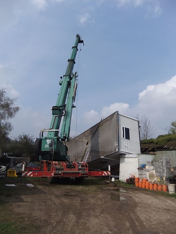

A cautionary tale, earlier in the year i had a phone call from a friend, "Do you want a laugh, the effing cranes dropped the portacabin on my barn".
Of course i shot up there as you do.
The miracle was nobody was killed or even hurt. Basically the operator lifted the load so high that the hook block hit the sheave box at the top of the jib, the safety stop had been either disabled or switched off. Result was the wire parted & the whole lot came down hit the barn & bounced out sideways, if you look carefully you can see the hole where the block went through the roof as it was bouncing back up.
Tjhere was sea of smashed asbestos & its going to cost a fair ols whack of money to sort out!
