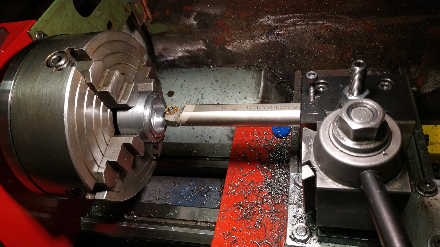

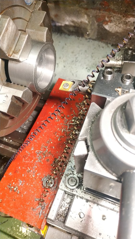

Silly question, is the lathe rotating the right directionI cant get this boring bar to work. New, proper cpmt09t308 inserts do
not improve over the modified ccmt's. Any cut deeper than 0.4mm diameter gives bad chatter, hot chips and possibly rubbing but marker pen isnt showing where. Inserts wont be the problem but I'll try them in the sclcr bar with a shim in pocket to rule it out.

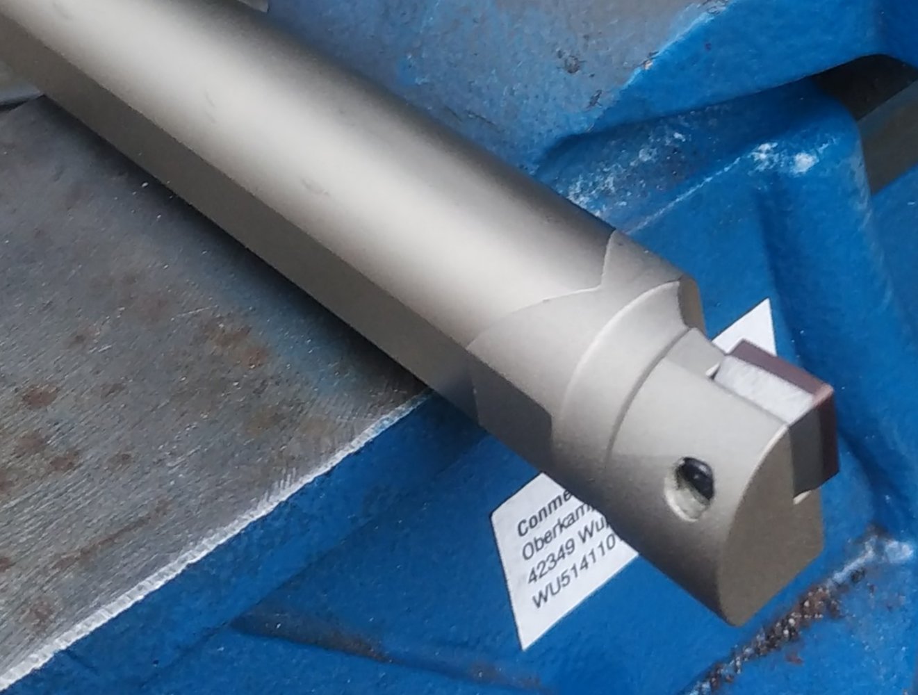

It must be intended for 0903 inserts as t3's have a slight 0.07mm clearance in the pocket which Ive sorted with copper shim, but should make no difference.
Stickout makes no difference so the carbide shank is good. I might unbraze the end, or tig up the pocket and cut a new one.
My 12mm carbide SDQCR bar beats this in every way.. £60 wasted, never going to use it as it is.
Without knowing why, Im not sure what to do with it. The modified ccmt's should have worked with the bar rotated over 15 degrees.
Ebay didnt give much choice for the cpmt's. My sclcr09 bars work with the chinese 08's. Gives me something to try - I'll modify a ccmt09t302 to fit and try rotated over. I'll try a copper shim to fit a new insert in a sclcr bar and see how that works.0.8 nose rad is too much for that bar in my opinion, 0.4 would work much better.
It shouldn't really matter with regards cutting as long as the geometry is presented correctly. It will however make a difference to the feed distance as it will not be consistent with the dial.When you rotate the bar are you setting the tip up to centre still or does that not matter?
The geometry of the bar/insert will be designed for the minimum boring dia of the bar.Robin do these boring bars have a diameter range? As in does the rake of the tip need to change as the diameter of the piece being bored reduces?
Bob
They usually have a minimum bore size that they will fit, not sure there is a maximumRobin do these boring bars have a diameter range? As in does the rake of the tip need to change as the diameter of the piece being bored reduces?
Bob
Was because we were talking about rotating the tool to get the geometry correct due to the insert being the wrong geometry for the holder....as long as the geometry is presented correctly. ...
I think the answer is to get the correct inserts for the bar.Would raising the tool a tad help in Krams situation help?
Bob
I think the geometry will not be correct because as you take a cut the geometry will change. As the diameter increases though it may be giving you more clearance but you will get to a point when you begin to cut above your new effective center height. Is that correct? Although Krams problem is not solved, I am learning a lot so thanks everyone!Just to add, what I was meaning when I said
I suppose technically the full geometry will not be correct unless you are using the correct insert in the correct holder and at the correct centre height. If you rotate the tool holder so that the insert has the proper clearance then it should work, but should and will are two different things as you also need to take into account the chip breaker which on a rotated tool may not be presenting itself to the material correctly, that may or may not matter too much as it will depend on the chip breaker.I think the geometry will not be correct because as you take a cut the geometry will change. As the diameter increases though it may be giving you more clearance but you will get to a point when you begin to cut above your new effective center height. Is that correct? Although Krams problem is not solved, I am learning a lot so thanks everyone!
