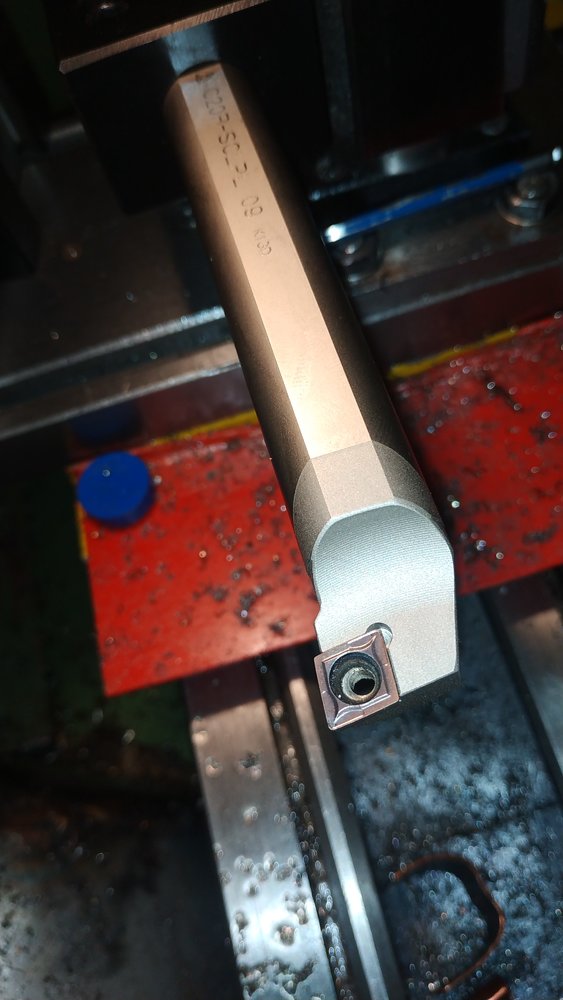

I bought the wrong boring bar thinking it was going to be compatable with the ccmt09's that I have. The pocket is slightly smaller, shorter (03 not T3), and sits flat rather than 15 degrees over, so all of the clearance is in the insert.
1) Buy the correct inserts.
There are a couple of part boxes ebay, but more choice if T3 height will work in a 03 bar? Anyone know where to buy them at a sensible price or have any to sell?
Cpmt090304.
£85..
www.cutwel.co.uk
2) File the pocket out to fit ccmt's and rotate the bar for clearance.
Cpmt090304.
£85..
CPMT090308-VF NC3030 Carbide Turning Inserts (Finishing Chipbreaker) - Korloy
The CPMT090308-VF NC3030 carbide turning insert has a Rhombic 80° shape and an VF chipbreker designed for Finishing applications. This insert has a Positive geometry and is a NC3030 grade (Coated P35 Steel Grade Intermitant Turning). Korloy's range of turning inserts are made from a fine carbide...
