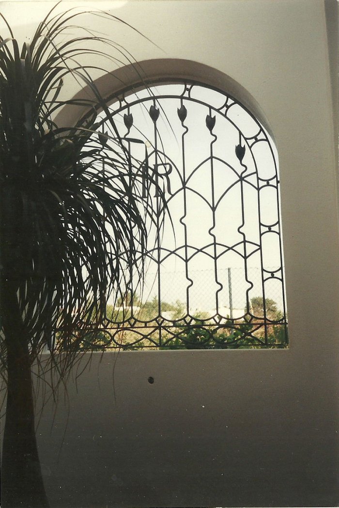

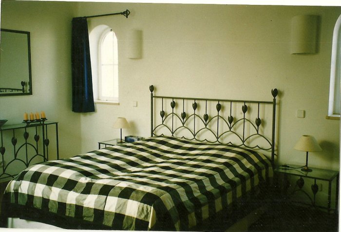

Not sure if these are furniture or sculpture. But after Pondy's lotus flower, it reminded me. Client showed me a pic of a wooden door by a Vietnamese artist. Could I do a grill with it as a theme?
Lotus flowers don't exist, but pond lilies are next best. And I made the flowers from three leaves pressed from sheet, round a half ball pressed over a 1.5" tow hitch. Result was a bit tulip-ish. They liked it and asked for a bedroom in the same style. The curvy bits are 10mm sq. bar and the verticals 10mm round. Frame is 40x8.
They were going on about how great it was to have something unique in the house, so I told them I had just got an order for 20 rooms like it for a small hotel. The look on their faces was priceless. No sense of humour, the Swiss
