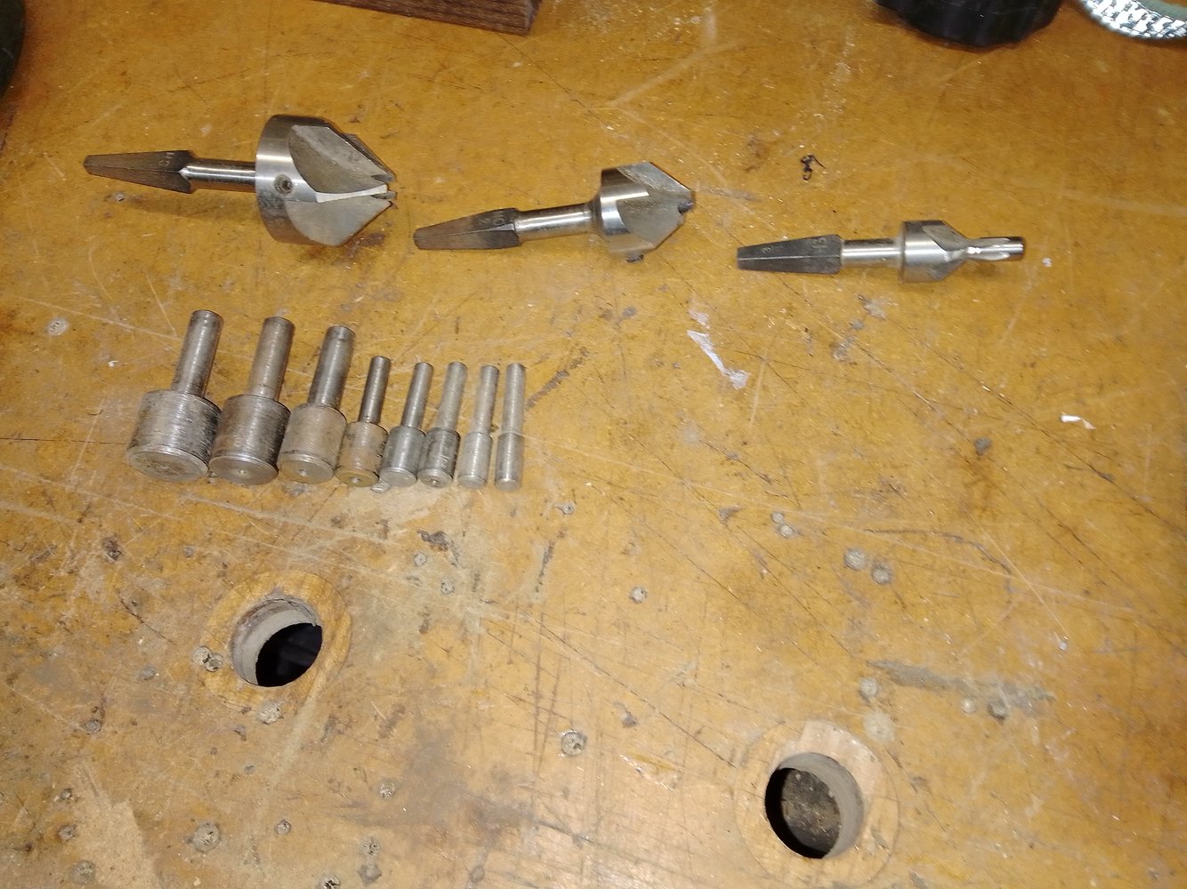

First thing I clocked in the pic.Am I the only one spotting the irony of having almost the perfectly sized holes in the background which would just suit such a countersink....![]()

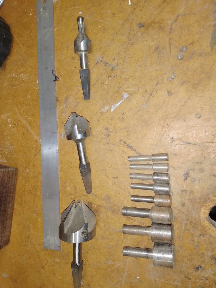

. They are for sharpening the hollow square chisels in a morticer.
Well done, I'd never got to that.They are for sharpening the hollow square chisels in a morticer. Different size pilots to suit a range of chisel sizes
