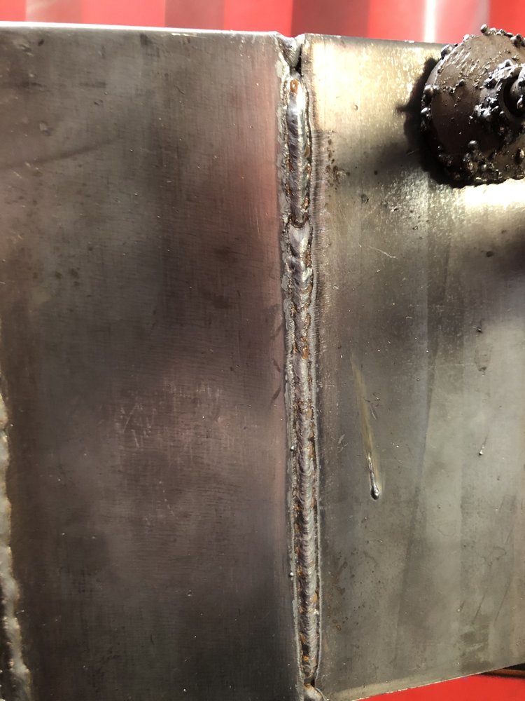

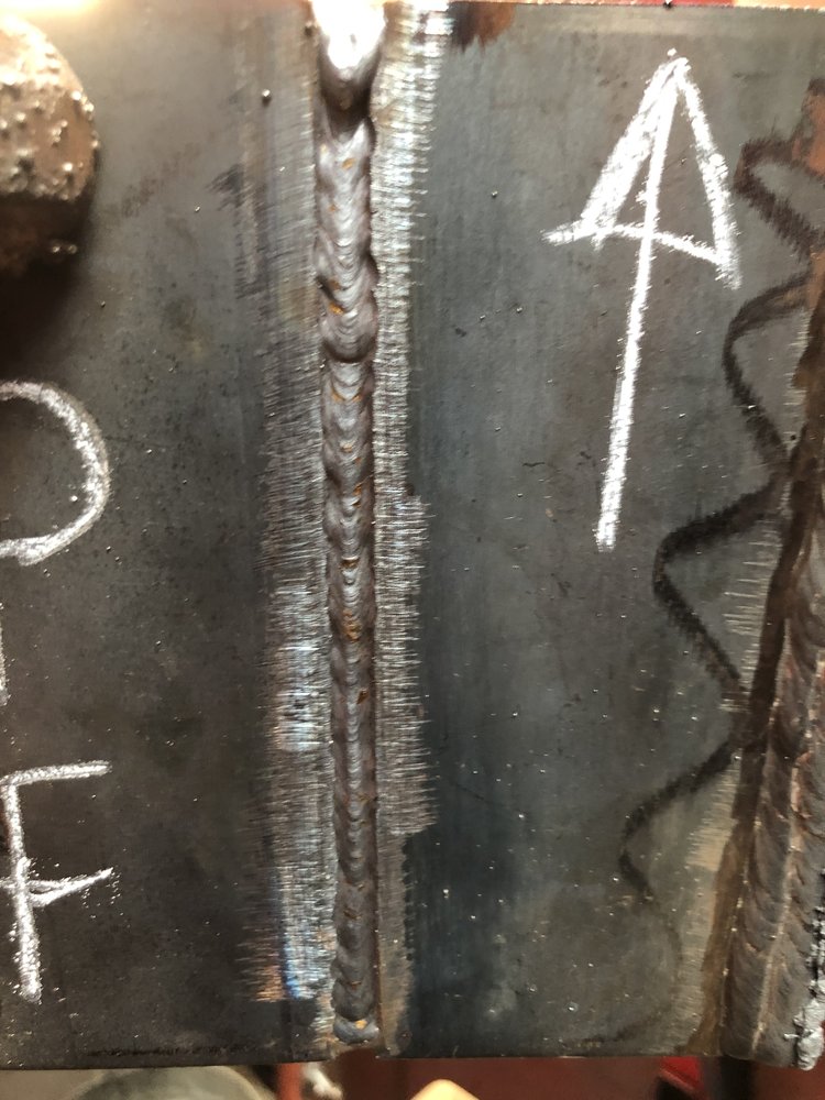

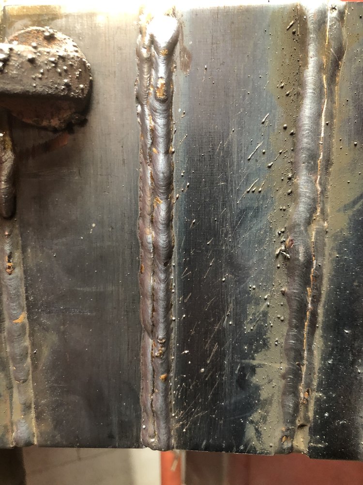

Well they do butt welds on 3mm the previous academic year but, of course, anything like 6mm to 8mm is a different kettle of fish due to the multiple run issue. It would be so much easier if root and cap were allowed....but they are not. As I mentioned, the issue with 6mm is once the root run is on, there's hardly any room to do a second and third.Are the students not allowed to bevel their own plates?
3 runs would be a lot easier on 8mm+. And the best reason for doing butt weld is because it's harder to get right than fillet, and also easier to inspect. I'd have thought a butt weld would be par for the course, so to speak.
