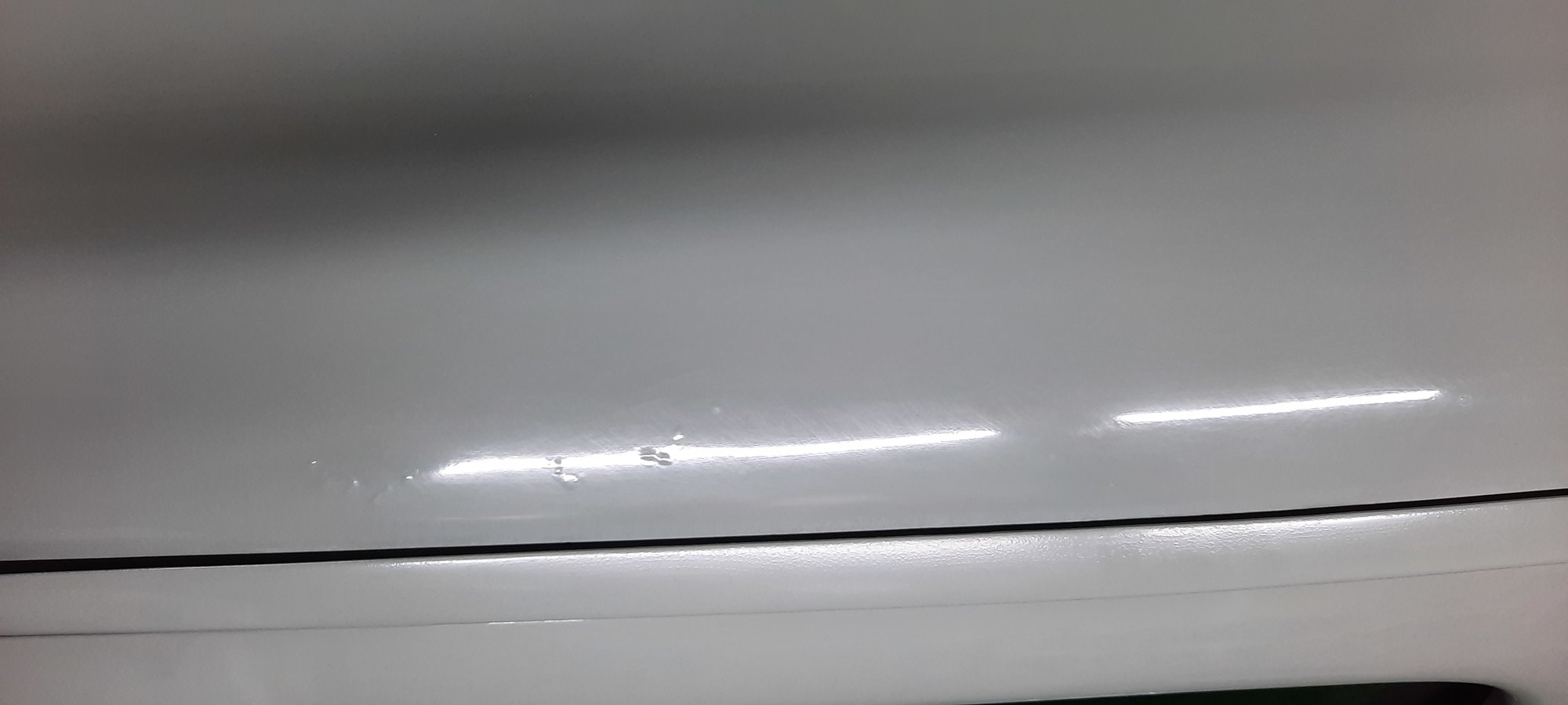

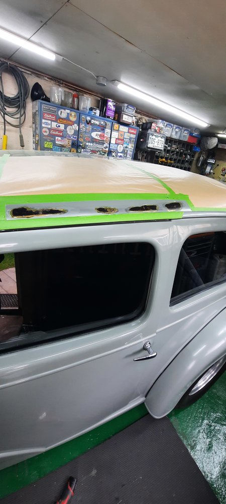

Start to finish through the week, ground out rust spots and covered with Fertan, brushed on Lechler epoxy primer and flatted back and fill as required, several thin coats of Lechler hi build as I'm only using my 1.3 gun, quick guide coat of black etch primer from a can, flat back and feather and several coats of ie ? gloss too flat back tomorrow, match is good !
