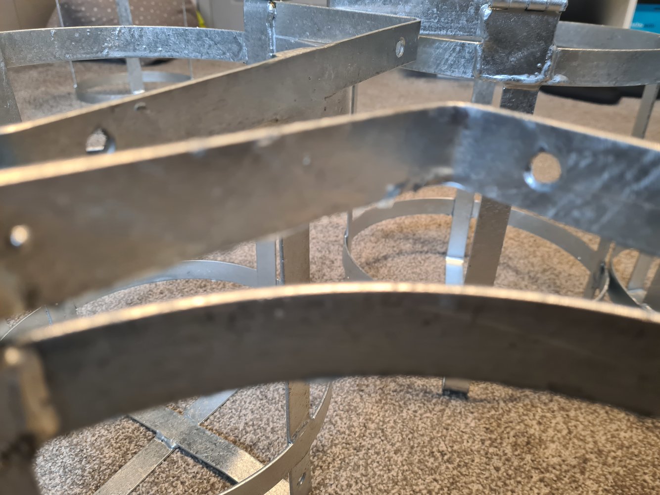

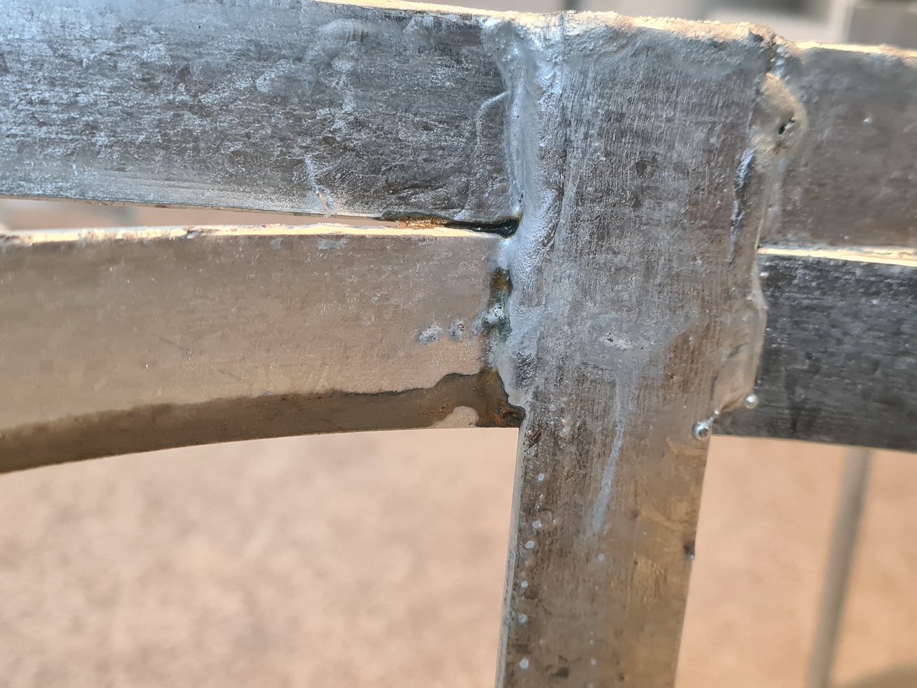

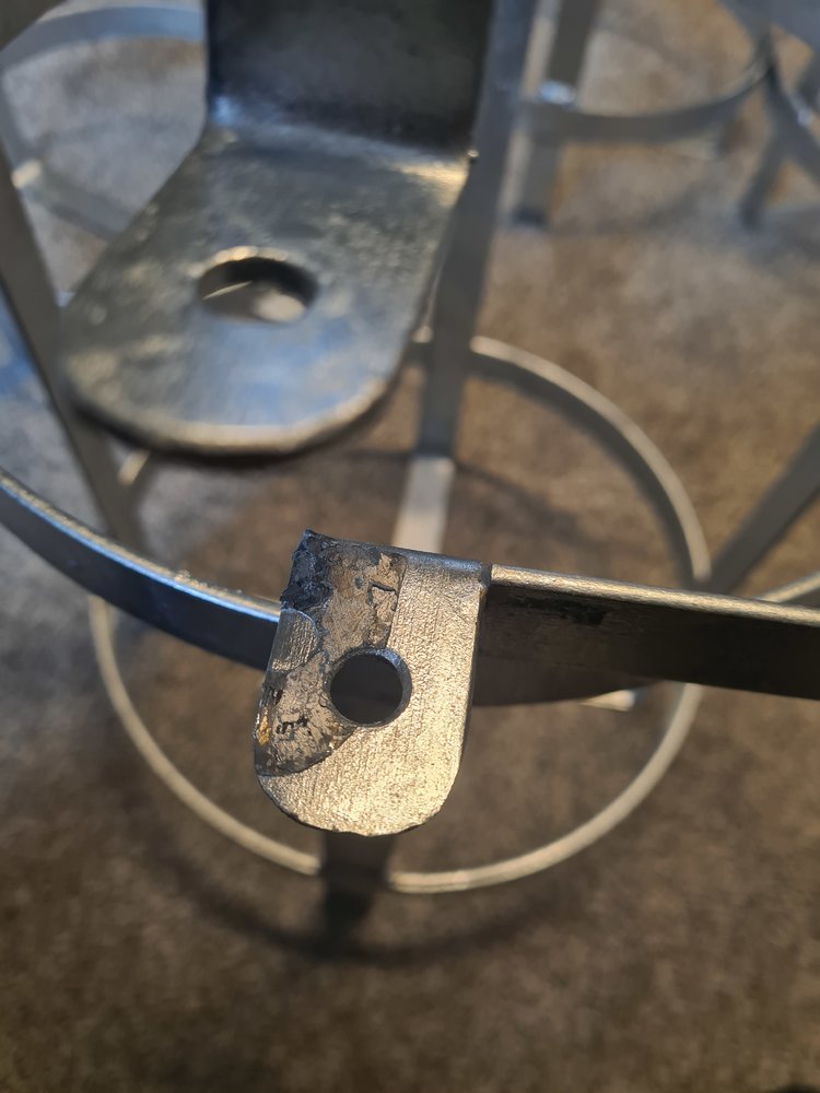

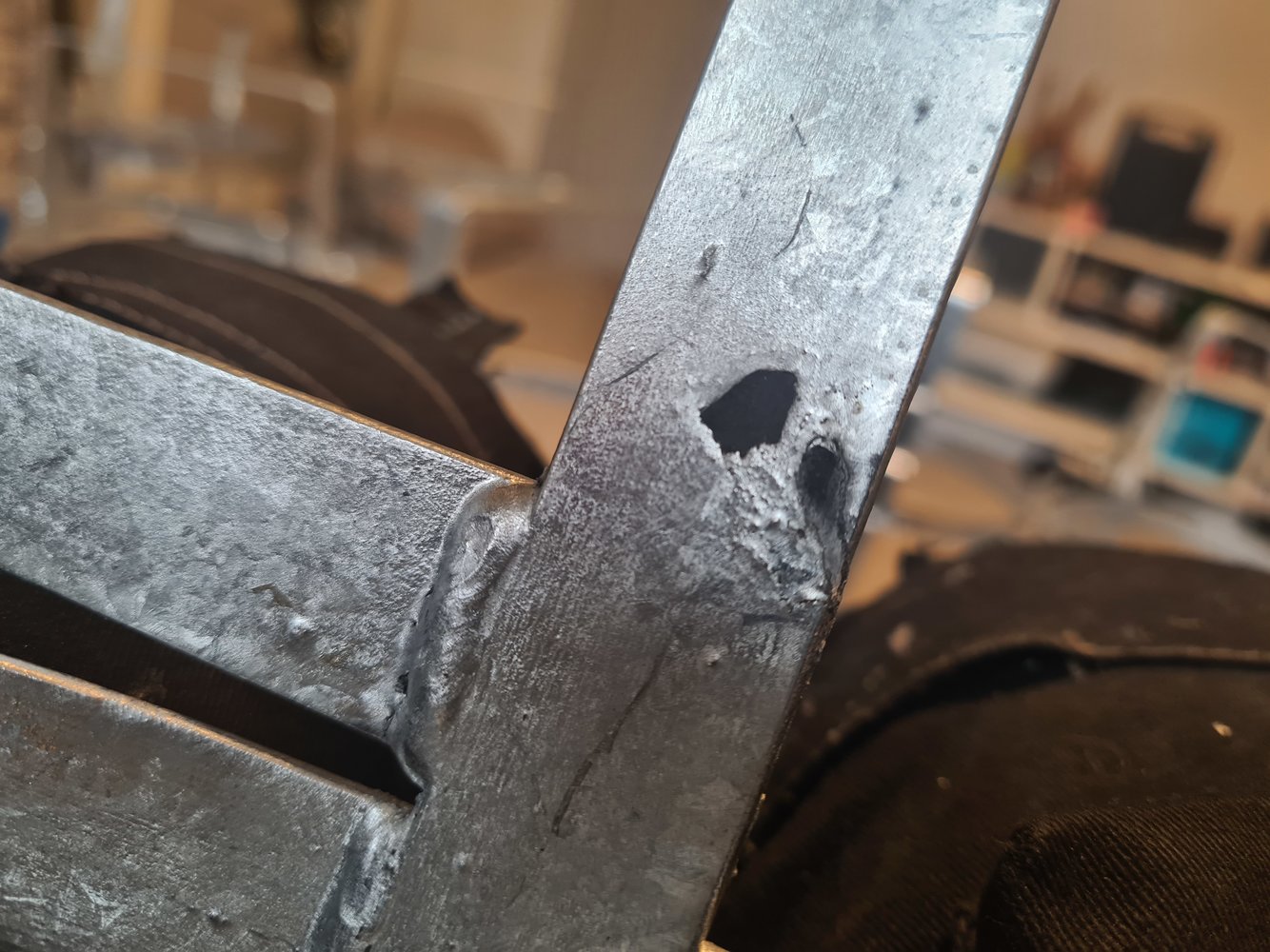

Looks a standard job
That's rough, send it back and get them to strip and regalv.
Galvanising is a fairly brutal industrial coating, it's never going to be perfect, but that's not the best, albeit i've seen worse.
There's usually always a bit of fettling needed.
The hinges were always going to seize up. They need to be galvanised as separate parts then assembled afterwards.
