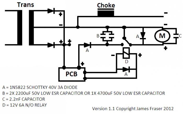

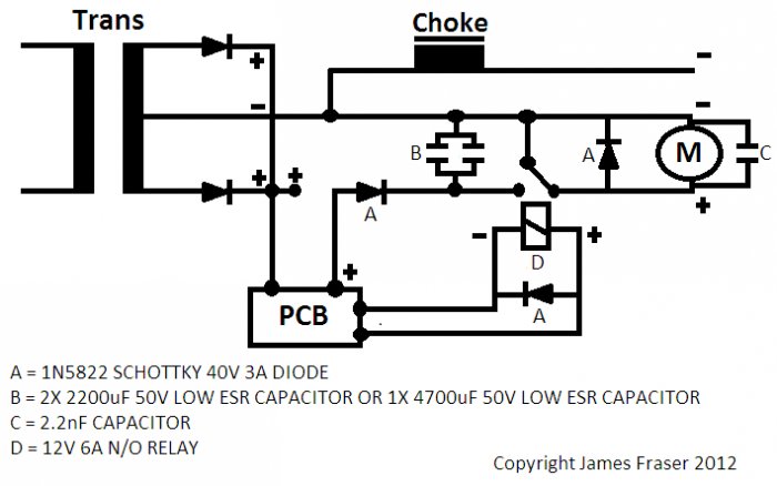

Dont know whether to tag this on here or if it should have its own thread. Looking through the forum I have seen three different ways to mod the wire feed controller. This one using capacitors to smooth the power and a relay to do the switching, another using a mosfet instead of a relay and a third building a separate power supply. All seem to work, I guess because they all fix the problem of erratic power supply to the motor.
But which one is best?
