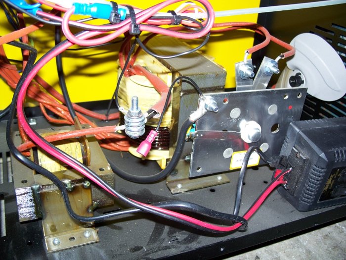

Picked one up as new from B&Q some weeks ago, it works as one would expect for the money with the wire feed being the main problem area.
Now I would like to make it a bit more stable and I am considering revamping the controls to the wire feed.
I have a few thoughts before I start to draw my own circuit for the board.
I want to stop the speed increasing as I change the current setting so I am considering fitting another transformer from the mains switch to provide a fixed AC voltage across the bridge rectifier, hopefully this will stop the wild speed swings I am seeing.
I also could take it a stage further and use a PWM control board to control the speed of the wire motor. I have one doing nothing somewhere! But for that I need to provide a regulated supply, which is again not a problem but can anyone tell me the voltage rating of the motor?
What other simpler mods are there and is there a circuit diag from this welder including board before I trace it all out?

I must say that although I see where Adrian is coming from, I might think differently in his shoes. In my case the SIP was my first MIG and it took me about 8 months to realise it was the machine at fault and not me. I had thought about building a decent PWM speed controller for it but decided in the end that I should make it pay for itself then replace it with a half-decent welder. I don't have the time I used to have to mess about polishing a turd. If I had just bought it and found out immediately it was rubbish I'd probably have taken it back.I know Steve that for a few dollars more he could have bought a machine that didn't need messing with
Do try replacing the trimmer pot. It sounds from your description as though it will make quite a difference. At least you'll have some control over the wire speed. Then you'll probably find that the increasing speed with increasing voltage setting is a useful feature.Thanks for the link to the circuit I will print and study
