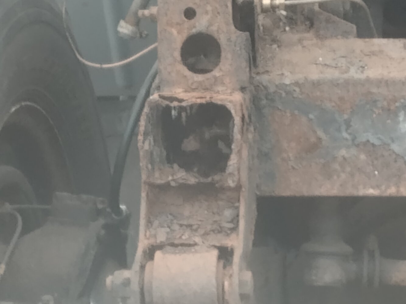

Standard Landy rust pattern, test chassis with small ball/pein hammer backwards until solid ring found. Then support the chassis measure and remove tin worm as required.....
