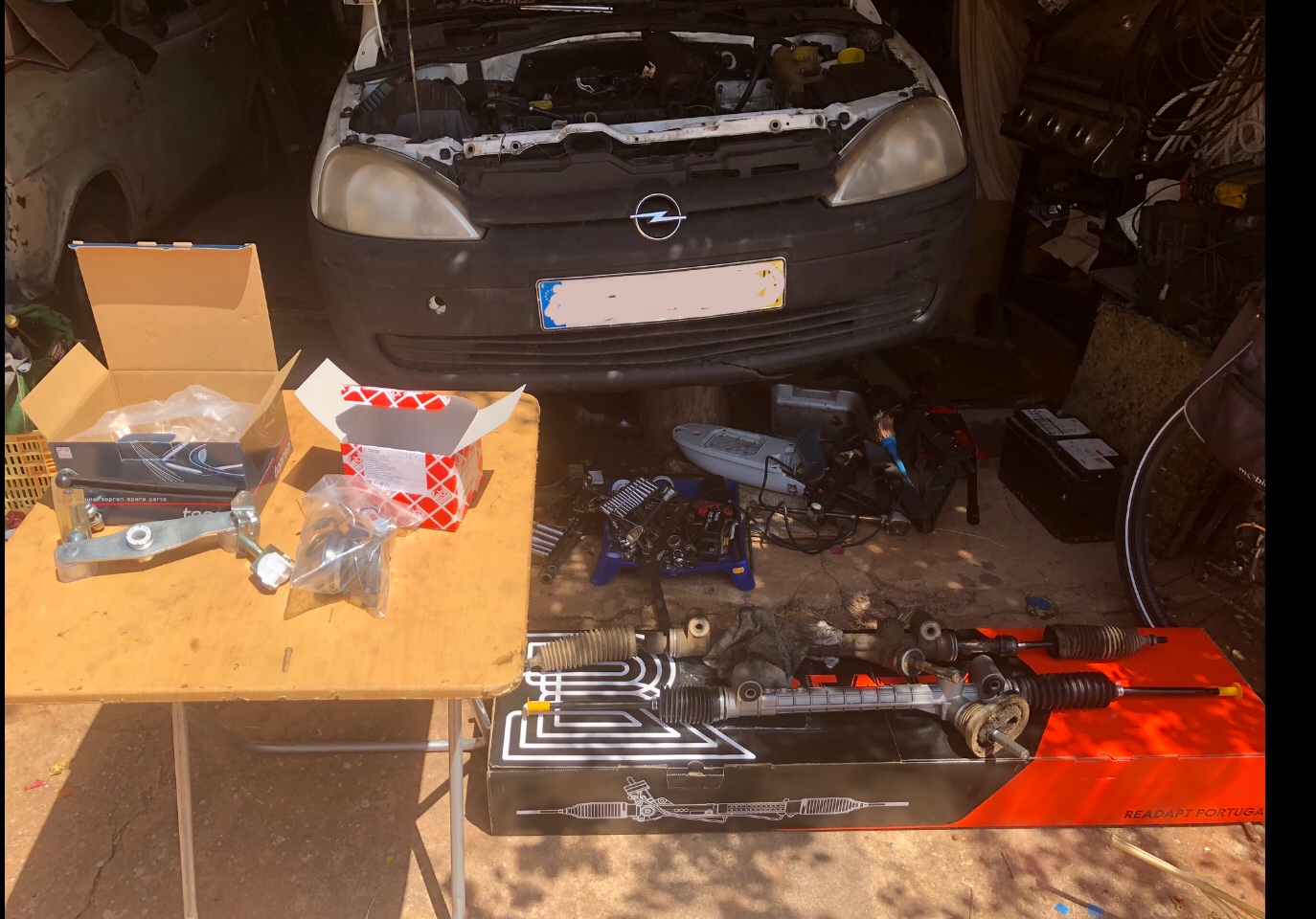

I like making it easy on myself these days, I don't like grovelling around underneath and struggling, hence taking the front end off. Does involve disconnecting everything, but its not that difficult. It is a bit time consuming the first time you do it though, when some screws and fixings are rusted up, and need replacing.I put the car up on ramps, the bushes in the steering rack are shot so it needs a complete rack not just knuckles
Guides online (and me peering under the bonnet & from below) makes me think there's an 80% chance I should be able to split the engine & box without needing to lift them out of the engine bay. I've changed a Lancia Beta clutch before by splitting the unit and pushing the box sideways several inches.
I'm hoping I can do the same here - I've had practice on the Lancia so less skinned knuckles than last time would be good news
The good news is the steering rack and the gearbox both need the back of the subframe dropped so at least I only need 1 dismantling session then I can do both jobs. It's a small positive but I'll take any good news at present.

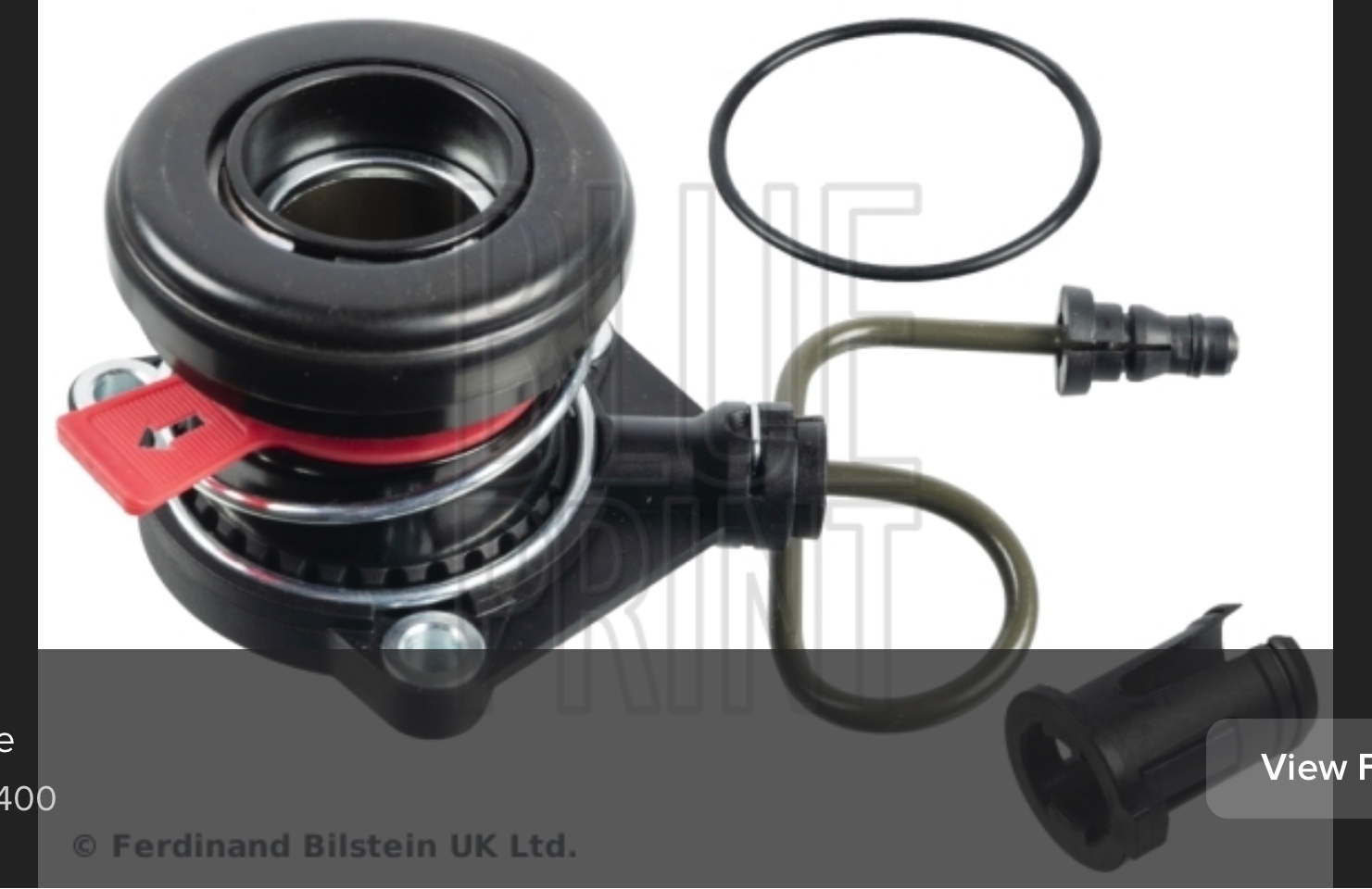

Once the engine & box are split I can see what the clutch needs - it's either a new slave cylinder £££ or a new "O" ring (7p + vat). Place your bets now

In other news, this is now in the slot that has just been vacated by a Renault Espace - I didn't realise how HUGE the Espace is ! With the Combo (Corsa van) I can walk around and have elbow room to work on all 4 corners. The Espace was parked tight against the side wall and the "workable" side was where the "workable" side of the Combo is![]()

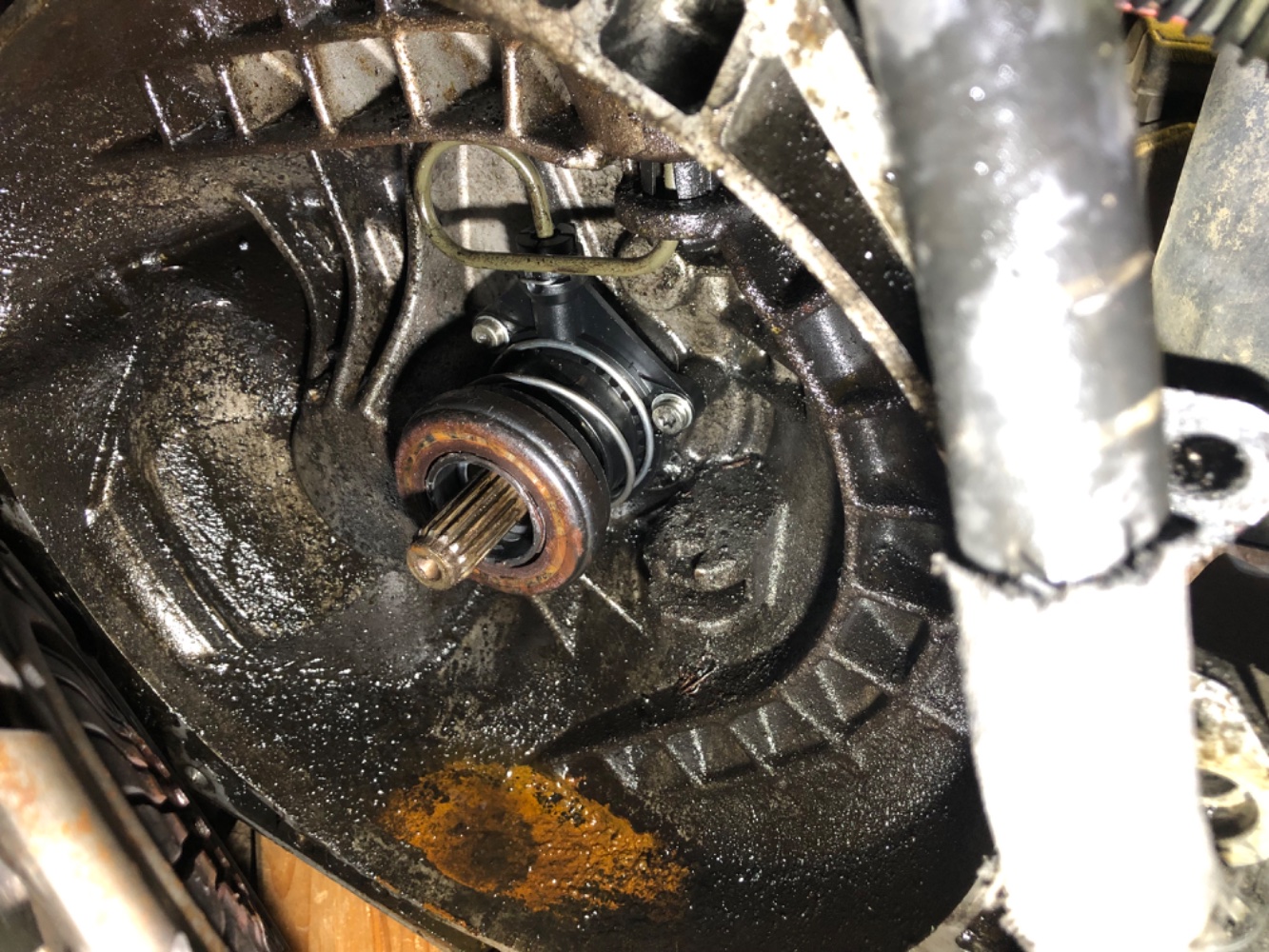

Well done. How many miles has this thing done ? That is definitely not an original slave cylinder. The orignials back then had an aluminium body, and a green plastic concertina sleeve over the spring. Check the O ring in the top, and check the body for cracks.More oddness found. The bolts holding the clutch slave look new, the concentric slave looks very good but the release bearing doesn’t
I see fluid everywhere but not sure if the stuff at the top has dripped down or been sprayed up .. so I still don’t know what needs fixing. I’ll ask a mate to help, not wanting to buy a new cylinder if it’s just an O ring..

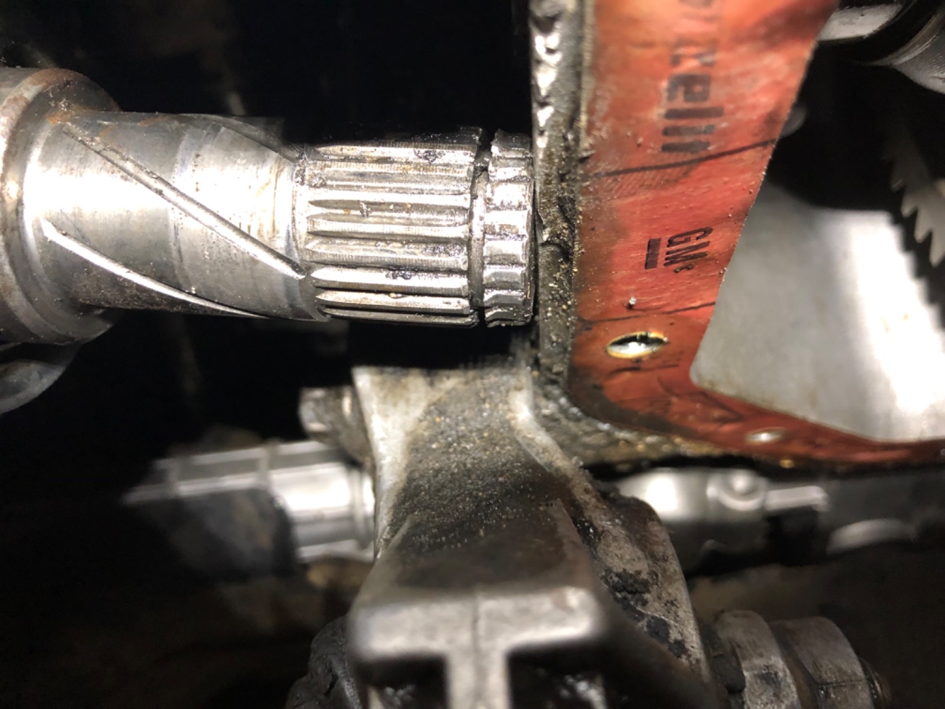

Rear of subframe dropped, box unbolted from engine and slid sideways far enough to do the work Engine is still in place and connected![]()

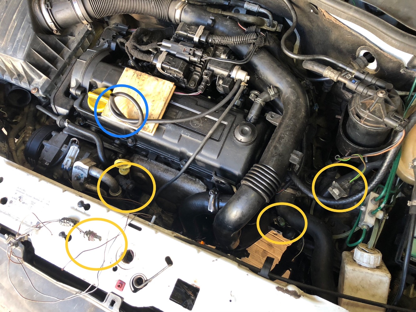

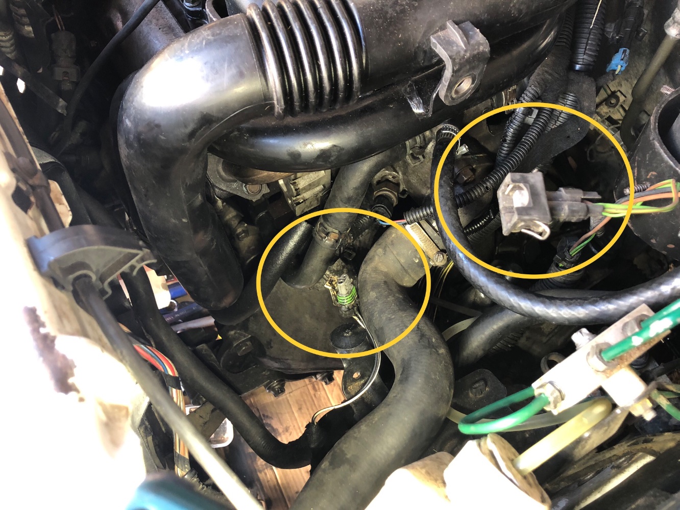

I will check in the morning, but I think you are right about the reverse light switch. Which is on the front face of the gearbox.Lower one could be the reverse light switch.
Not sure about the top one, but IIRC that's the kind of connector that was still used on temp sensors.
@m_c @Smallfry
Larger vac pipe is now connected to the EGR valve (as it should be, it might get blocked off in the future but for now..)Bit more info on solenoid pipes, one is slightly larger, that one goes to the EGR valve.
Only other one is behind the front bumper for the temp display in the cabin. That could be where the connector that has all the loose wires on the slam panel go ?
