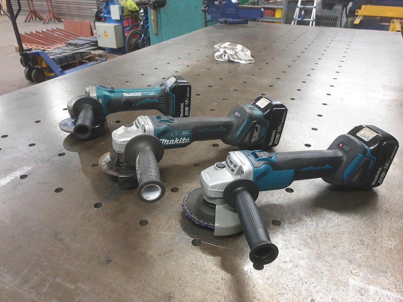

Metabo or Fein if you want a real cordless grinder. With AV handles, battery rotates etc.View attachment 343546
I'm never buying another Fakita.
The grinder has plenty power, much better than the older brushed grinders... But it's let down with stupid cheap bits.
The switch got progressively less reliable and eventually stopped working altogether, because the internal linkage was weak and couldn't actuate the electrical switch. Had to brace it with some sheet metal and epoxy. It still doesn't work reliably every time.
The spindle nut is cheap and loose on the threads. The side handle is horrible. (replaced these with old ones from a real grinder)
Worst of all, the spindle lock button is glued together. When it fails, it drops the pin into the spindle and locks it solid.
It fell apart once and I re-glued it. Fell apart a 2nd time on a job site 2 weeks ago and I wasted an hour running back to the shop to get a 2nd grinder.
I was furious with myself for being a cheapskate and I've sworn never to buy fake tools ever again. Just not worth it, not if you need them to work!
In contrast, the real Makita DGA463 has done a crazy amount of work. The lovely variable speed wheel works so well that it gets used for everything from deburring stuff to out-and-out grinding. It's incredibly rare that I break out a corded grinder - usually need a 9" if so.
I've got 6 makita 5ah batteries and all the other makita tools already though, so has my brother. It's hard to justify a change after you're that far down the hole...Metabo or Fein if you want a real cordless grinder. With AV handles, battery rotates etc.
Especially with the Fakita batteries...been bitten with those.View attachment 343546
