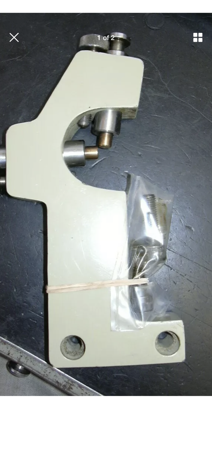

I bought a fixed steady as one didn't come with my VSL and (as you should) I let the one for my AUD go with the lathe when I sold it.
Alas despite it being claimed to be for the 5" centre height VSL it's actually a 4.5" model Boxford steady, which I only realised some months after I'd bought it.
It does work, but only over a limited range.
