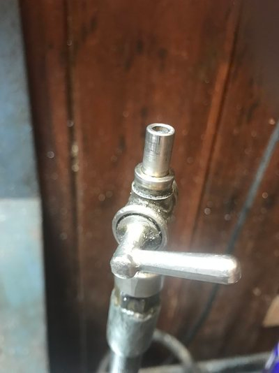

OK. Something that has a watertight swivel joint, with quick disconnect as a bonus.
Screwfix 62371 clamped solidly onto pipe
Screwfix 580KP threaded onto the 1/4" BSP thread above.
Screwfix 5763H plugged into female PCL fitting.
eBay 1/4" BSP F to 1/4" NPT F
That might work out well as you could swap the locline for a piece of rubber hose with male PCL coupler on it and shove it onto any through coolant boring bar you have.
That would do it. Now need to find a locline supplier who doesn’t slap nearly £20 on the price for postage.Plastic valve is male 1/4” NPT - how would it screw onto a 1/8” male fitting?plastic valve will screw onto the thread on the pipe
doh I read it wrong!What thread? Or more precisely, what component could you buy with a 1/4" NPT female thread in one end of it and a 5/16" or 8mm female thread in the other end?
