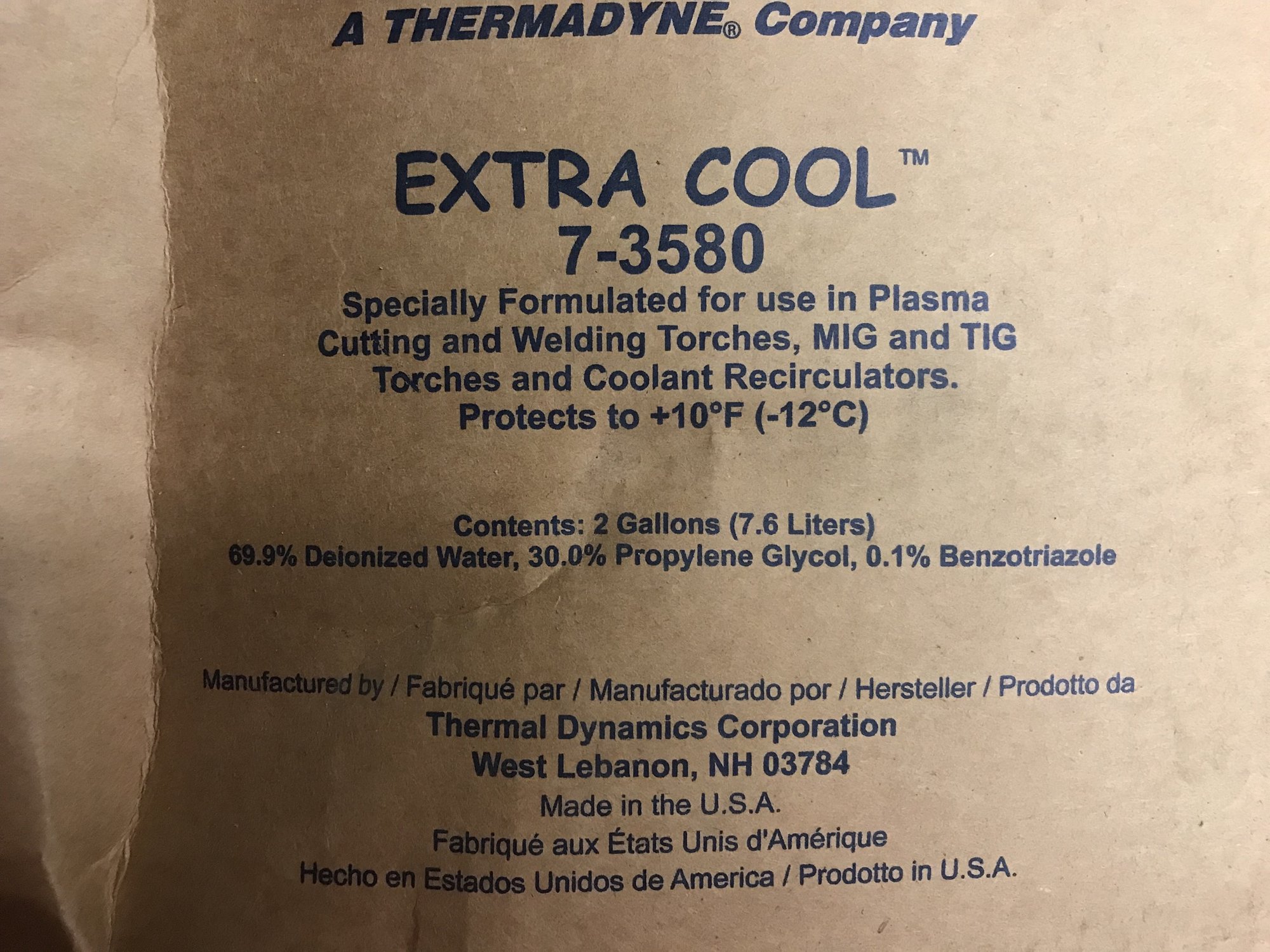

    I have a weldcraft cooler and the specified coolant in that is mostly Propylene glycol. Not sure if the exact % but can check next week
    chris pruteanu likes this.

  16. carbon
    carbon Member
    Messages:
    990
    Location:
    S. Glos. U.K
    Sorry it’s taken a while, a picture of the contents
    chris pruteanu and Wallace like this.
