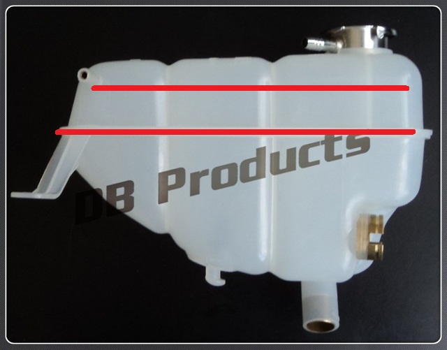

I would plastic weld it if I 'had too' but I think I would make a new ally one or at least look for ready made versions

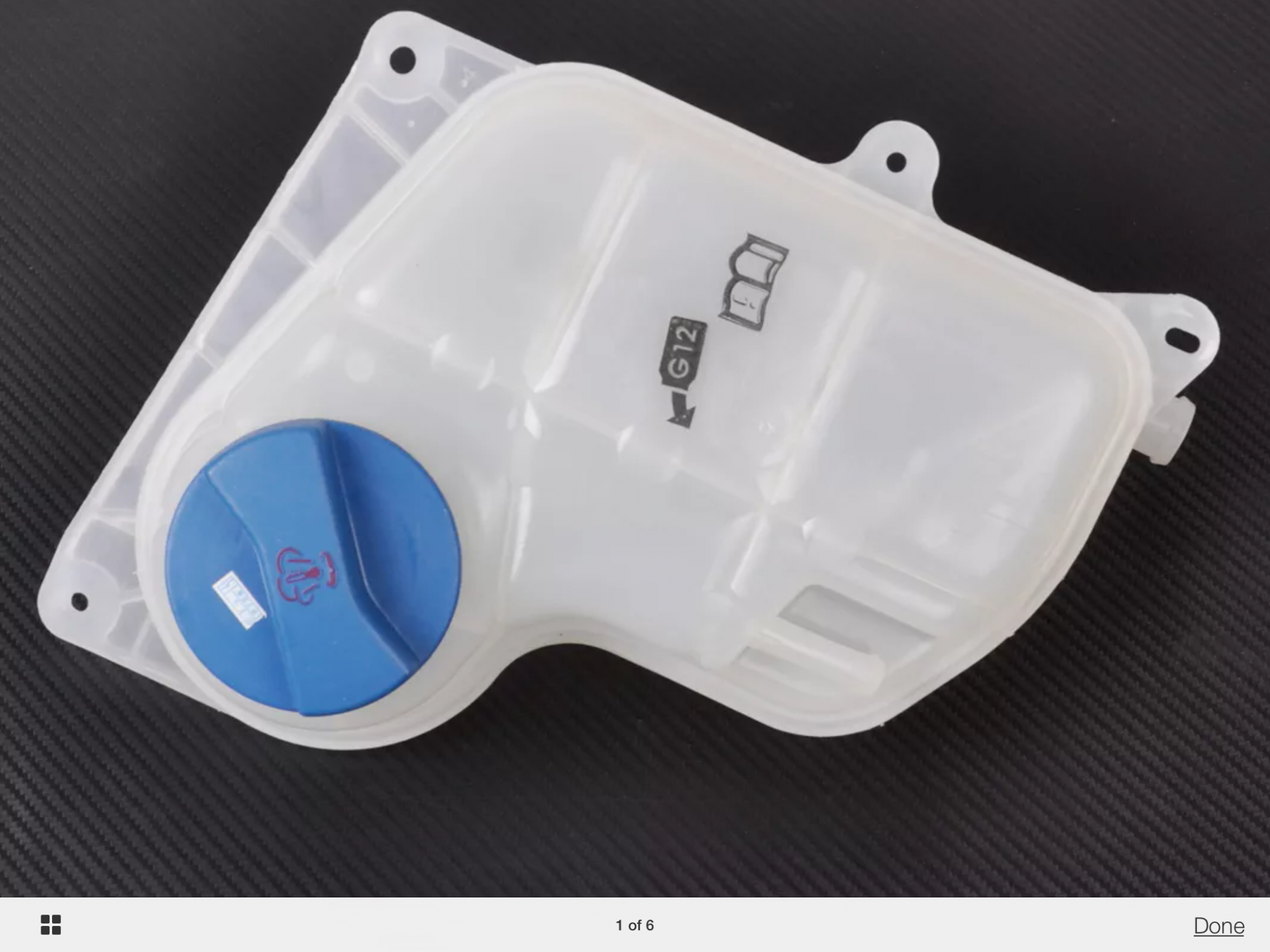

Looks like the one on my A4 (B5) if you need any measurements let me know.Interesting! I have found an Audi tank that is a possible, just need to find one to offer up...
Recreating a previous special faithfully makes more sense. Like you say taking liberties to avoid painting yourself into a corner is sensible though, especially as they probably only used that header tank 'cause it was cheap and common at the timeFair comment. The reason for that particular tank is that I am trying to keep as close as realistically possible to the Middlebridge design. The GTC was the Middlebridge that just missed being produced before they went out of business. I want this one to be "that" car. However, being sensible, I have to try to use available parts rather than track down a one off that I then need to replace in the future, with the same sourcing problems.
I have been looking for a new replacement that will fit, but drawn a blank so far of something with the ports in the right place and that will fit the space. If I had acces to a dozen possibles, life would be easier, but I am having to go by pictures and descriptions.

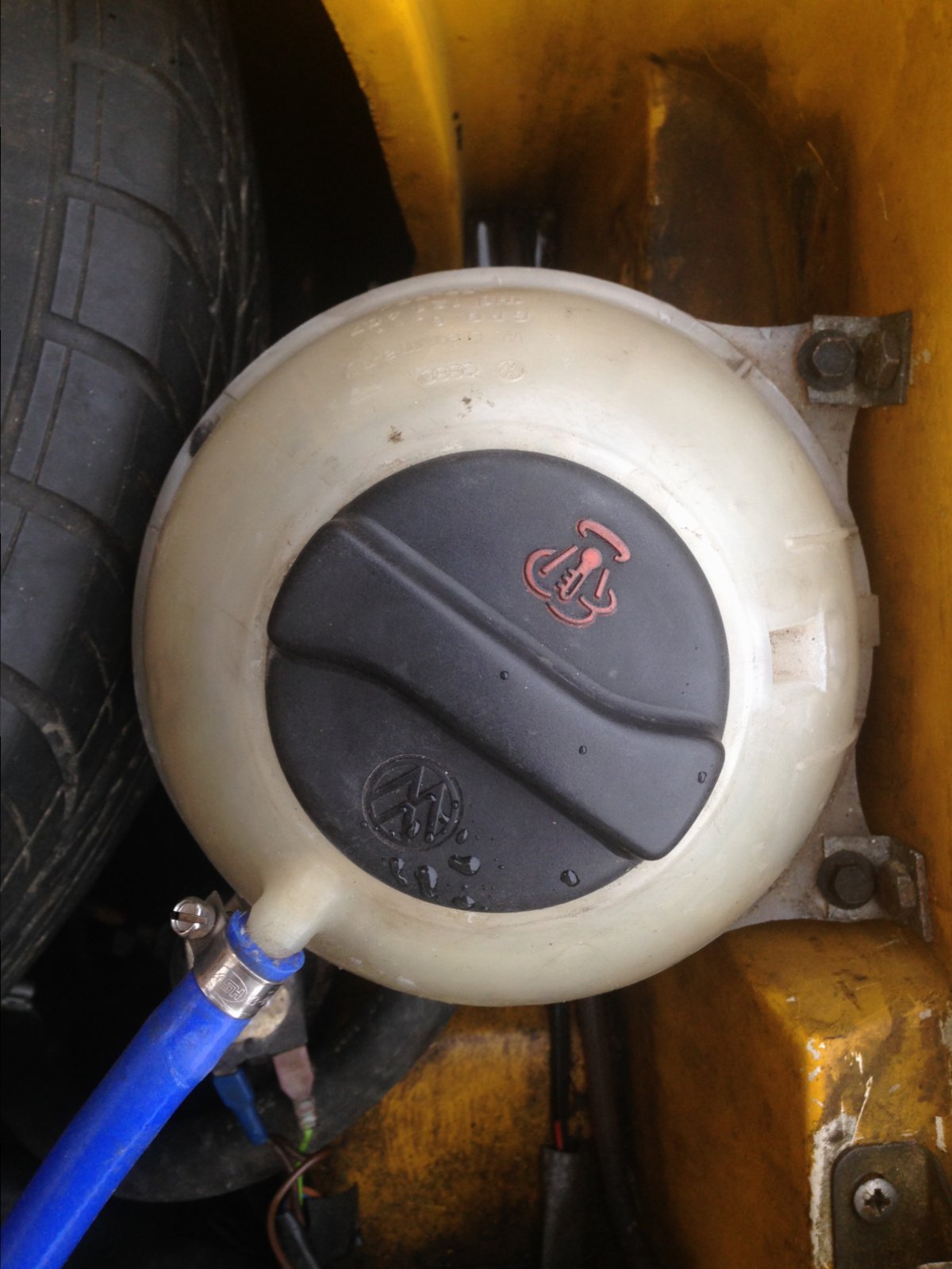

A query... I assume that the capacity is important? With a 2.9i engine and big radiator, there will be a fair expansion, maybe I could see what it blows out and use that new level? There is a VW? globe design tank that I could use a bit closer to the front, but it isn't very big.
