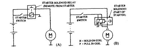

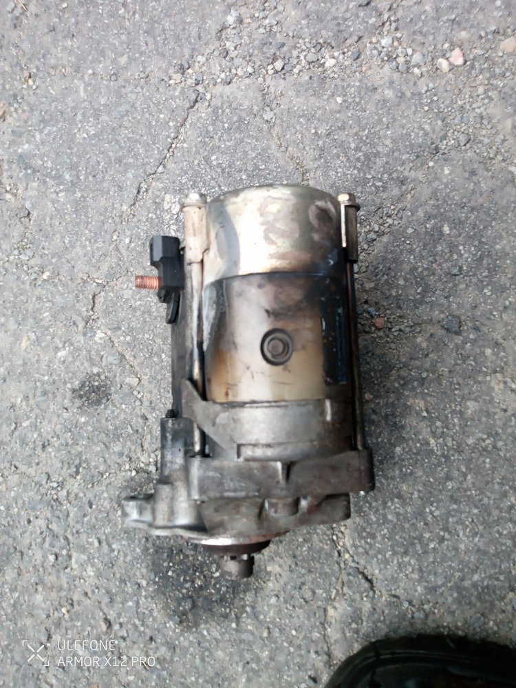

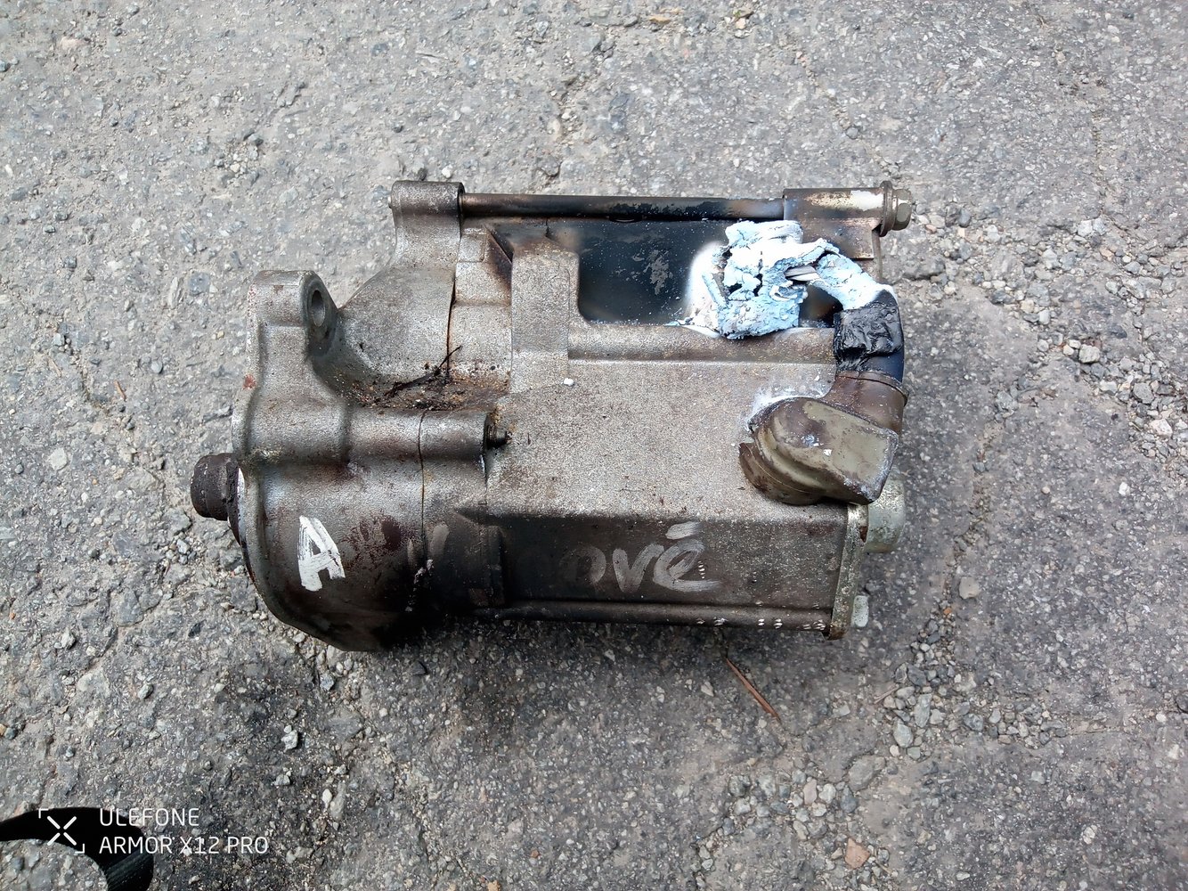

So, yes, once again good point, but this winter just gone, I rewired all three similar boats, to cure stupid starting issues, due to had contacts, and undersized cabling.Also bear in mind how starter motor solenoids work, there are actually two sets of windings - pull-in & hold-in. Pull-in takes the most current and has a larger coil, physically & electrically. It is wired from term. 50 to the output stud (so that it has zero current draw once the contacts are closed). the hold-in coil is wired from term. 50 to ground, and will obviously be drawing a lesser current whilst the starter is engaged.
It's not beyond the bounds of possibility that loose or corroded terminals on the solenoid cap battery & motor contacts (or indeed inside the solenoid cap) can cause volt drop and cause the pull-in coil to still be active albeit at 1-2VDC whilst cranking, but passing a much higher current than intended. Typically, this will show itself as a warm/hot starter solenoid after a few cranking attempts.
