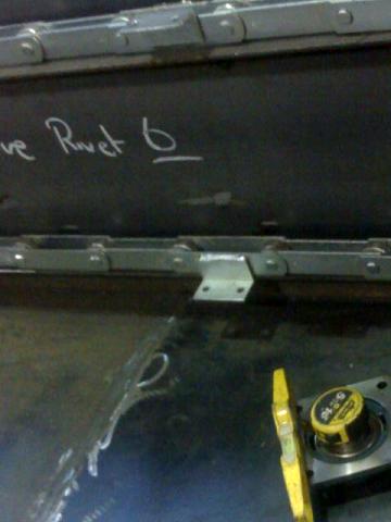

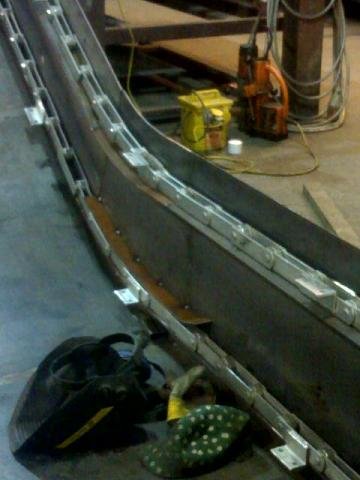

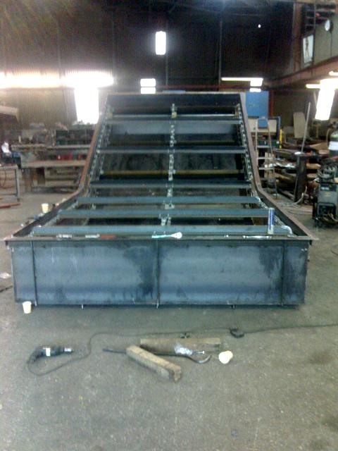

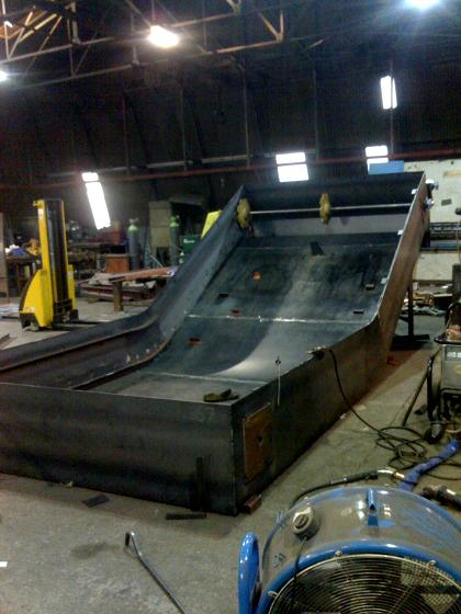

Working on this little project at the moment.
Designing as i'm going, no plans, just a guidline size.
The tank fills up with ash from an incinerator, then the chains and paddles drag it up the incline and out the spout into a tiping skip.
Bit of a WIP in these pics...
Tank from 5mm, all sheared edges for outside corner joints. Fully welded in and out.
Tracking from 50x75 angles, stitched on.
