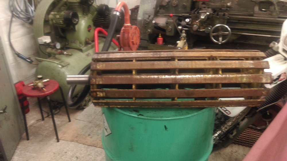

How about one of these, designed for the job and not complicated and you can run up a plank into a truck or skip.
I have repaired one tonight as it happens! The bearing had collapsed and chewed the shaft in half, welded the end on and built up with weld, and a bit of lathe workThe other way is to use a bottom roller drum made of strips so that there are holes in between that allows the soil to drop through and have air blasting through the centre to blast it out a little like this, but more open and with with open hubs that are also formed by strips, some potato conveyor are like that

You can get drive rollers that ARE the motor but instead of the shaft turning the body does, ie the roller, you actually fix the shaft solid.I guess getting one to drive the shaft with the drive drum on is the difficult bit??
