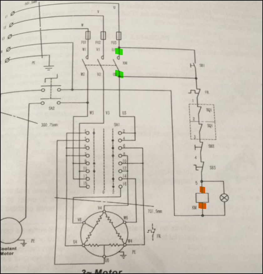

The safetys are all outside that box so ignore them. The only relay terminals you need to identify are the coil terminals (orange) and any pair of switch contacts (green).
The greens are easy - just follow the wires either side of the ON button. The oranges you'll have to figure out.
