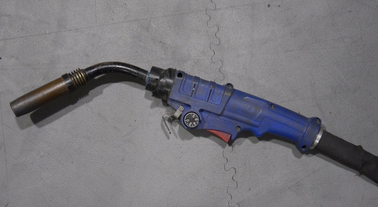

Think the problem with the spool gun is the EWM won't work in pulse mode with it.Spoolgun has got to be the solution to that kind of problem? Will the ewm work with a seperate feeder? In otherwords can you pull the cv welding output from the + and - dinse connectors reserved for mma/lift tig?
Sell it and buy a miller xmt350p and a cobramaticThink the problem with the spool gun is the EWM won't work in pulse mode with it.
best of both worlds, power source doesn't care what feeder it's driving...Aye probably the best option but not happening for me until I see how things pan out with both the direction the Industry takes in the next year or so and whether my health laststo get 15m I think your biting the bullet mate. Super snake is a ship building driven torch adapter. and comes in around the £1500 mark. A lot of cash yes but if it’s the tool for the job it’s the tool for the job.
Reckon I would be cheaper just buying an EWM Push/PullSell it and buy a miller xmt350p and a cobramaticbest of both worlds, power source doesn't care what feeder it's driving...
I suppose the answer to that would have been to buy a Phoenix with a separate wire feed instead of the compact.It seems totally mad that the phoenix won't run it's full pulse programs when it's driving a spoolgun, surely they can't have designed it like that? What about the applications where you're working down inside a crawl space that's 15m away from the power source? Remote pendant and a spool gun would solve that problem.
I was totally unaware they made it with a seperate feeder, that explains it all...I suppose the answer to that would have been to buy a Phoenix with a separate wire feed instead of the compact.
Probably for the same reasons I don't want to splash out on an 8m Push Pull, ie I am skint and not sure how long my knees are going to lastWhy not trade in your Phoenix compact and buy a Phoenix with a separate feeder unit? I can supply one with an uprated pump that can cope with a 30 metre interconnection hose package that can be extended can be extended a further 15 metres with an EWM MiniDrive that you could then run your 6 metre or a conventional 3-4 metre gun.
Not sure if it was an option on the Phoenix 330 but there were others in the Phoenix range that were separates.I was totally unaware they made it with a seperate feeder, that explains it all...
