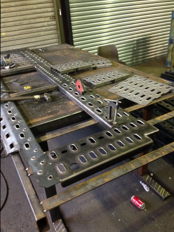

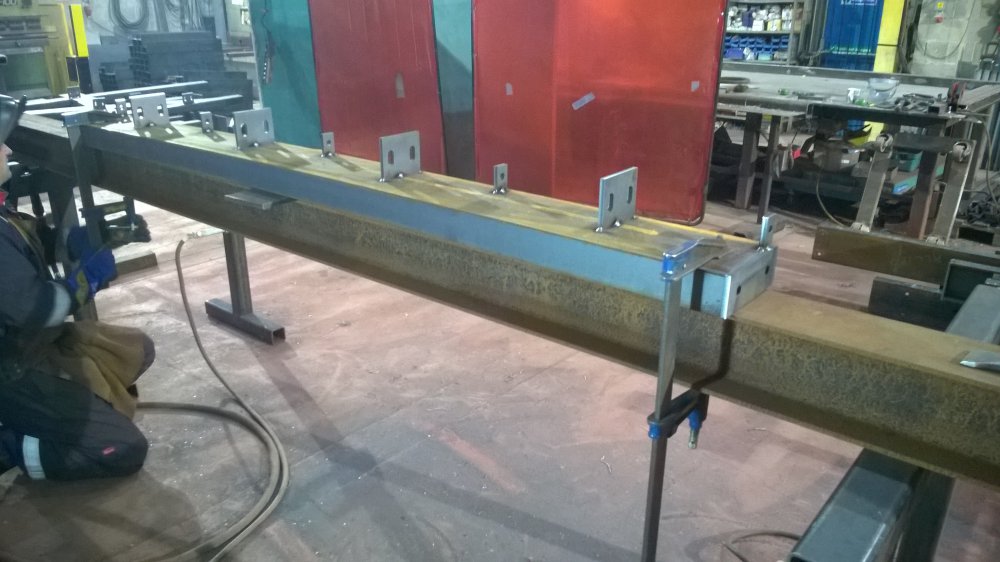

This is a part for a car transporter, common design this particular one goes on one of the biggest manufacturers of transporters in the UK
Flame straightening on hull plates is no great black art I recon most who do it just do what they were shown without ever thinking about the why it workedHow do you ensure the tags remain at 90 to the beam?

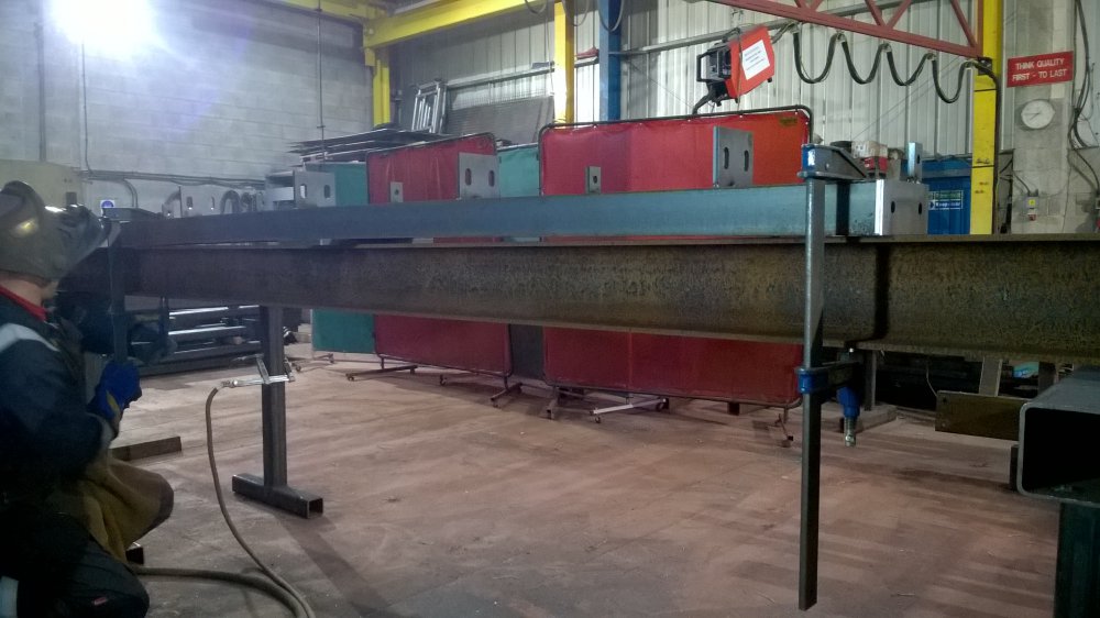

O/T, but how much penetration do you get into the channel on a job like this Welder Paul?

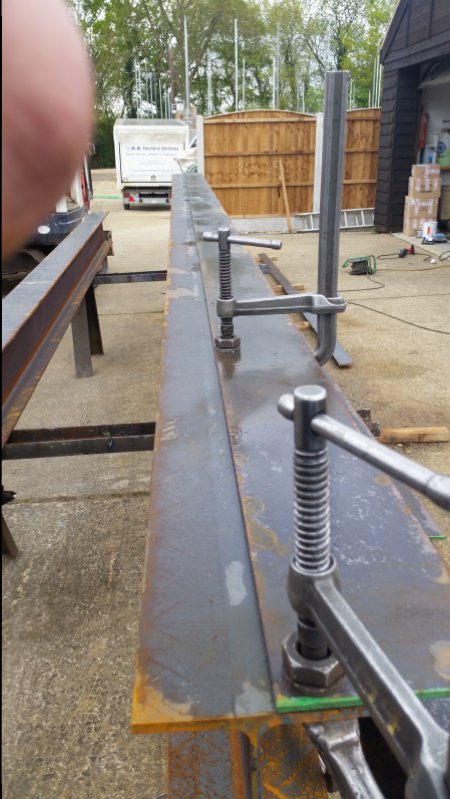

Good information there Paul. What make are the clamps in the picture. Cheers.josh.

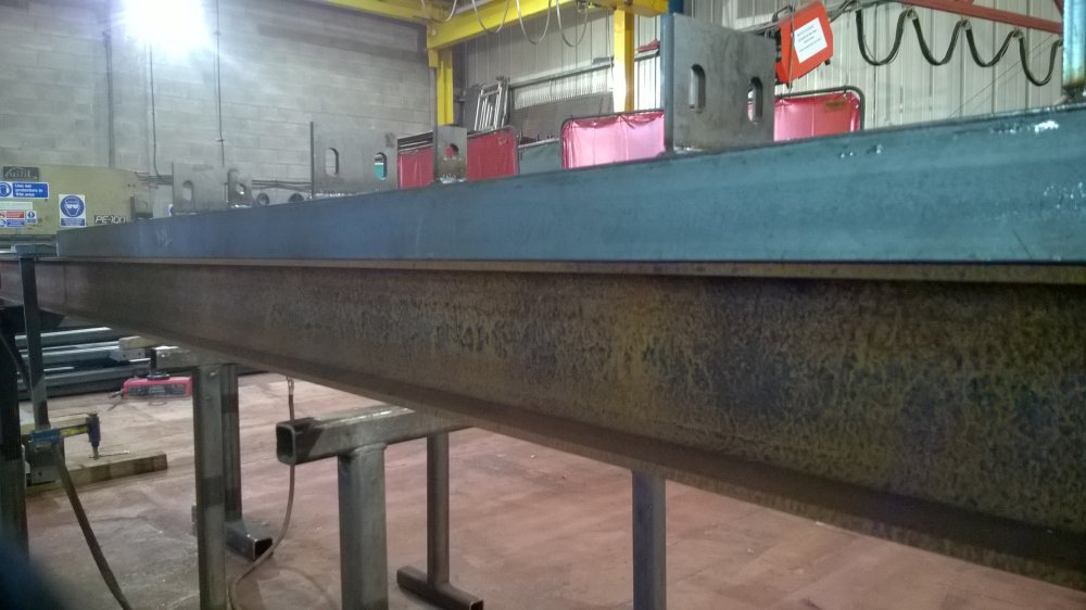

if you find by trial and error that 25mm packing obtain s flat result thats good.
If you did the same job without the packing would you see 25mm of bow or something less?
I think something less is probably the answer ?

We work to certain company standard welding procedures which have been carried out on test pieces using the same grade and thickness (or thicker) steel, same gas, same wire and in the same welding position, then destructively tested. This means we know, using those parameters, that the weld will function correctly.
Welds are visually inspected and that's about it for a job like that.
We UT test a certain percentage of jobs over 25mm thickness.
All welders at our place are BS9606 'coded', so with that in place, the welds should be right.

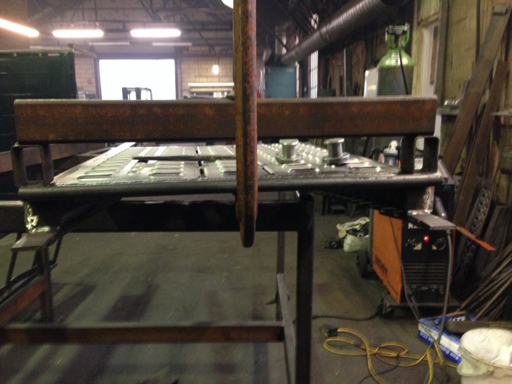

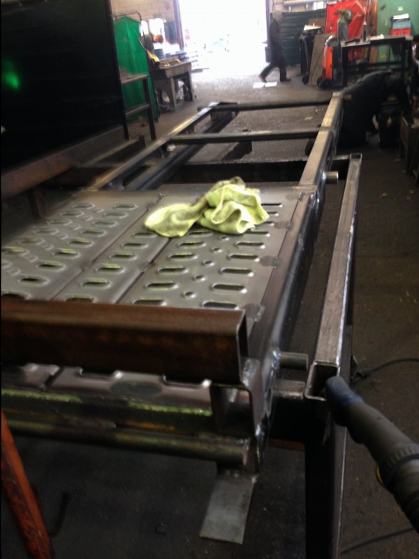

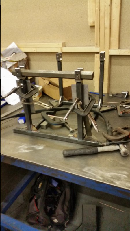

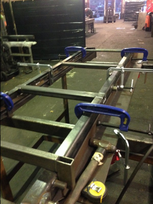

Paul, not steel, 200x75x6 al/al channel section, which were installed inside Trident subs, very tight tolerance.
Rectangle frames, done same as steel, made up in L's, before putting them together. Offset prior to tig welding, allow to cool, if crept under 90*, then onto a stake to planish wed, till 90* was achieved. then put L's together, same again if diagonal were out. that was one PITA job I will never forget!
