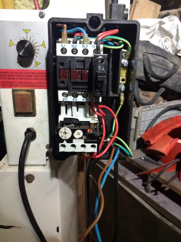

That smashed up contactor unit that i mentioned the other day..
It needs replacing, but, before i spend money, i want to see the machine running, so i need to re-wire the unit.
Normally i take photos when i take things apart, but this time i was in a rush, and, of course, ive forgotten.

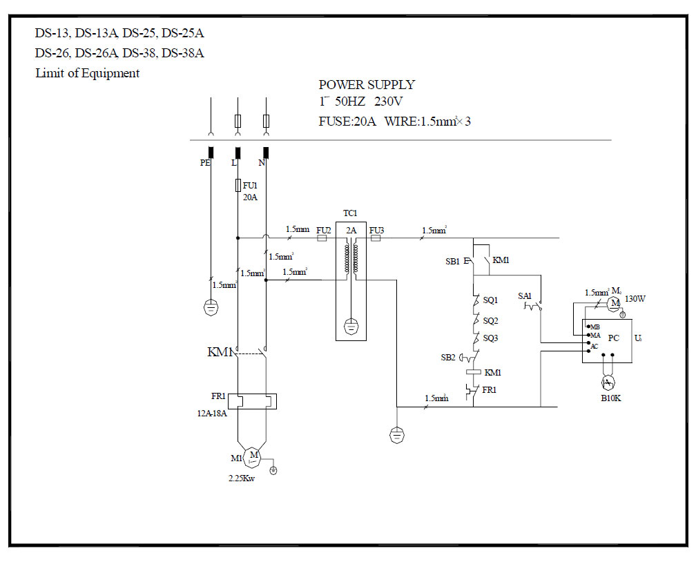

This is the circuit diagram -
I need to reconnect the 2.25kw motor.

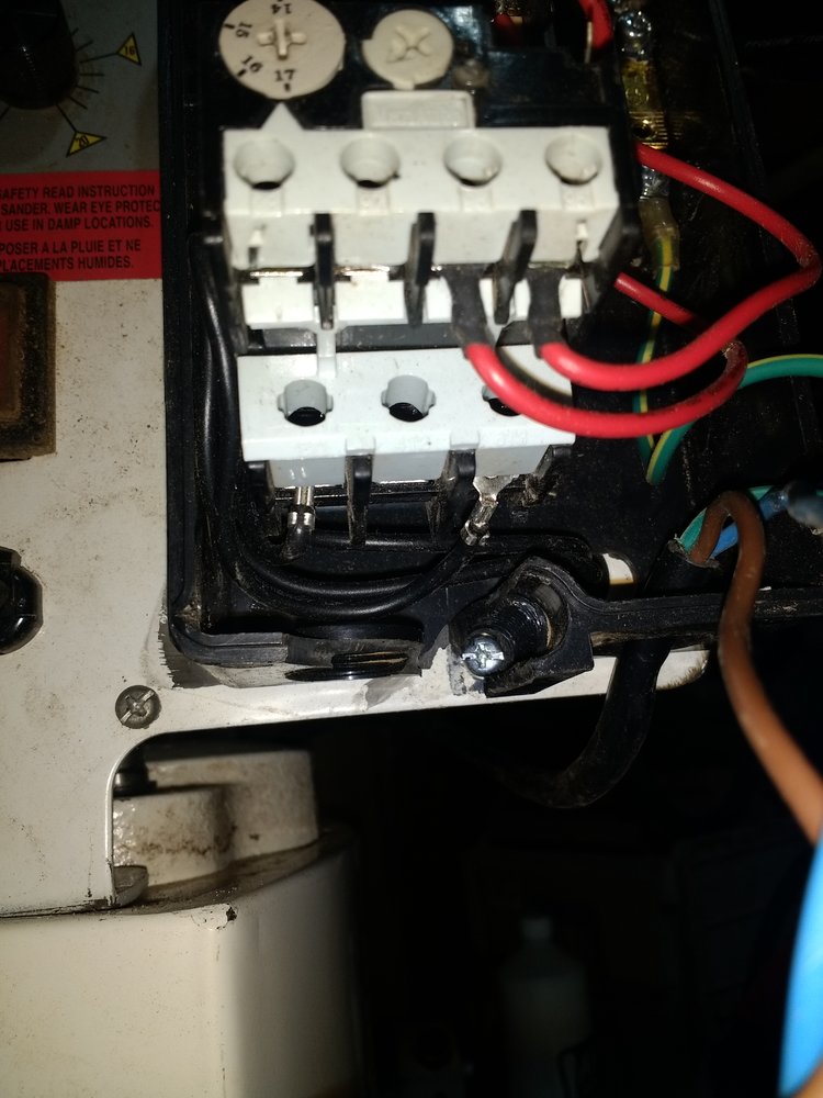

The wires from it are the loose blue and brown in this photo -
I have no idea where they should go at all!

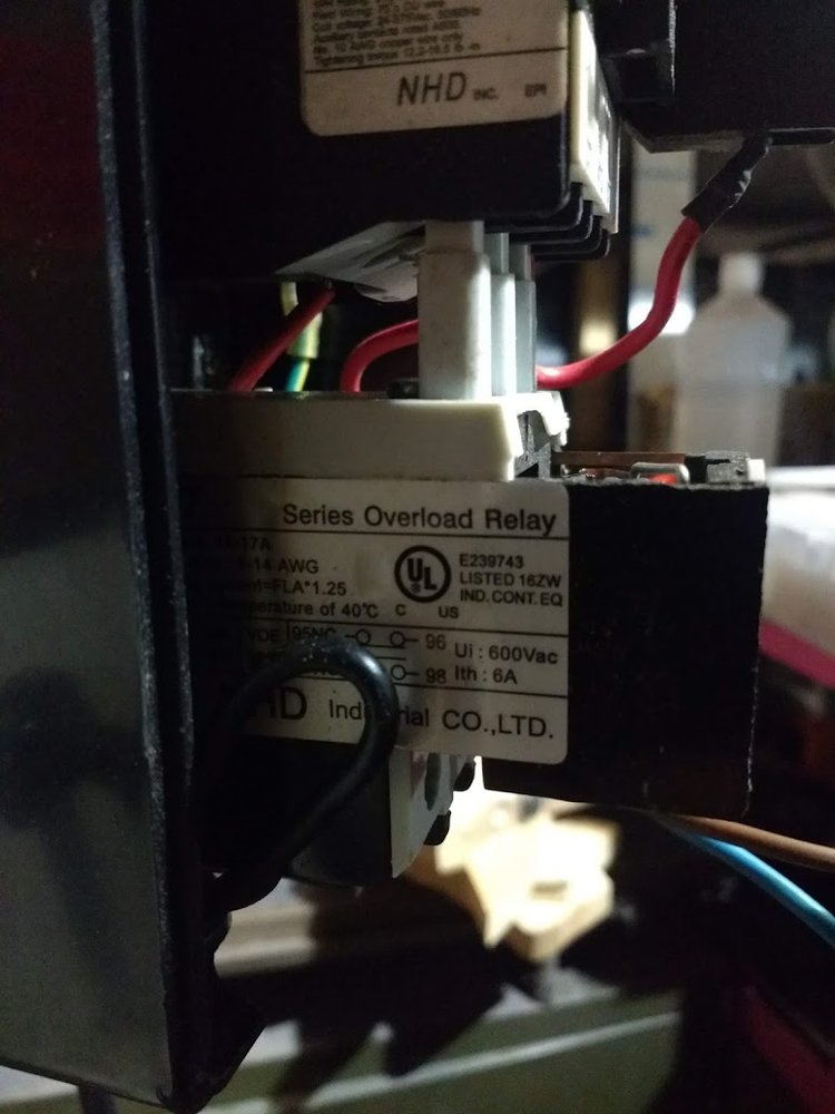

This is the side of the lower unit -
So far as i can tell, thats just an overload for the conveyor belt, and nothing to do with the main motor?

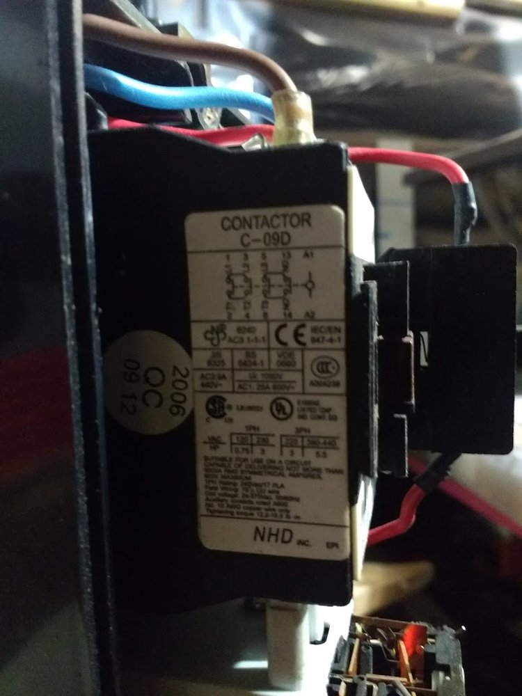

This is the photo of the side of the upper contactor -
Im really hoping this is just obvious to someone here!
