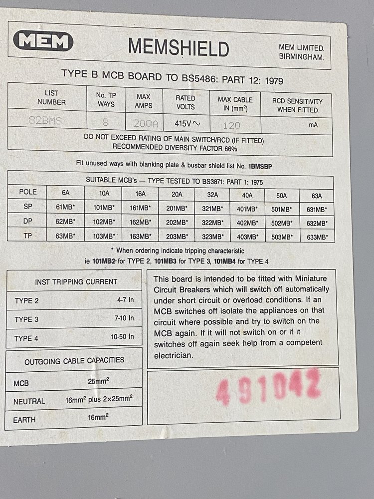

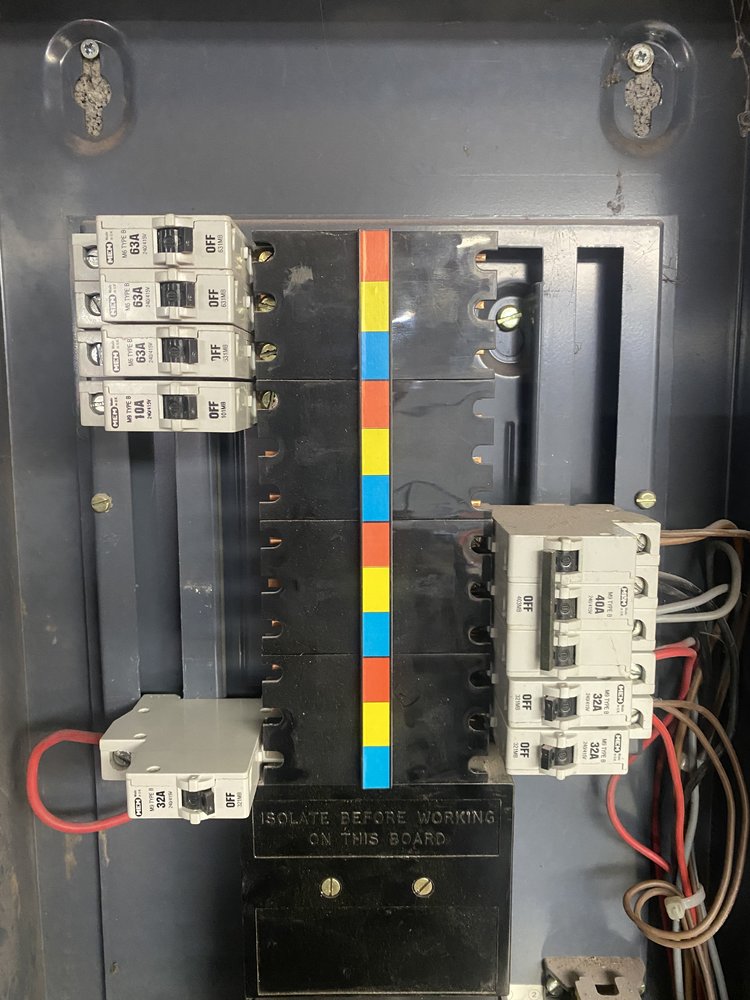

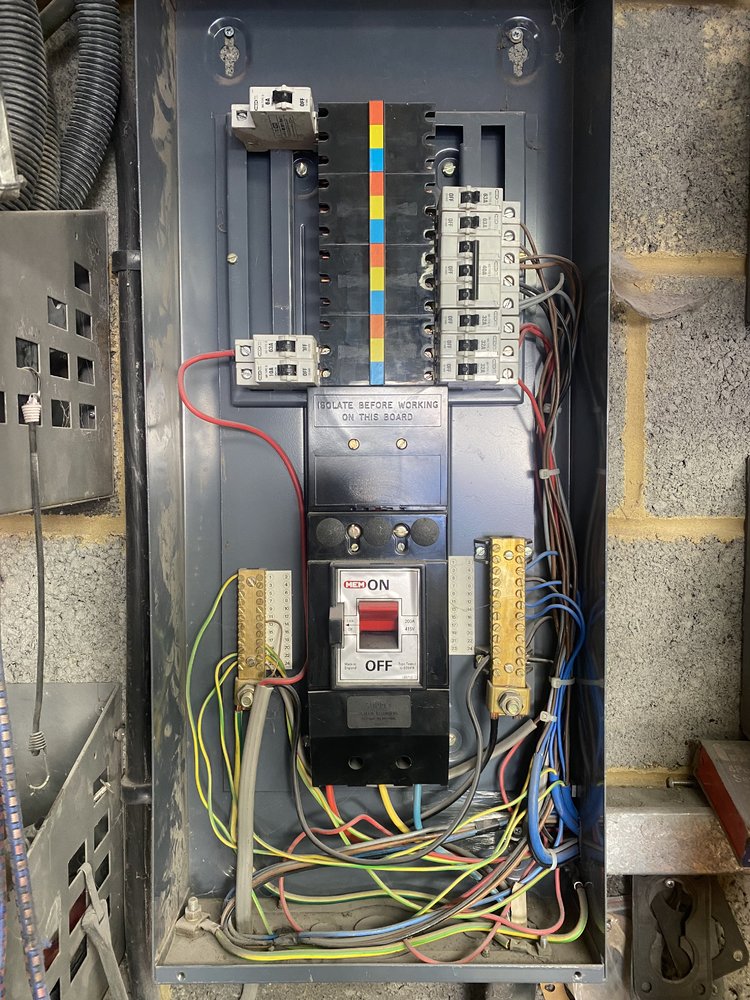

As you can see, if I am keeping this DB, I could do with some blanks.

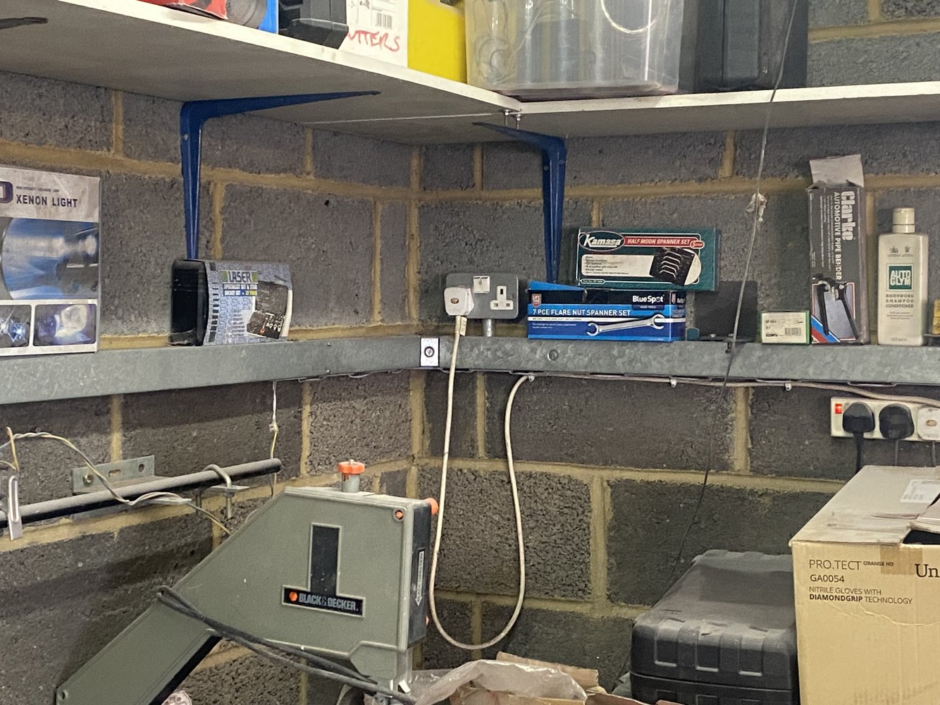

For sockets, I would still tend to group an area on the same phase for logic if nothing else, unless there was a compelling reason to do otherwise such as load balancing. I'd still label it as well.

I always believed in any domestic situation you never combined phases in any one dwelling and you kept separated as much as you could phases in commercial/industrials properties and you labeled the heck out of such sockets and switches if phases were combined in any one, ( touching ), area.
