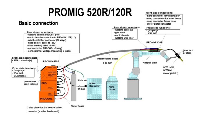

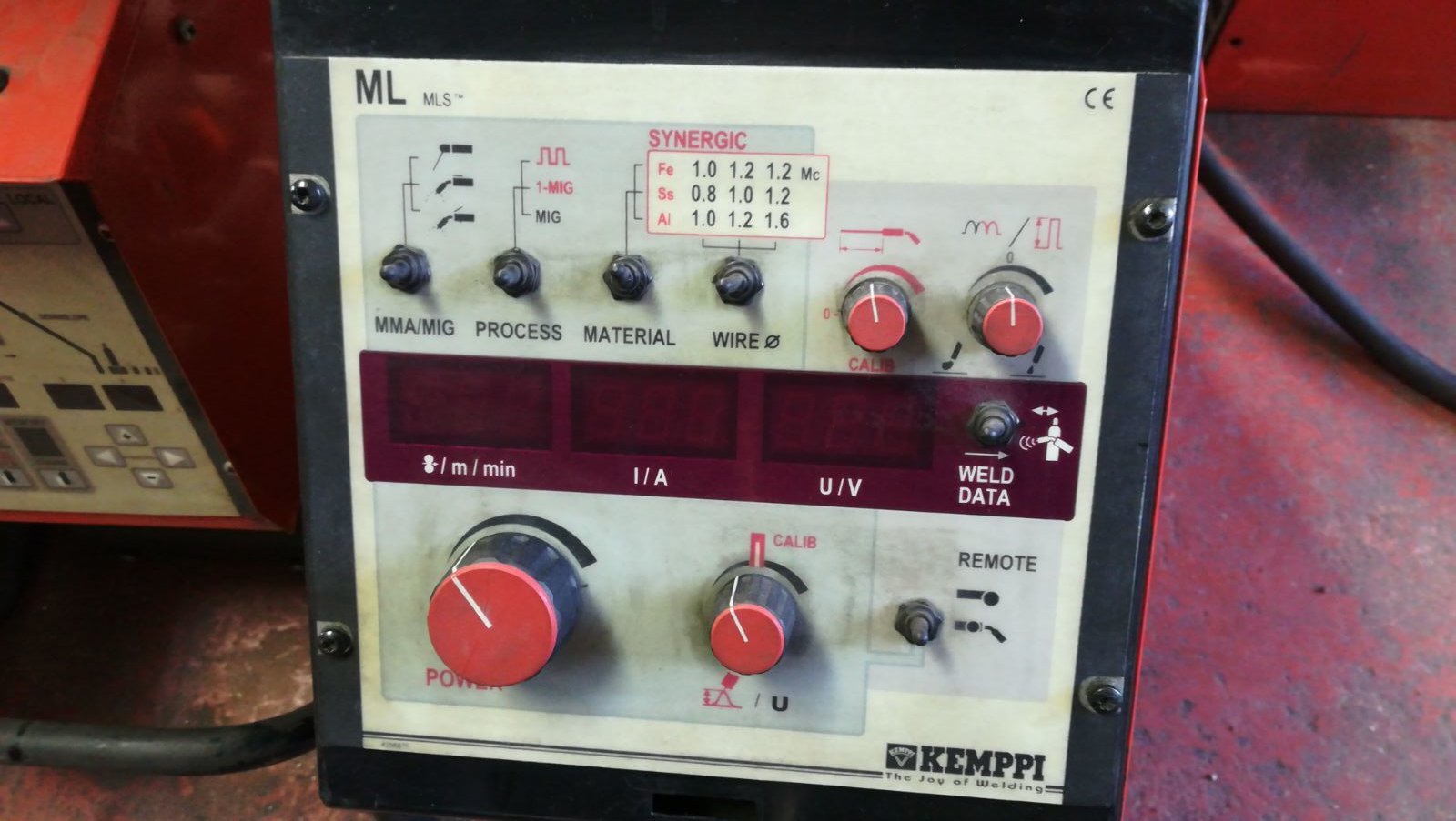

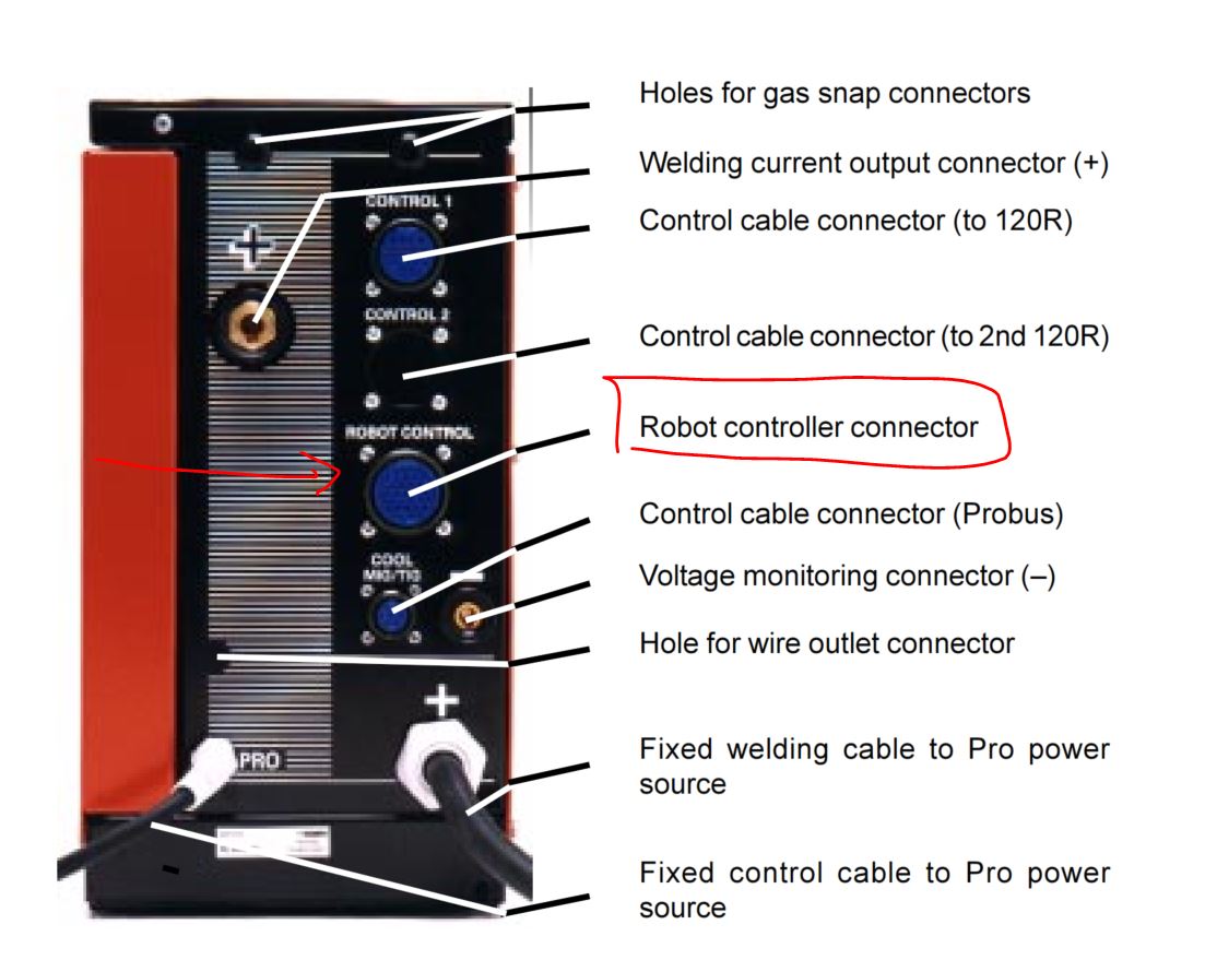

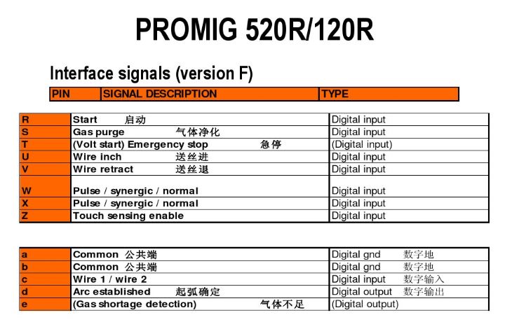

I have old KEMPPI ProMIG 520R with analogue robotic interface and I would like to connect it with a robot controller, but I don't pin schematics for this connector. Attached picture.
Maybe somebody can provide robot control connector pin schematics?
Thank you very much.

I have put a request up on a robot forum I use to see if they have anything.
